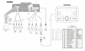

I bought a used 2016 242 SE and of course some problems I'm trying to fix. Major one is the stereo system! Previous owner had from the looks of it a major upgrade, but then decided to remove much of it at some time. I'm just trying to get back to a six speaker system. 2 speakers in bow, 2 in cabin, 2 at the swim deck. All are Wetsounds Revo Speakers. And also some small factory tweeters overhead in the rack. I still have the Polk Audio model PA4A stereo that was stock with the boat. Here's my problem: That system has 4 sets of wires coming out of it for speakers. One question is, are those outputs amped? I was told they were. Then there are 2 more sets of RCA wires, and I have RCA wire going toward the front of the boat, starboard side under the steering console. I was told the RCA were not amped or powered. Second question: If they're not amped was there a factory amp somewhere toward the front, to power maybe the front speakers?
