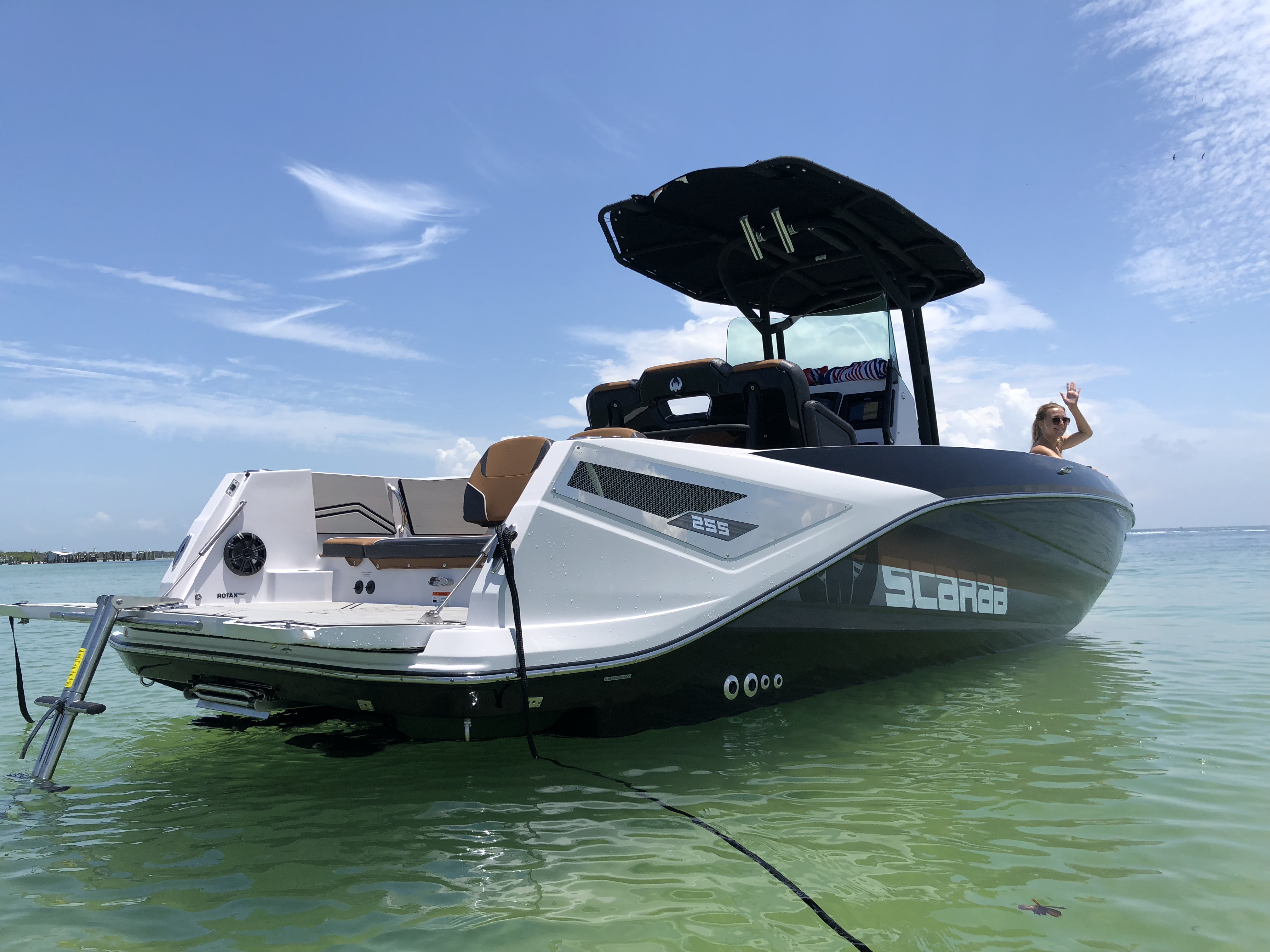

During a week with a bunch of friends, going out on the new 255 Open each day, we were running about 30-35mph, I feel a sudden slow down, but water is smooth and clear I know I didn't hit anything, I see the port motor rpm's about 2500 less than starboard, I move the throttle back and forth thinking maybe grass was in the intake and it just got slower and slower than the engine just stopped. And wouldn't start again.
About 8 miles from home I limped home on one engine about 8mph which is all she was able go with 5 people on the boat without cavitating...
Dealer picked up the boat and told me today that the engine dropped a valve and they were submitting a warranty claim with BRP.
any thoughts or suggestions? anyone experience anything like this? any idea the time the boat will be down?
I am 100% satisfied with the boat, everything has been great, and I have to believe this is just a bit of bad luck... right?

Yeah that sounds like a bad luck break they are usually good motors. Man those things are just sharp looking a bet people comment about it at the ramp or dock all the time.

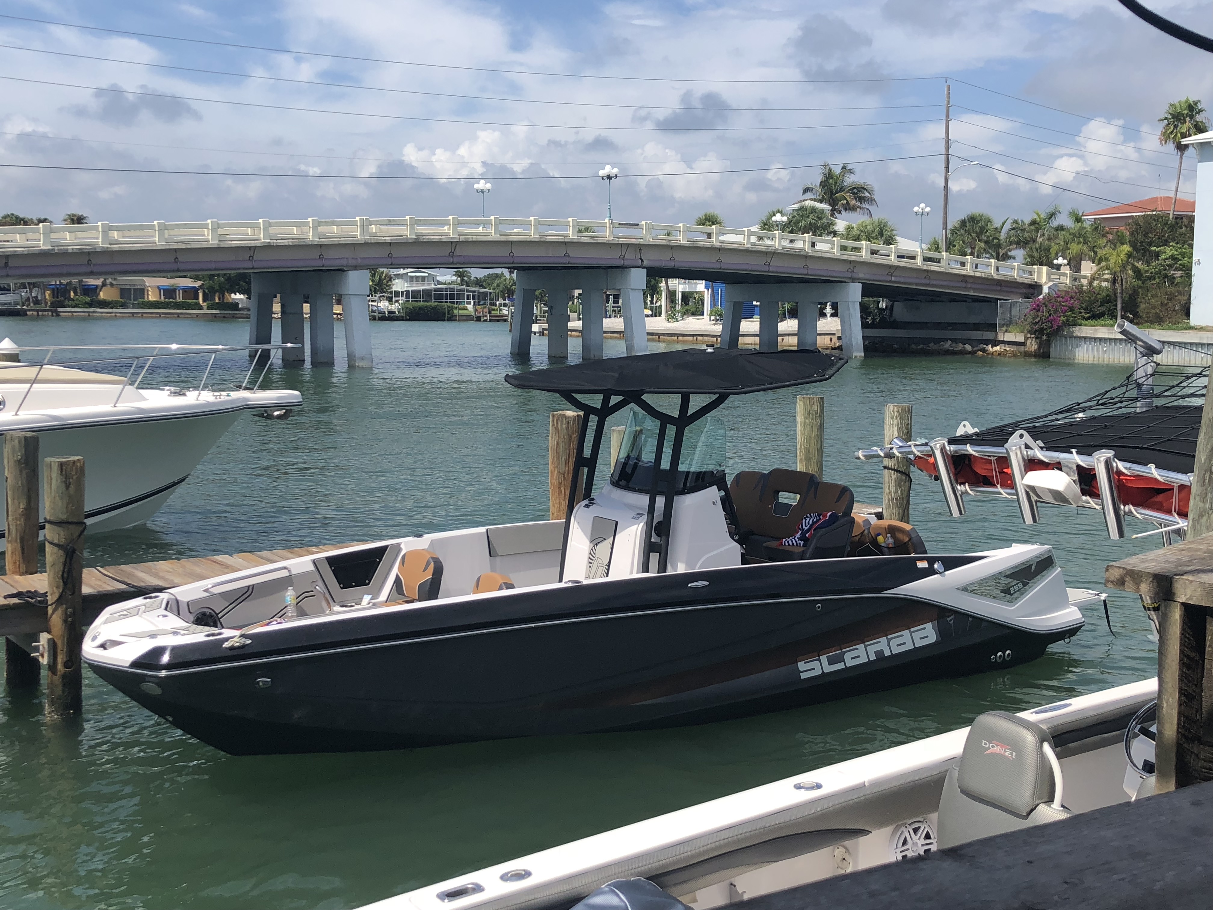

Great news, my dealer called today and the new engine is not already delivered it is installed, all within a week. They did a water test today and delivering it tomorrow!
Thanks to SkyPowerSports in Port Richey FL... First Class Service!
-Tim
(I will update this weekend on performance and quality)
