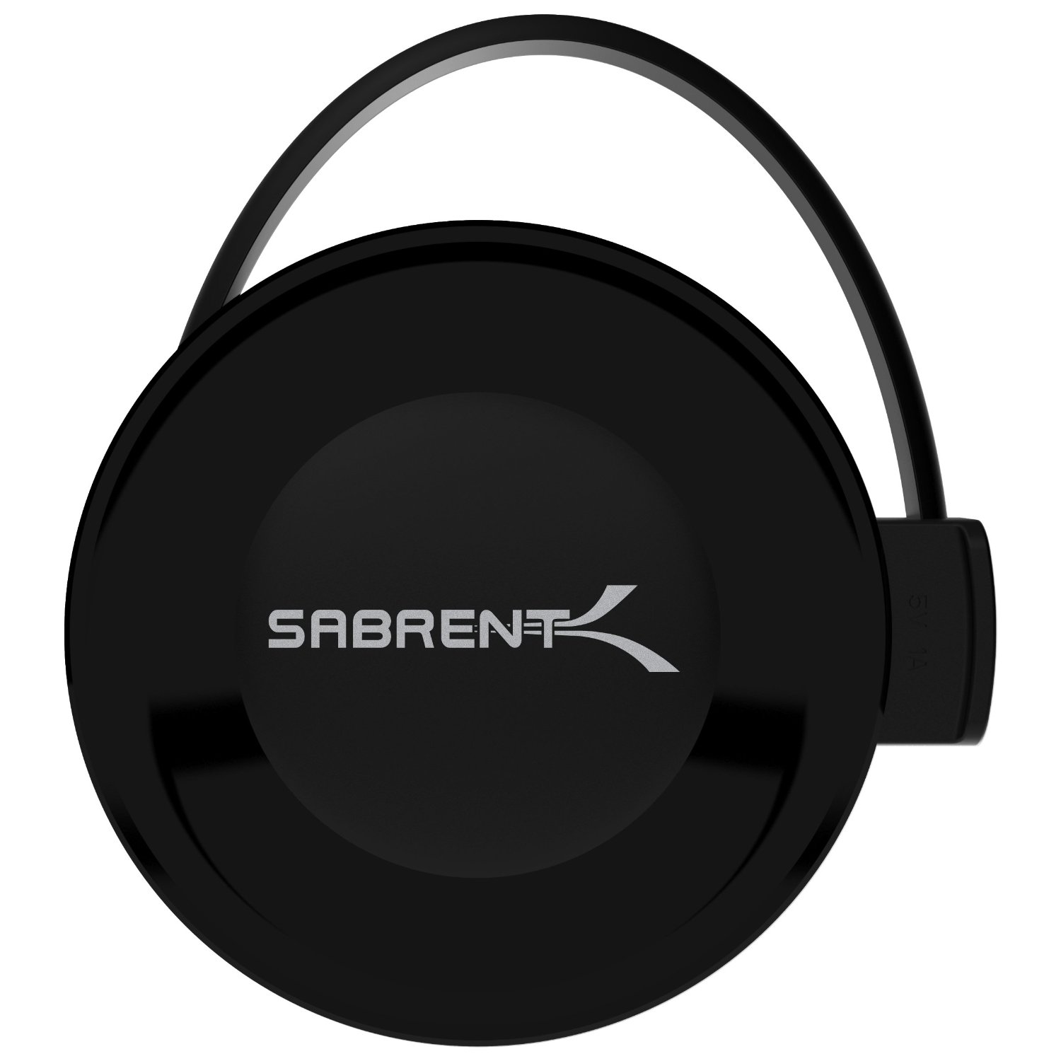

Here is a great little device to add Apple AirPlay to your boat.
http://www.sabrent.com/category/audio/WF-RADU/
I prefer AirPlay over Bluetooth because it uses loss-less compression (better quality), we can also have multiple devices connected at the same time.
Device

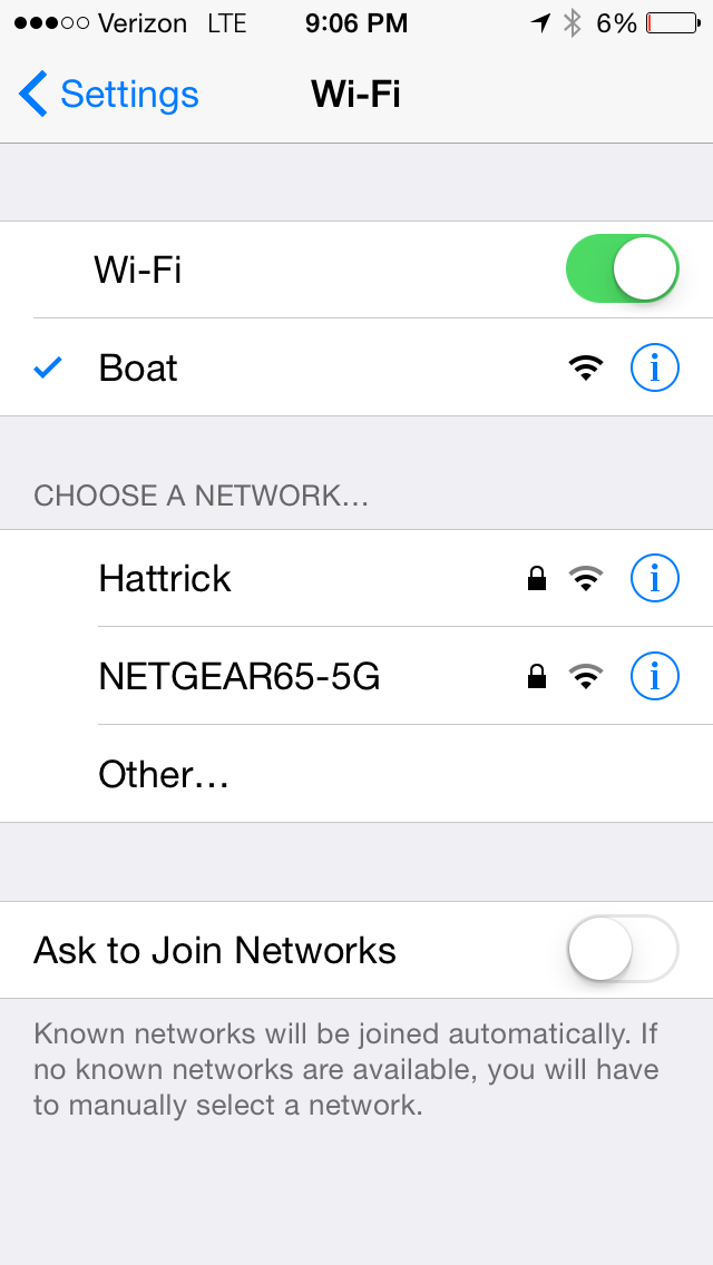

Connect to Boat Wifi

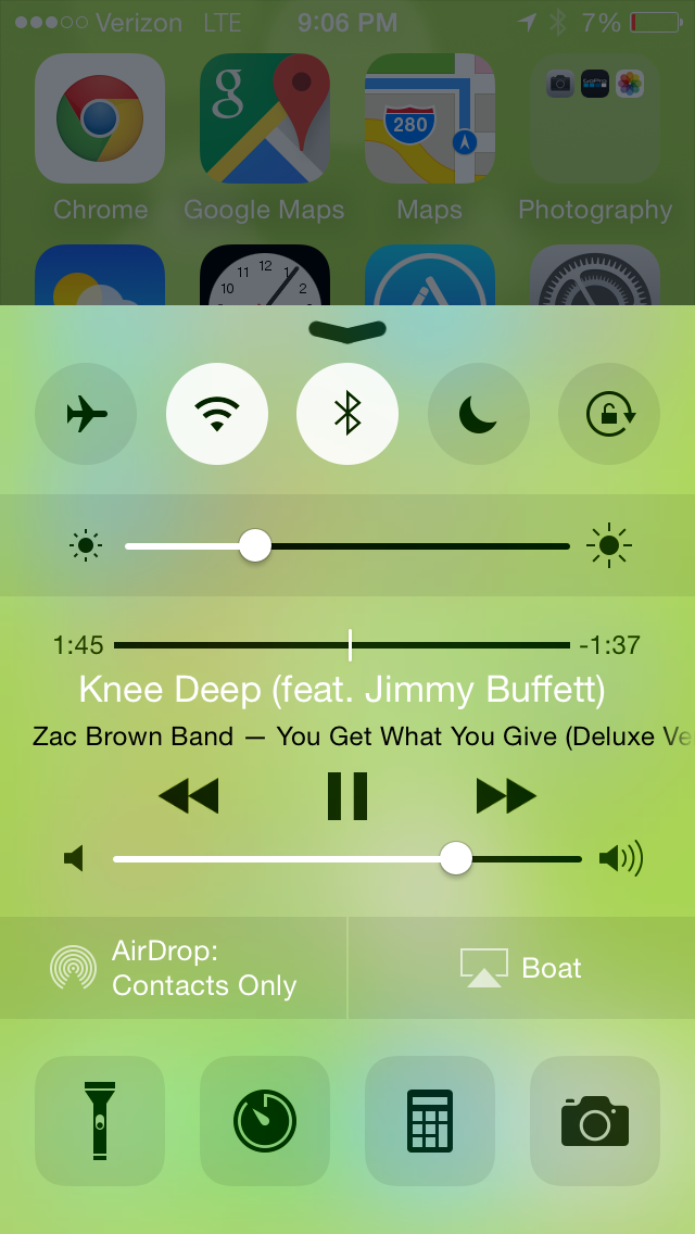

Choose AirPlay to Boat
Working

If I connect to the AirPlay wifi network can I still stream music from Pandora or something like that?
Yes, the first time you connect to the WiFi network you enter your IP and Subnet mask in the Static tab and from then on your good. I use Spotify for music, video of the simple process attached.
Is the Sabrent AirPlay the AP for your Boat WiFi?
Will it also participate in an existing wireless network?
Yes the Sabrent is the AP it is the WiFi Network on the boat (there are no other networking devices), I changed name from Sabrent to Boat, the Sabrent will also interface with existing WiFi networks.

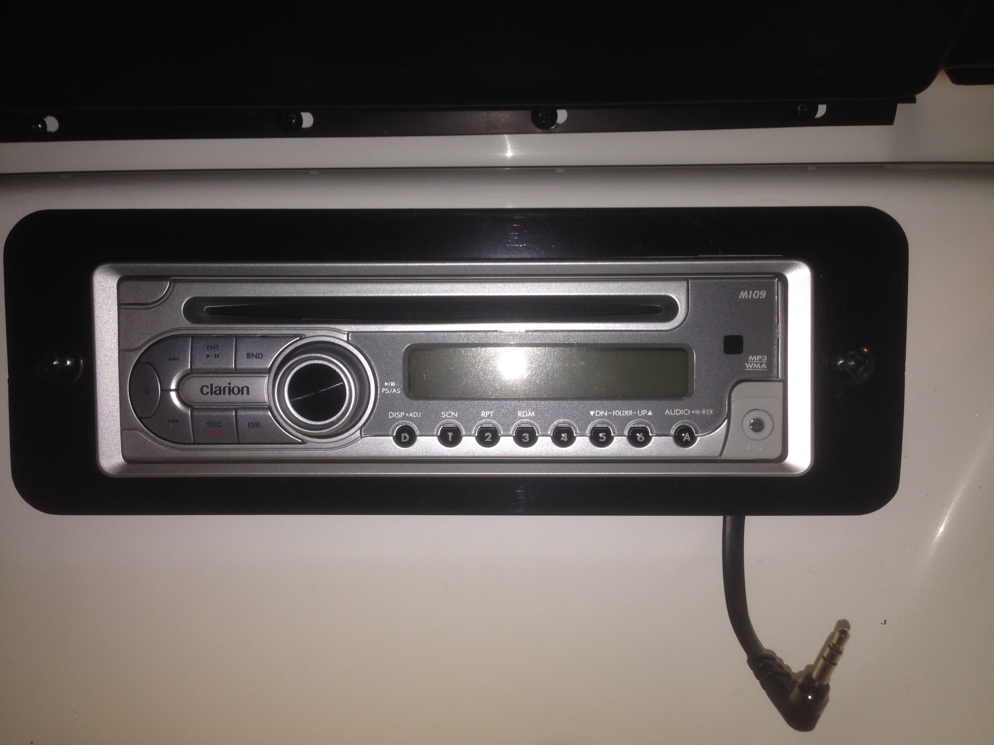

What is the input on the stereo? Aux?
Yes, it connects to the aux input. You most likely need a 1/8th stereo to dual RCA adapter.

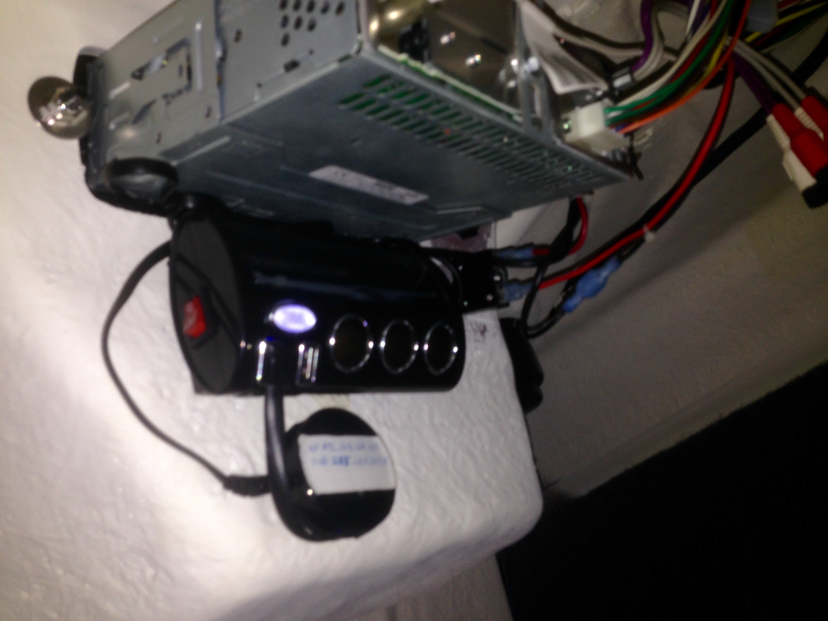

@Russ C how did you power this unit? I don't believe my stock radio has a USB of any sort. Is there an adapter or did you splice it somehow?
Thanks. It must have been a looooong winter. I completely forgot that I charged my phone from my cig lighter USB plug in thingy!
nice. what brand usb/cig lighter module is that?
It is a cheap one from Walmart it says Bell on it but who knows. The key is I wanted an on/off switch on it
I suggest using something like this $2.79 DC Converter Module 12V To 5V 3A 15W USB Output Power Adapter mounted inside the helm for power. You can wire it to the stereo switch so that is only on when the stereo is on.
