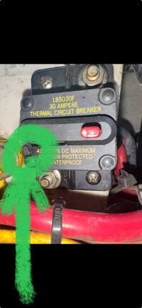

So my issue was the thermal breaker, once reset the error on reverse module went away.

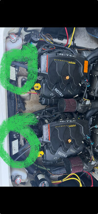

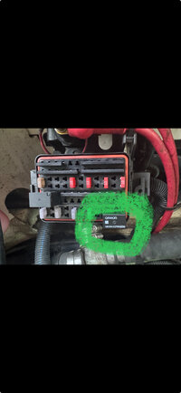

Relays are found in the engine compartment. Port and starboard both have 1 30amp power shutdown relay for all engine components and 1 30amp relay for 12v accessories.
