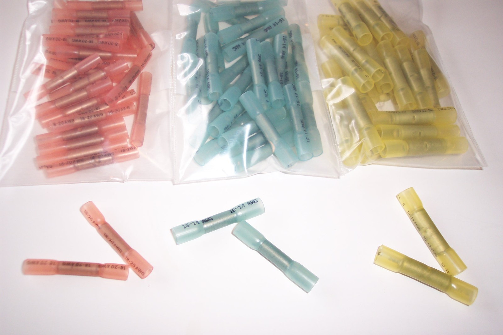

Just twisting the wire and heat shrink is not a good enough connection, over time the connect with fail. If you don't want to solder you can use some heat shrink crimp connectors.

2x on the above, I like limited dedicated circuits. I recently purchased some of the heat shrink crimp connectors, then went over them with shrink sleeve as well. My application was a wet one.
