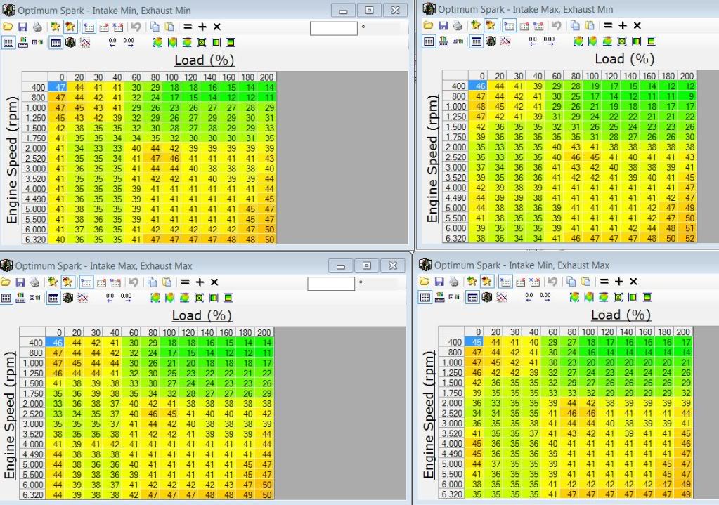

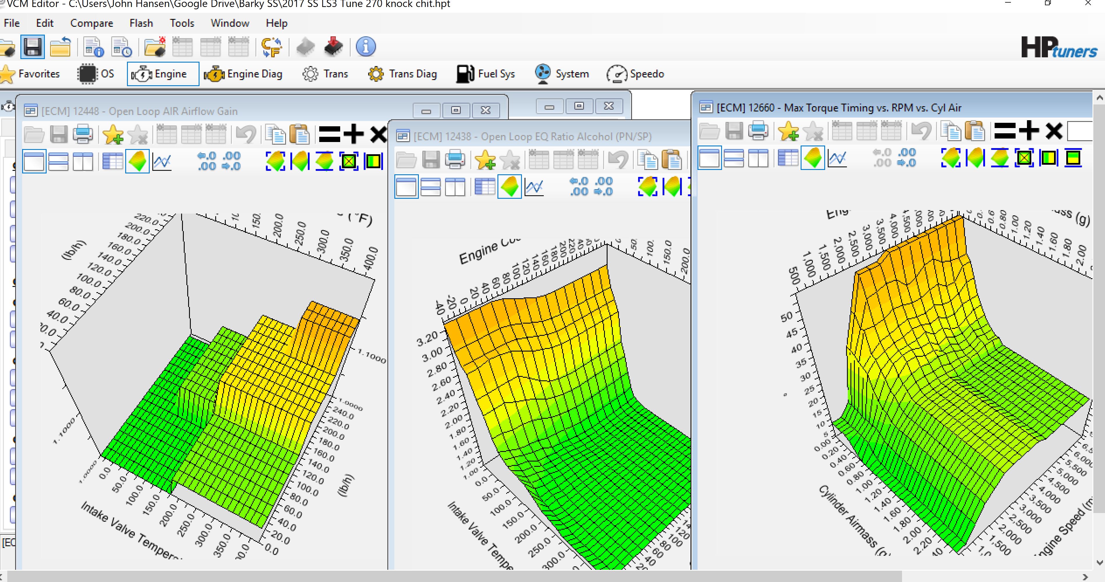

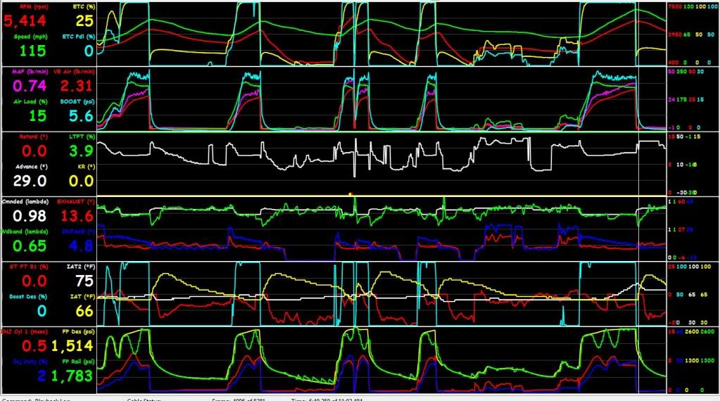

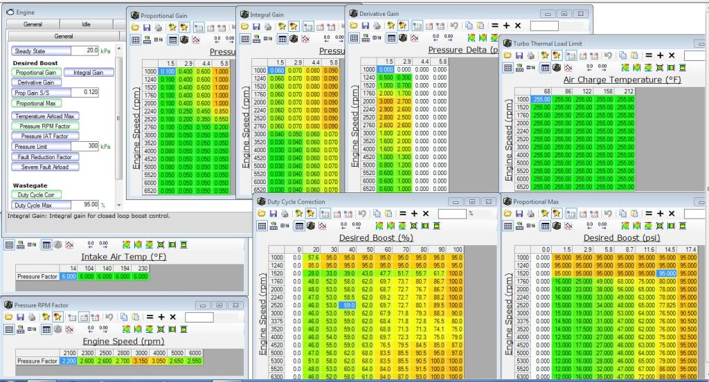

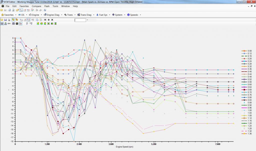

I'm still on the fence about the whole "tuning" part of my boat ownership. I'll put some pictures in here that shows a little of what I'm used to seeing as far as engine data goes. For me, it's really hard to be operating a couple engines and have virtually NO information on how they're running. I put a full blown Windows PC in my Sky so I could log every single time I drove it. I have almost 2000 logs and 1500 of my modified tunes from that car just with the LSA, not counting when the 500whp LNF was in it for years. I literally logged and tuned that engine everytime I drove that car. My "logs and tunes" folder which includes all of the race car and "for hire" work I've done is a 10.4GB folder with 7100 files in it! Yikes. I'm a little used to being overloaded with engine data.
But this boat might be the exception. I know what gains can be made on an N/A engine, especially one like these marine engines. It's not much. If it was a forced induction engine it would be a different story, I'd absolutely be tuning it and probably be running it on full E85 also. (Boat and watercraft guys are about a decade behind the times as far as using Ethanol goes. E85 is THE fuel for forced induction.)
So the dilemma is do I spend a PILE of money on tuning software only to be disappointed in the abilities and results of tuning these engines? It's a slippery slope, that's for sure. There's a ton of things to consider when you're talking about modifying these engines. Just one little factor of many, they have post cat 02 sensors. That's an issue when it comes to tuning. It's easily overcome in the auto world, but I doubt it's that easy in the boat world. Another is the fact that these engines are speed density systems, meaning there's no MAF. That's also a problem. And there's a whole bunch more little issues to consider. Honestly, the guys that are going straight to a Motec system are the smart ones. Either that or switching over to an automotive spec ECM. Both of those options are at least $2k though, Motec would be more like $6k to start. Then it comes down to dollars per mph or seconds of acceleration gained. I'm not sure it's really worth spending $6k to gain 5mph.
So I might actually just leave these engines alone for now, we'll see. (I'm sure I'll be eating those words someday. lol.) I did actually get Jesus's email address and was going to get in touch with him and see what we could do together. If he knows the marine side, I know a crapload of other stuff. I know we could learn a bunch from each other, but to what end? Is there really any market for tuning Yamaha jet boats? Doubtful. Is there a whole lot I could gain on my own personal boat by jumping into the marine engine tuning world with a bunch of cash out of my pocket? Also doubtful. (Sorry to be a downer! haha.) This 212 I bought is pretty fun as it is. Could I put a couple of 500hp automotive engines in it and make them work? I'm sure I could but again, what would the end result be? Probably a ton of money spent to turn a boat into something it never should be.
So for now I'm going to tell myself it's ok that I can't see a thing that's going on with those Yamaha engines. I'm still going to work on getting what's there working at it's highest efficiency, like re-pitching the port impeller or tweaking nozzle sizes and stuff like that. I will absolutely be watching what you find out on your Maptuner X experience swatski! Good luck and I hope you get some good results. If there's ANYTHING I can help with as far as the tuning goes, let me know. I will give you one piece of advice right off the bat, if you're modifying fueling, you NEED to be monitoring it constantly. Dual widebands would be my first addition if I was going to start modifying fueling. Here's a thread where I contributed about the AEM 30-300 widebands and response rates... https://www.hptuners.com/forum/show...AN-integration-W-VCMScanner-Need-beta-testers
Sorry for the novel guys! Once I start typing the stuff in my head just has to come out! lol. Here's a few pics of the kind of power tuners have in the automotive world... (And if HPTuners worked on these boats and you were starting from scratch with nothing, it would cost a total of $500 to tune and log BOTH engines all you wanted. Damn boat tax!)
