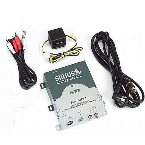

Has anyone been able to get Sirius XM on the OEM Stereo that come with the Scarab?
