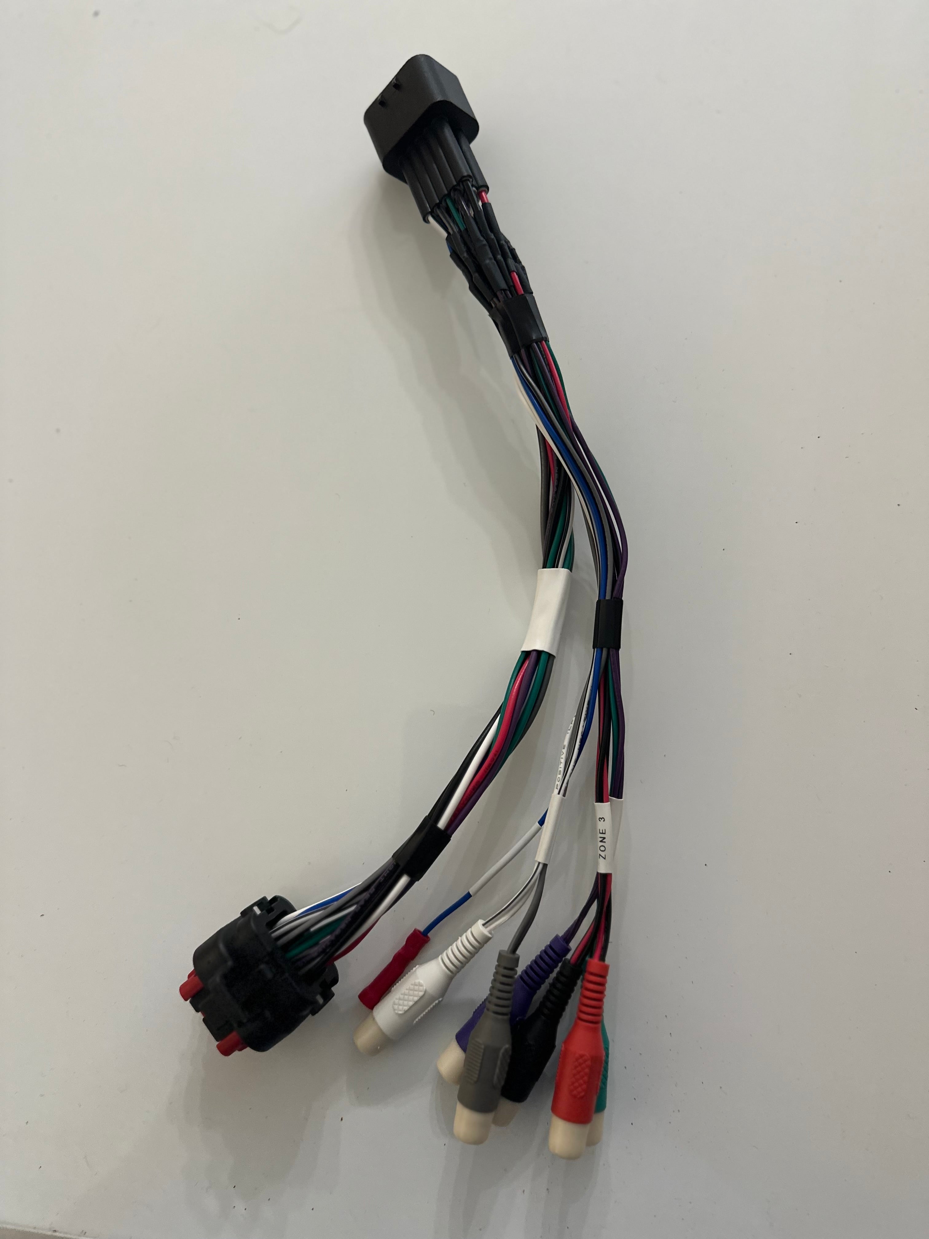

Yup! We offer a t-harness that provides RCA outputs to each zone, as well as a remote turn on wire.

@Adrian @ JB Solutions - Just to ensure I am following can you confirm your adapter works in different applications:
  1. Keeping the OEM WS Amp, and providing RCAs for each of the channels to add an additional amp(s) - Tower speakers in this application.
  2. Ditched the OEM WS Amp and just using the RCAs to supply replacement amp(s). - EG Repowering the system.

Yes it works for both 1 and 2. It is a T-Harness so in application 2 you just don’t use the end that would go in the amplifier. You could also cut off the end to sell with your OEM amplifier. We also offer speaker harnesses to make replacing the amp a breeze.
