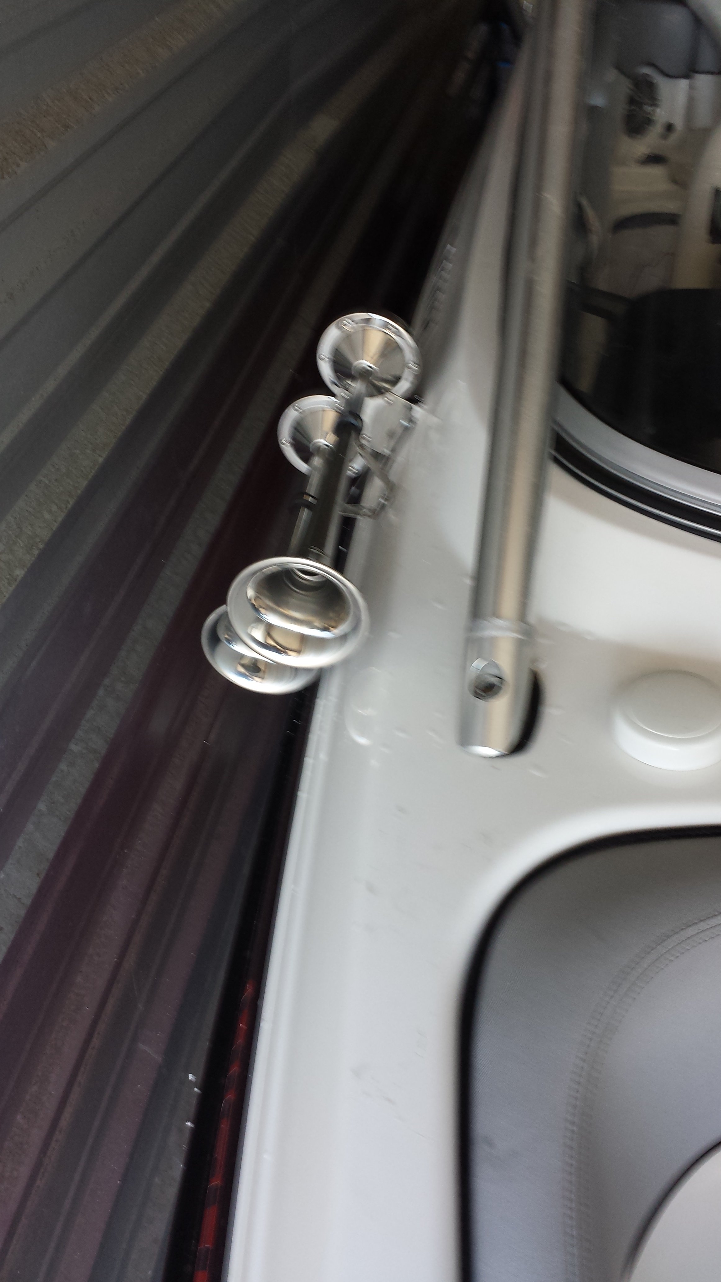

Not too bad installed. Here is where I put it. Sounds MUCH better than the stock 'sick duck' horn!

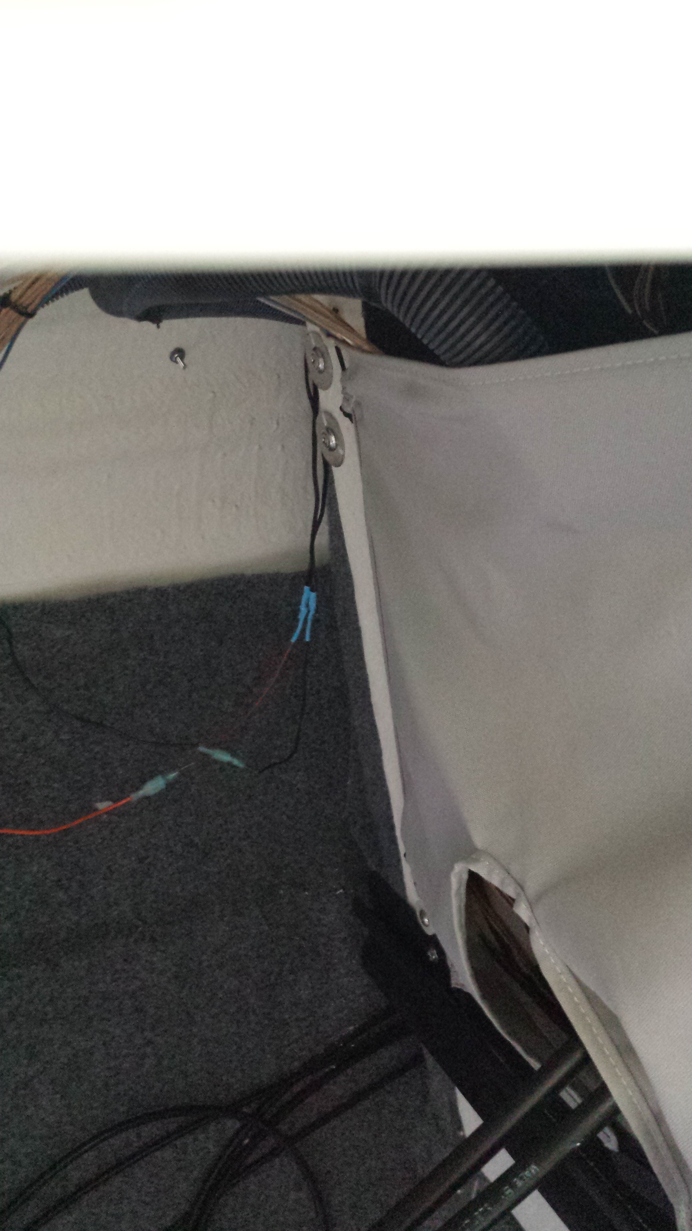

Wiring is not completely tied up (I have my amp out right now, so when I get that back in I will tie up these wires, too). But basically I unplugged the wires from the horn and pulled them aft out of the casing until I had enough to reach the new forward position.
Note how close I am to the helm space there. Another inch aft and I would have been having a difficult time. Good thing I planned it as I did. Er...
One other note is that I was not able to use the hardware that came with the horns. The bolts were too short to fit through the fiberglass. I drilled a hole just above the aft bracket on the horn for the wiring; sealed that up with 4200.
