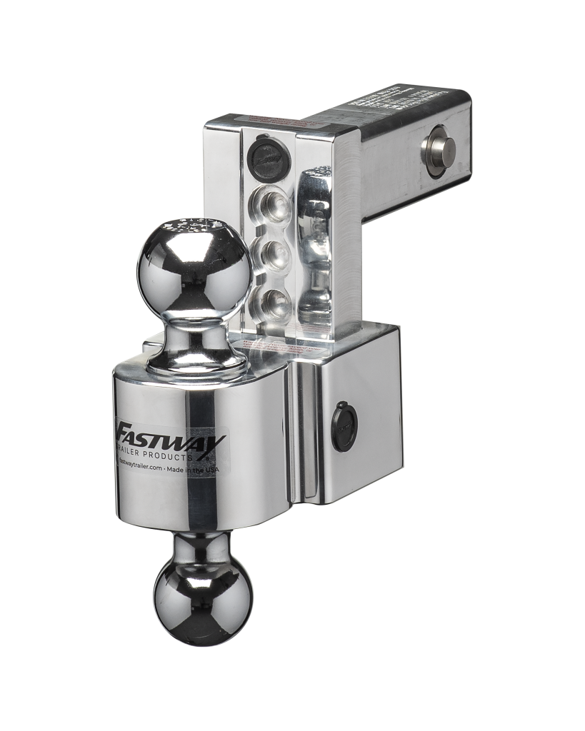

a tip from my pontoon buddy. He was flipping his drop hitch and rise hitch when loading or trailering. He needed height on the highway to get it level, but needed a drop at the landing to float the boat off. So he would flip his hitch each time.
Now he bought an adjustable hitch, and just dropped his tongue jack to adjust height when he tows or lands his boat. You could use an adjustable as well if it had the range you are looking for.

x2 on this. Get an adjustable, I have an aluminum one that was god-awful expensive for a hitch but it's 4 or 6" range of motion and it can be flipped to make it a 12" range of motion. Then throw away or donate the 2 or 3 other ball mounts you have laying around because this is the last one you'll need. It also has 2" and 2 5/16" balls.

Just got a weigh safe adjustable hitch ordered. Hopefully this will work.
