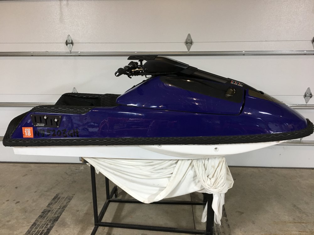

I have a custom Yamaha Superjet and I think that I could fit it on the swim platform in the back. It would make for a nice looking ballast. It's 7ft long and 26.8" at it's widest. Has anyone tried this?

I've had 800 lbs of ballast on the swim deck. I think the superjet is under 400 lbs. If it will fit it won't be too much weight.

I don't have a stand up yet, but I've measured and it should fit. You might need a support on the lower part of the step to make it level with the upper part. Post pictures!
