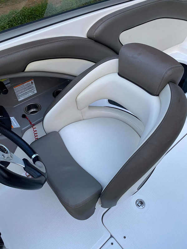

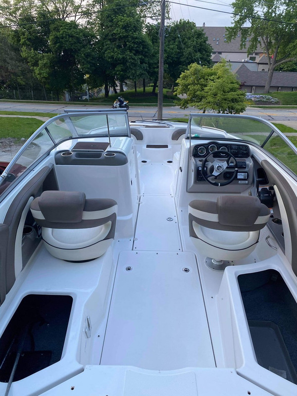

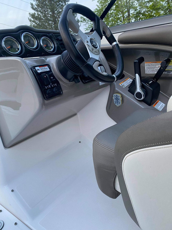

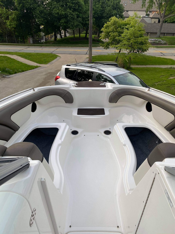

Have new IPD graphics for the side, and blacktip blue and white seadek mats for the entire interior. New swim platform seats. New boat buckles. Thinking about picking up two ribbon deletes and 2 Mission Sentry Fenders, and I think I need a new bilge pump as well.

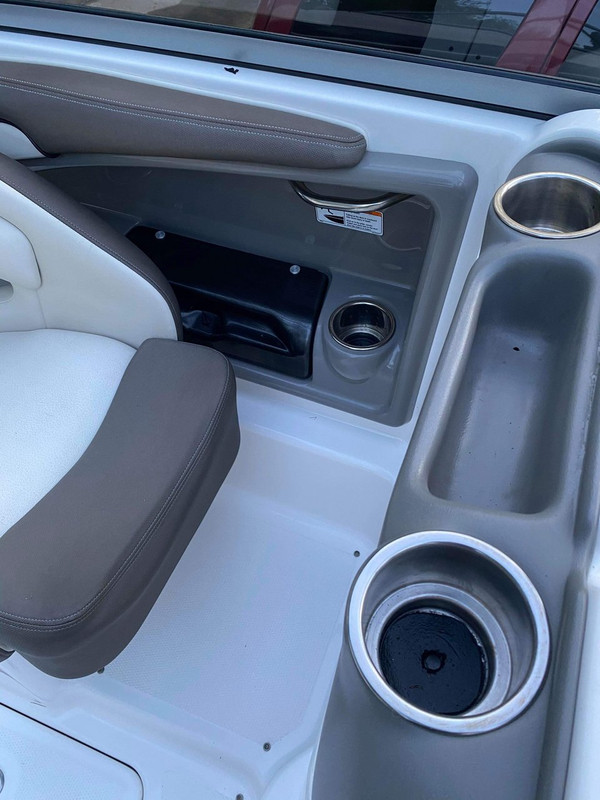

The cleanout ports look pretty good. They go in and out easily. Do you still have to replace the scupper valve on these models? Any other "must do's" for a new 242 owner? Thanks to everyone before I pull the trigger tomorrow!

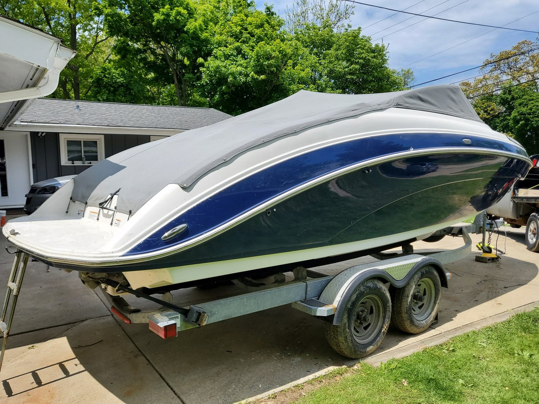

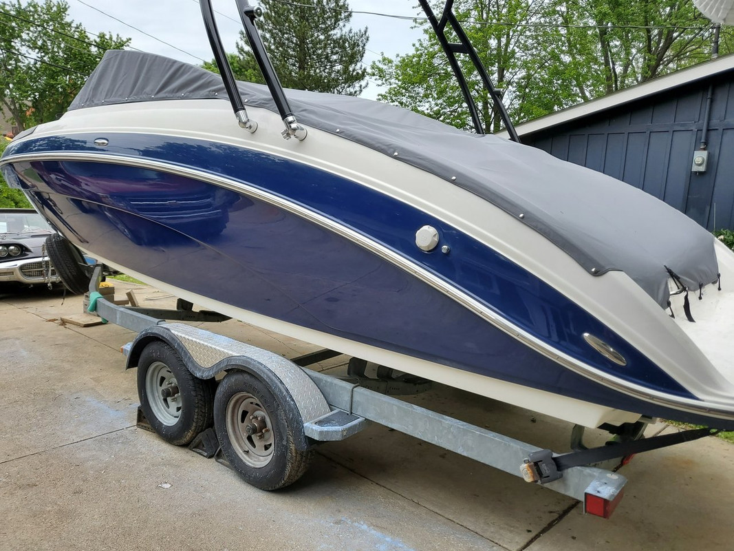

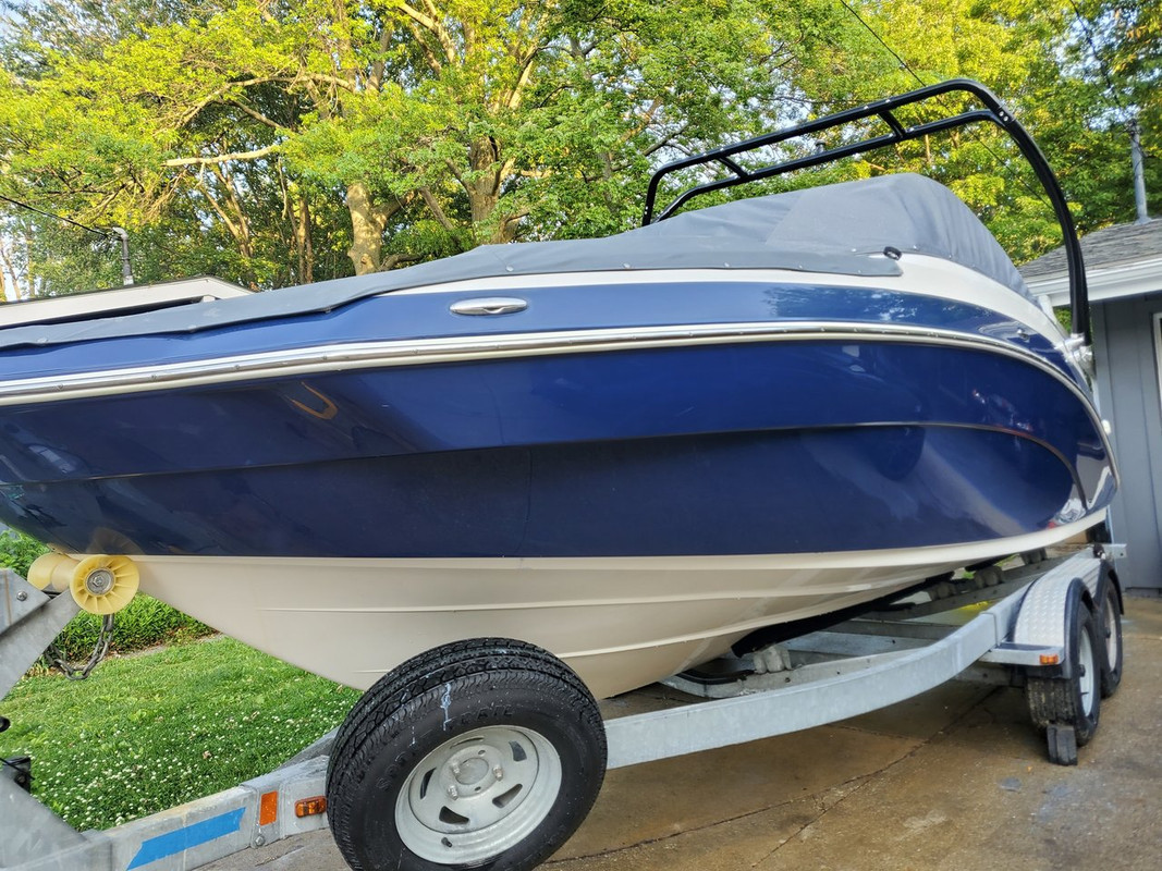

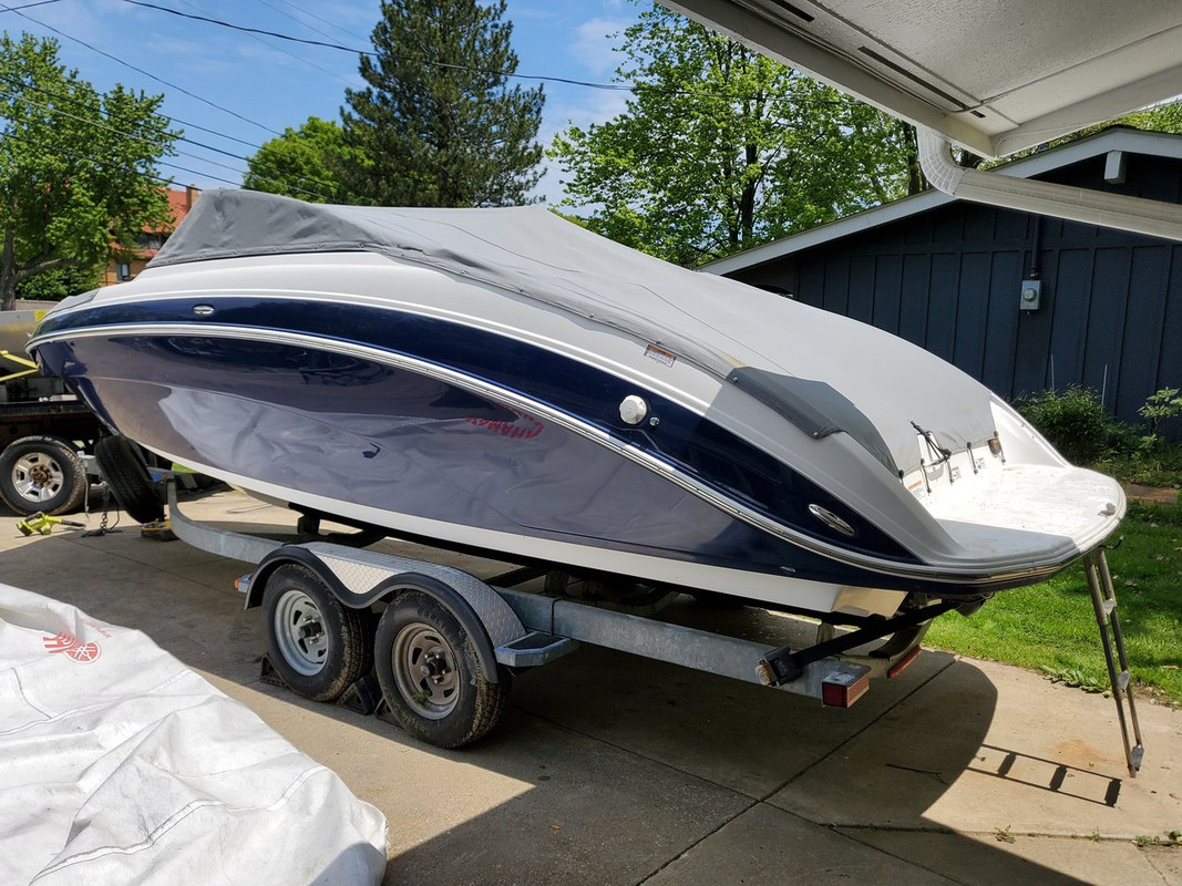

@kaczman I will say that my Yamaha mooring cover is shot from the Florida sun (I'm in Ohio)> I recently purchased the Classic Accessories boat cover made for wake towers and absolutely love it! What a freakin bargain for the price! Wraps around my wake tower like a glove. Water beads up. Completely dry after our hard spring rains, etc. etc. This is a big gamble and I'm glad I took it. Would recommend for anyone.
I'll try to snap some pics before I drop it off at the marina.
Sweet! which model did you get, and send those pictures when you can. Thank you again!

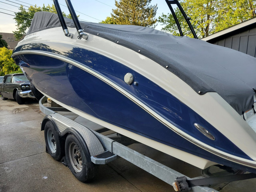

@kaczman I got the 20-22' one and it fits perfectly. It also has straps that connect to the trailer and they advertise it can be kept on when trailering but I wouldn't for long trips. Keep in mind, mine is a 21' and the 20-22 works great. Will send this by EOD.

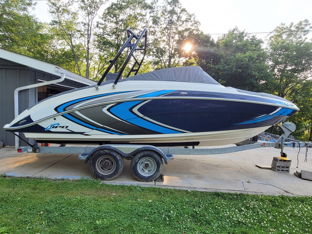

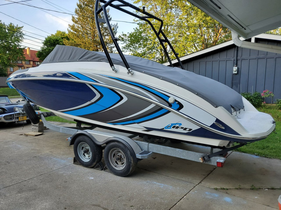

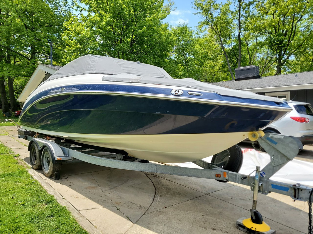

@kaczman apologies for the delay. Ignore the mess and ignore me not putting it on as it should. I spent yesterday evening using a buffer with a cutting compound before I apply a ceramic coating. This gives you a good idea. Also, believe it or not, Home Depot had the best price.
That looks great, thank you for the pictures. I think that will work. How much did you pay?
This cover also comes with a pole for rain runoff. I just left it off because we're getting ready to drop it off at the marina.
Yeah, it's got a sweet charoal grey/dark olive cover. Really like it. After VERY hard rains (which we get in the Ohio Valley), the boat was bone-dry. This one is $310, I believe? 20-22'
I mean, even if it fails after a few years, I've still only paid a fraction of the Yamaha $700+ price.
One last thing ... the straps you see hanging off, those are strong nylon buckles. They wrap around your trailer so that you can keep it covered while trailering. This is not common. We plan on taking a summer Torch Lake trip in upper Michigan in Aug., it's nice knowing we have that option. Believe me, it gets very tight too!

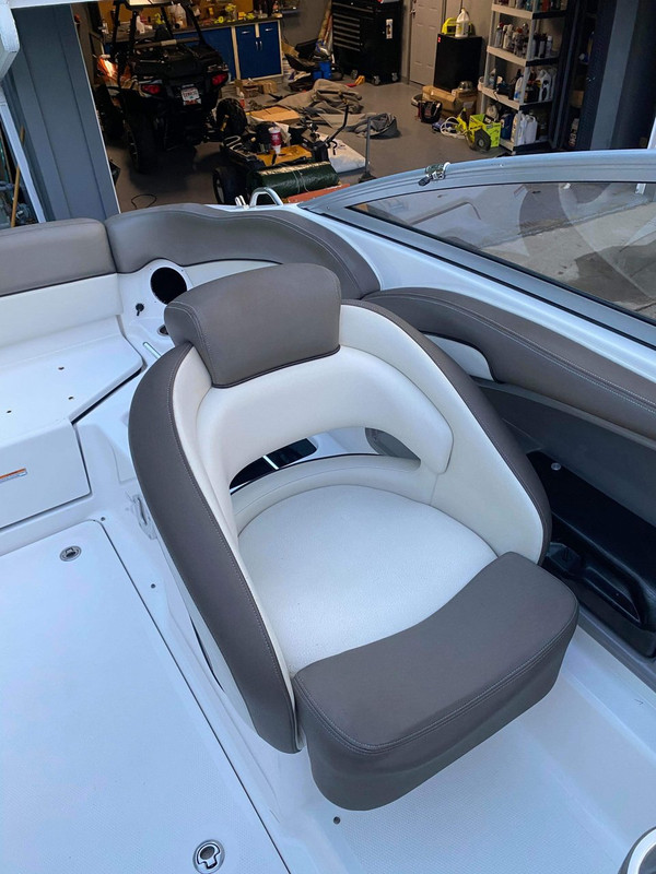

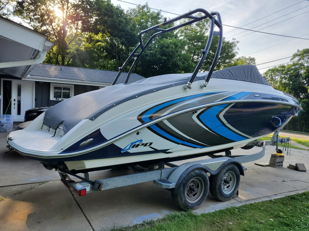

So here's my list of updated items so far. Still some ways out, still some unanswered questions.

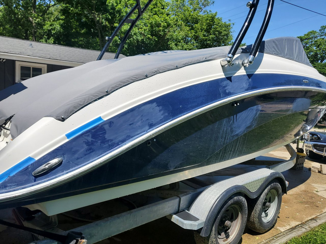

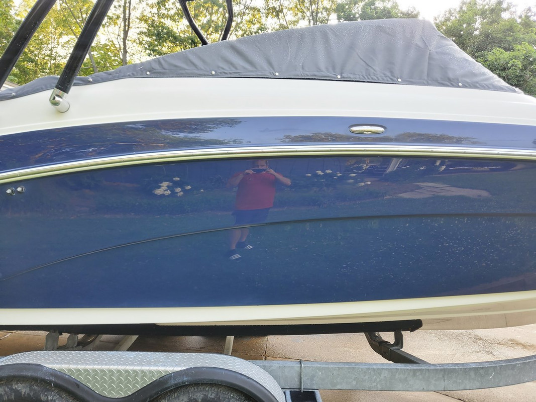

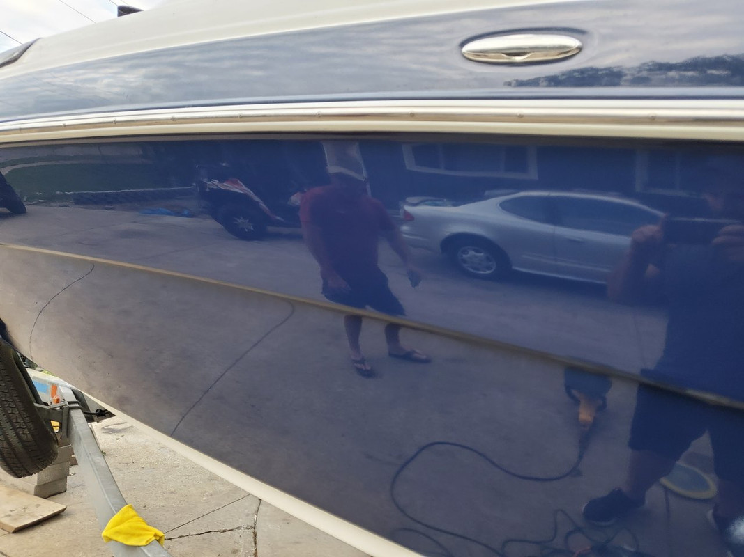

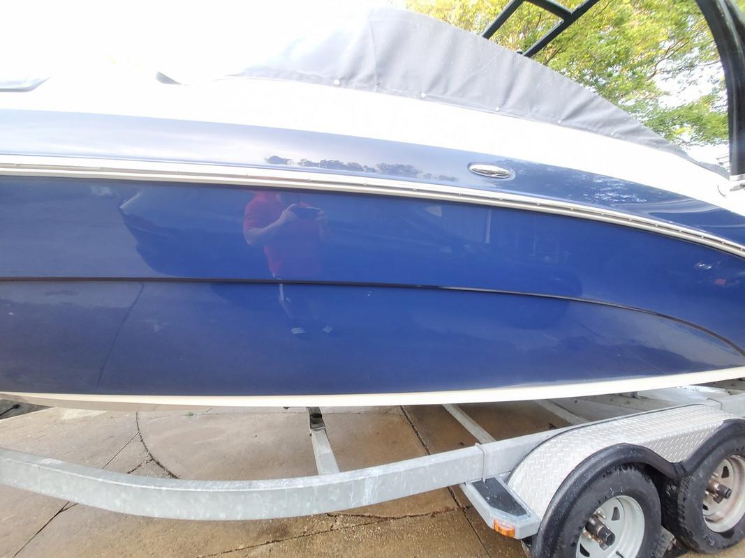

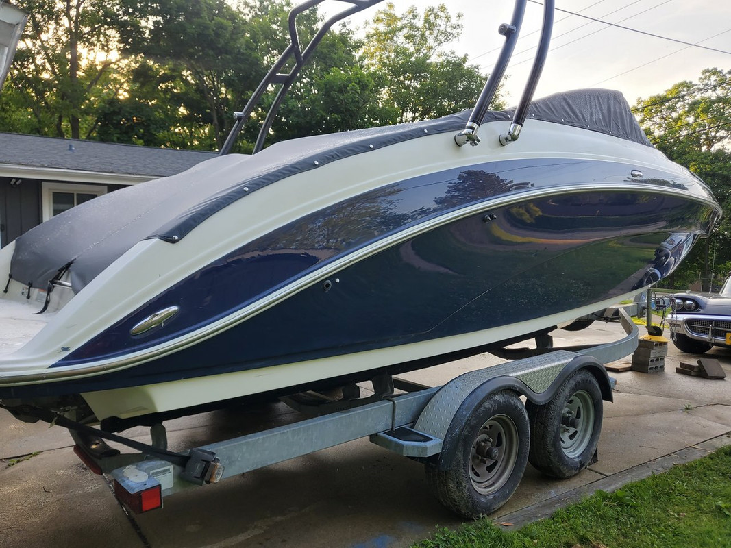

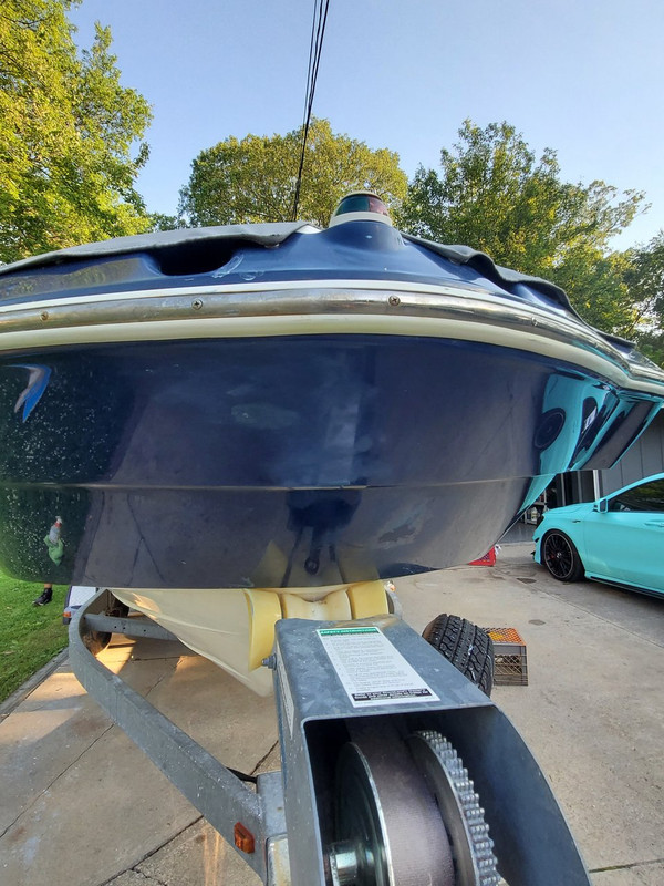

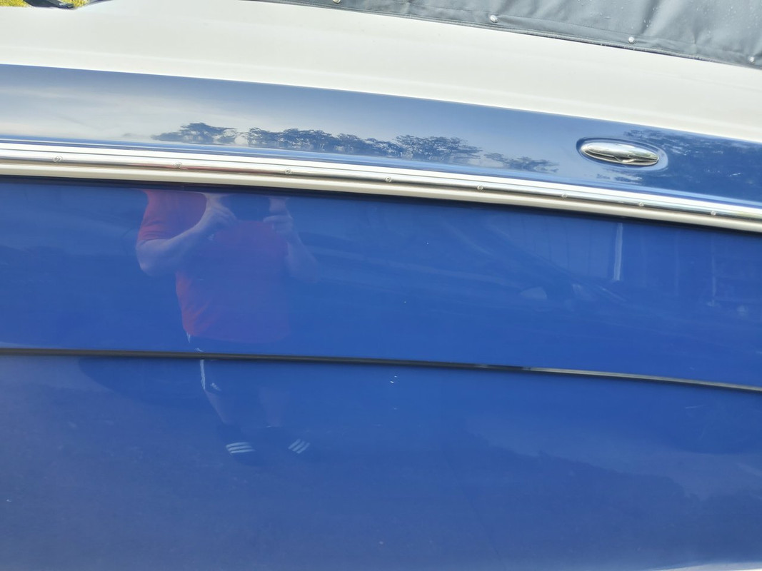

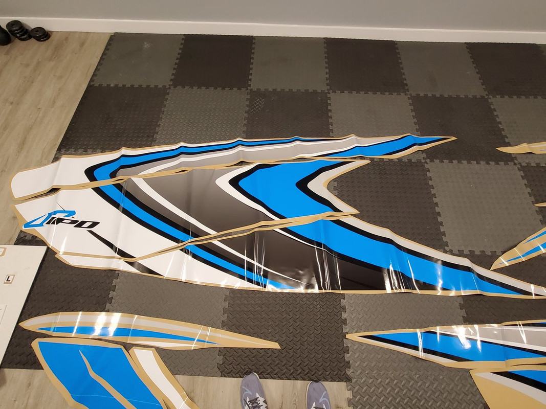

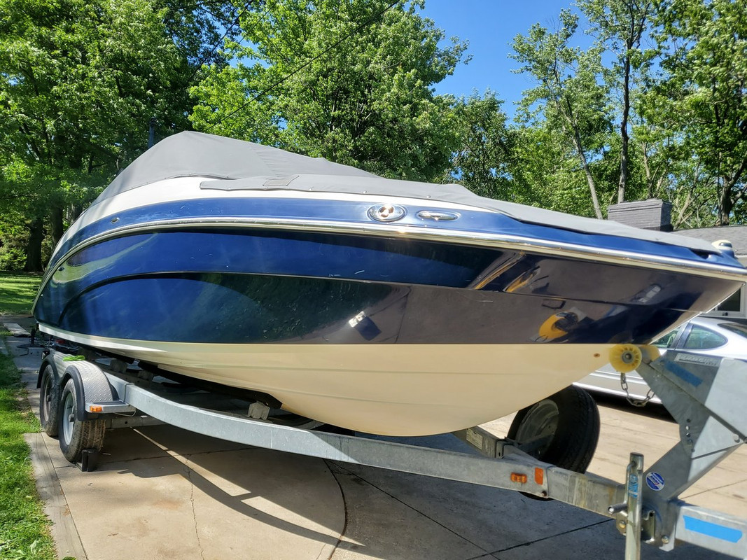

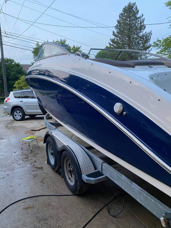

I wetsanded and polished the boat, but ultimately was unhappy with all the scratches and chipped gel coat after like 6-10 hours of correction.

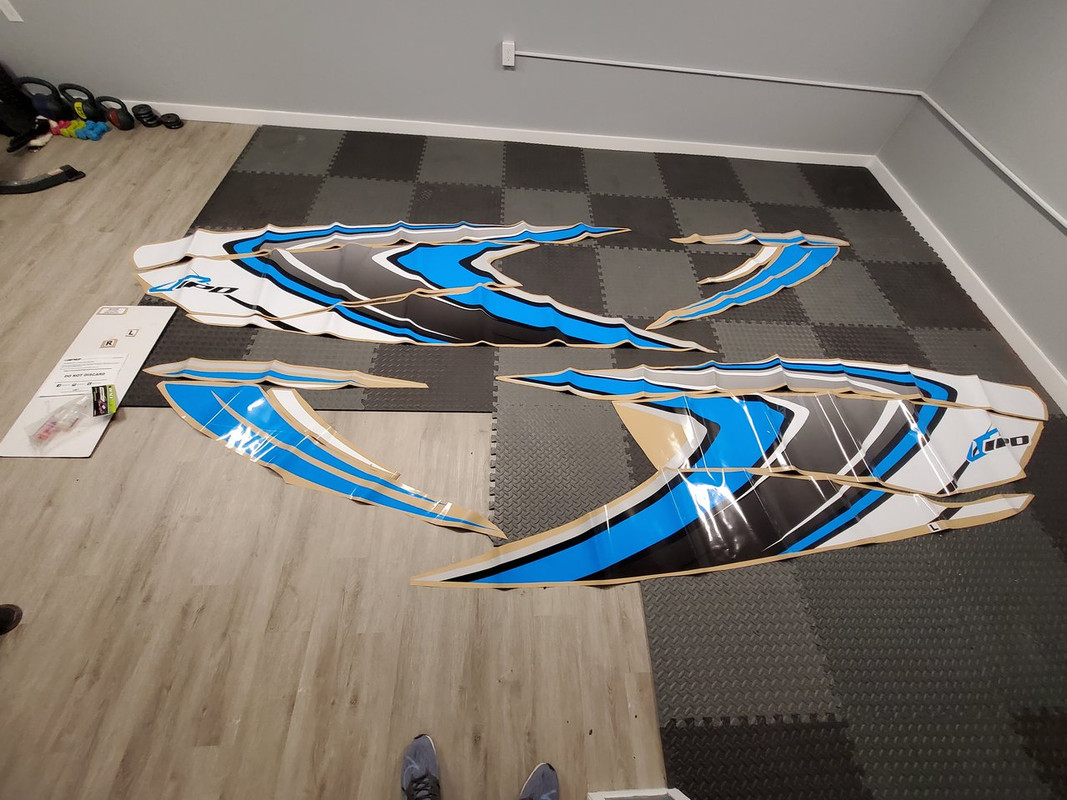

So I decided to get some Yacht blue gel coat, and go over every scratch and damaged/missing area to make the boat look like new before I threw the IPD graphics on it. A small thing, but thats the way I am. The first set of pictures are pre-gel coat, the second set of pictures are post gel coat, drysanded, wetsanded, and polished.

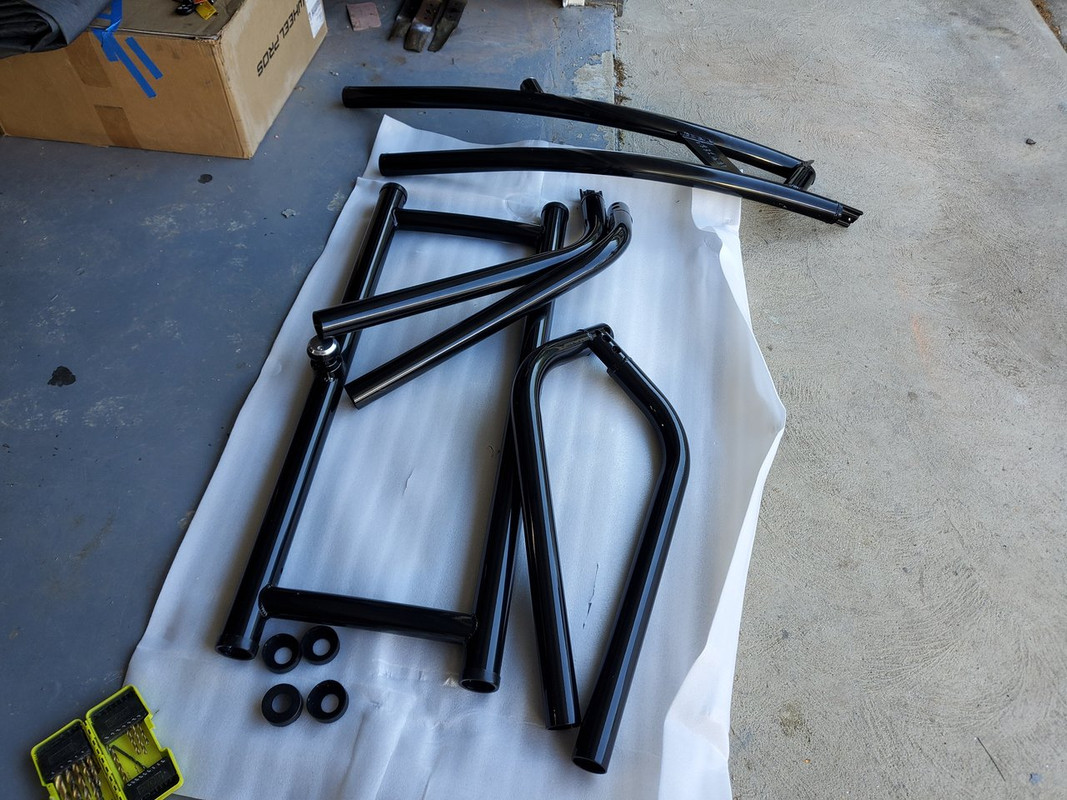

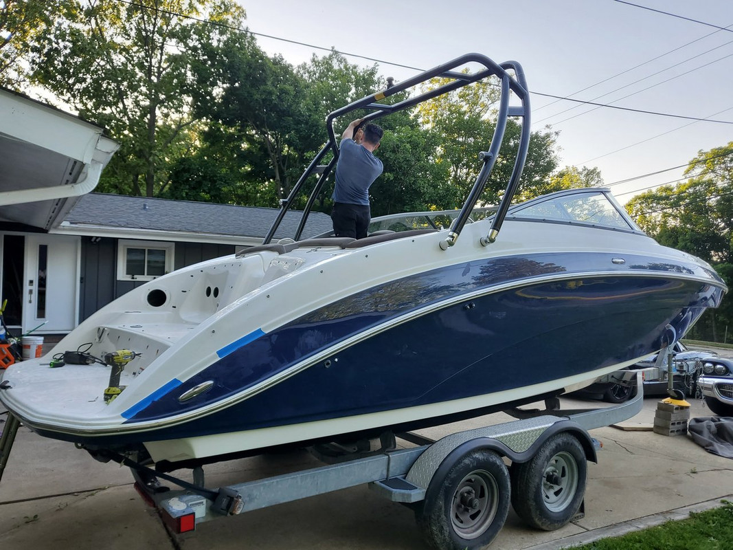

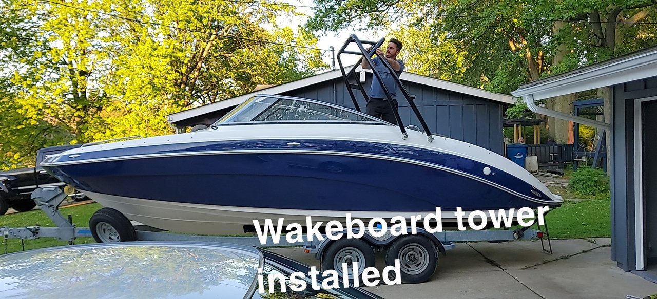

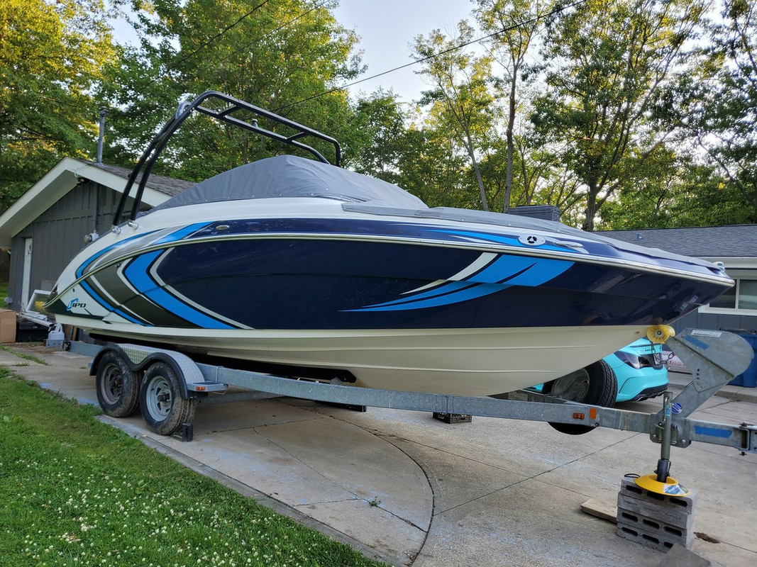

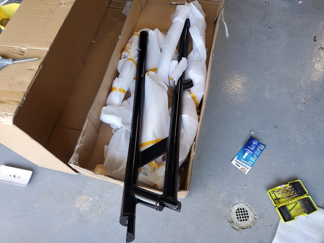

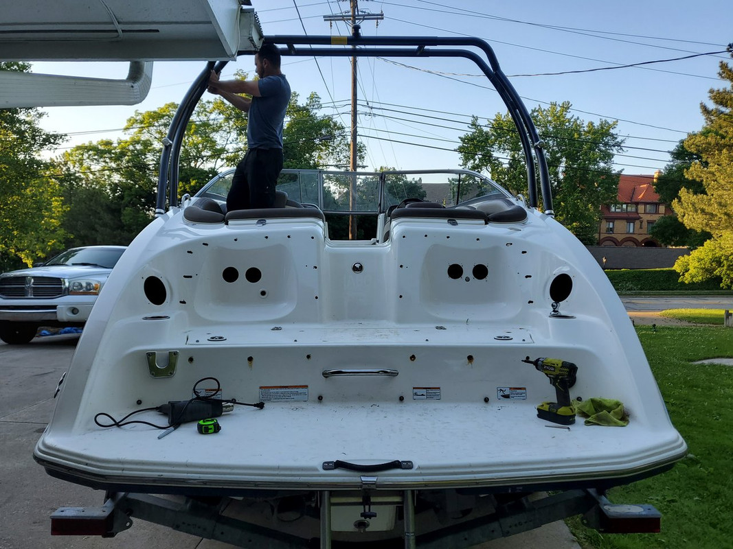

We installed the Reborn Launch tower. Took about 5 hours with two of us, not bad. Matte black looks great. Holds up better than OEM. I have a black bimini top that integrates coming this thursday. And I have blue lightning blacktip mats going in soon enough.

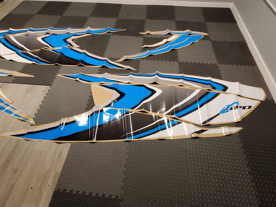

The last set of pictures are the IPD graphics installed, which look great. I love the colors and how it changes the boat with the wakeboard tower. Last set is another interior detail.
I'm quickly learning not too many of us modify these boats, so some of these questions still arent answered, but here they are:
Does ANYONE have any idea how the hell to get a 242 Limited / S new bow cover? I purchased a new cockpit cover, which fits and looks great, but the bow cover has seen better days. Ive checked ebay and google for weeks, but have yet to find a place to buy it.

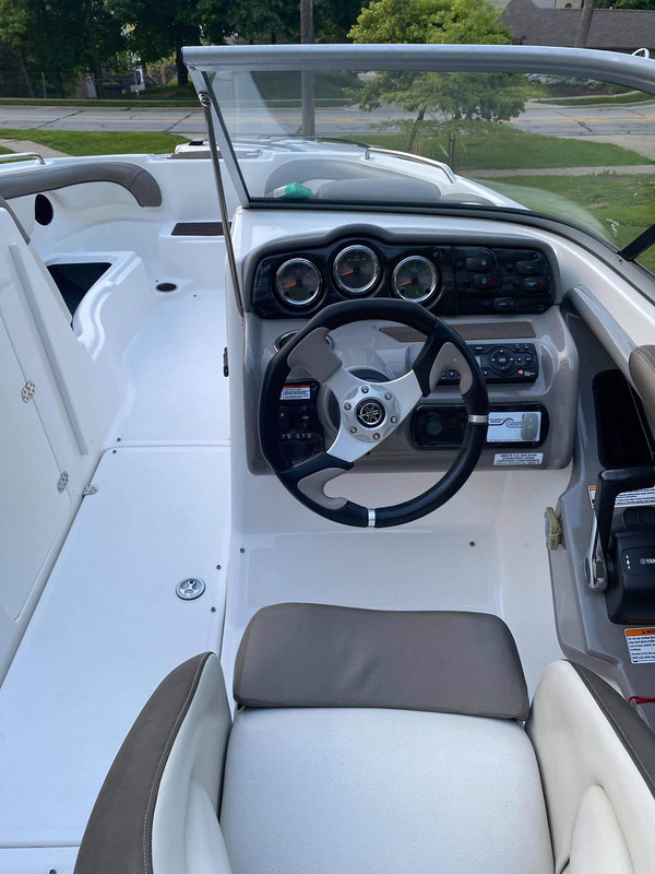

The cleanout ports look pretty good. They go in and out easily. Do you still have to replace the scupper valve on these models? Any other "must do's" for a new 242 owner? Are the ribbon deletes worth it? For the price, it sure seems like it.
I'm still at a loss for what to do with the radio. I know the 242 Limiteds have 6 speakers - how is that ran to the factory radio and internal amp? From my understanding, it's a 4 channel amplifier, and the rear 2 channels are bridged to 8 ohms? Wouldnt it make more sense to pick up a 6 channel amplifier and run new wires for the rear 2 speakers? Or add 2 more front speakers, and bridge them to get 8 channels total at 8 ohms each? Trying to decide between which radio / amp and adding speakers is still boggling to me.
Pictures:
Looks nice, I do like the Blue, but I ended up with the black.
I chickened out on wet / P1000 dry sanding my new (2011 242 Limited S) boat. It looks better but still needs more work.

I have the '10 AR210 and the radio was factory with factory speakers that were garbage. Speakers were factory harnessed into factory deck, no amp. I replaced with a SonyMEX-M72BT (comes with remote too) head unit with 4 Kicker 6.5", 2 JBL 8' marine clubs, 2 skar bullet tweeters, 1 - 10" Clarion sub, 1 Rockville 1600 watt - 4 channel amp. The built-in amp on Sony head unit puts out a lot of power as well. Currently, my setup gets too loud and our riders complain lol :) ... So I'm happy!
All LED RGB wires are connected through all speakers and controlled by the Kickers LED remote, bypassed through a separate switch I installed, so they're all in sync including JBL's on the tower.

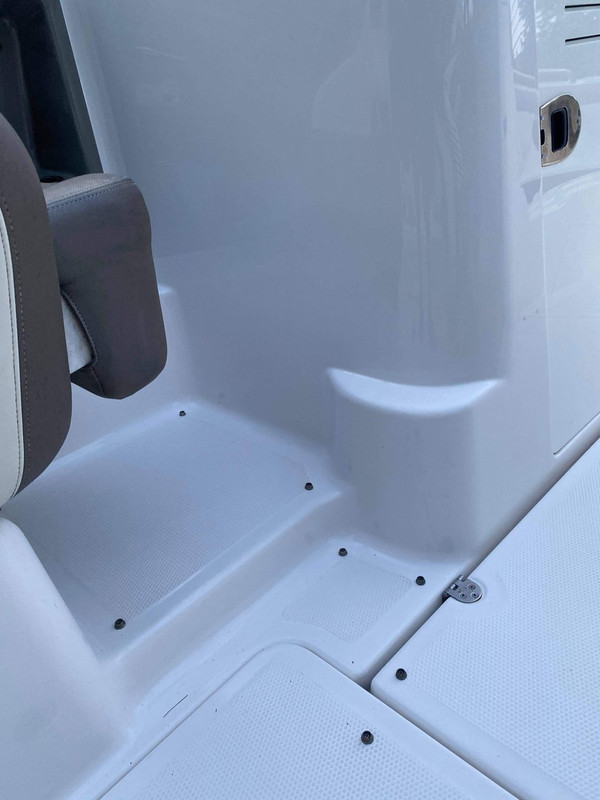

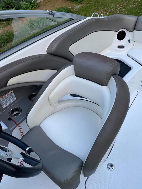

Got a new 8 channel amp, 6x speakers, subwoofers, and Fusion radio. Anyone know where to find the wiring diagram for this Aquatic AV radio OR the 2011 242 Limited so I can pull 4 of the speaker channels from it to connect to my amp? I'll run 2 new channels for the swim deck speakers and 2 new channels for the subs, which I dont know where to place as of yet.
