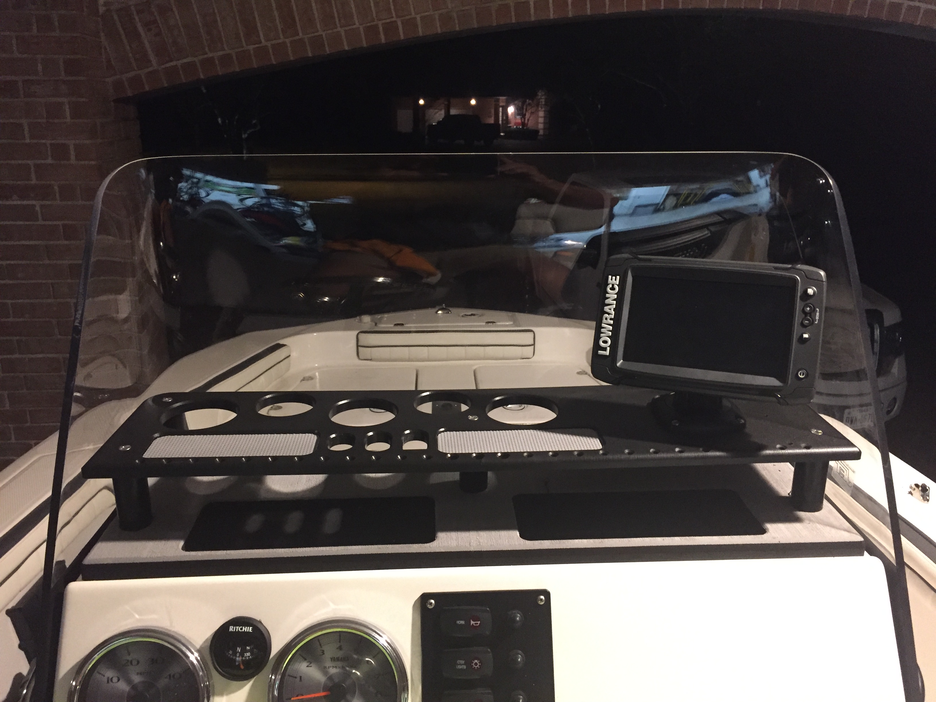

Making a little bit of progress though going kind of slow while learning and considering options. Spending way too much time and energy but having a lot of fun and enjoying the process.
Got the console organizer installed and the Elite Ti set though still struggling with location and mounting of the totalscan transducer. BTW - the console organizer is very strong and solid - no movement at all and will add a ton of usability. Great item from JetBoatPilot.
The template for the aluminum plate is at the fabricators and I am going with a similar concept as @Brian Filas though will probably not look as good as his. Will be tackling a though hull depth finder next (don't always have the fish finder when just kicking around) and hope to get the seadek ordered in the next couple of days.

@WTScott ... I am so jealous of the organizer. The problem is, I dont think it will fit into the garage (I only have a few inches to spare with the windshield off). To get around this my next huge waste of time and money will be building my own organizer that is attached to the windshield, versus the console. That way it can come off with the rest of the stuff. Plan to route some starboard to match the contour of the windshield. We will see. As far as a transducer.. I have been looking at the Humminbird 360 attached to the motor. I dont really need to see fish when I am running at 25 knots, so should work fine.

@Brian Filas - Brian, thanks for the comments and agree on the organizer.
I think you could save a ton of overall time by buying the JetBoatPilot organizer and just taking the less than five minutes to take out the six screws that hold on the top part when you want to use it /store it. It is really easy to do - just six lock nuts with wide washers. Since it is bolted on and not screwed in that would not give you a long term wear issue. Also, with the windshield off it is a one man job with a power screwdriver (depending on arm length).
You can also use the organizer without the top just as a pad.
That being said, a lot of us are doing this for the journey - not just the destination.
