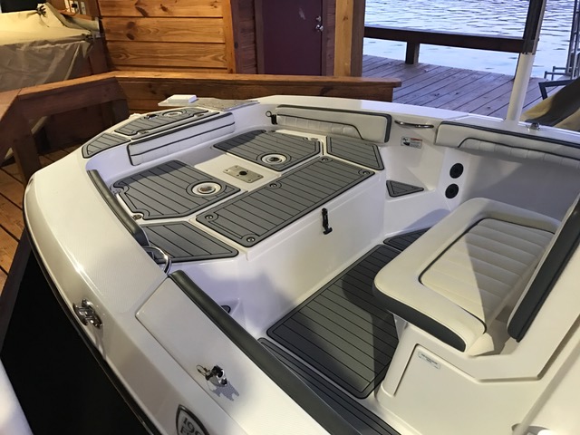

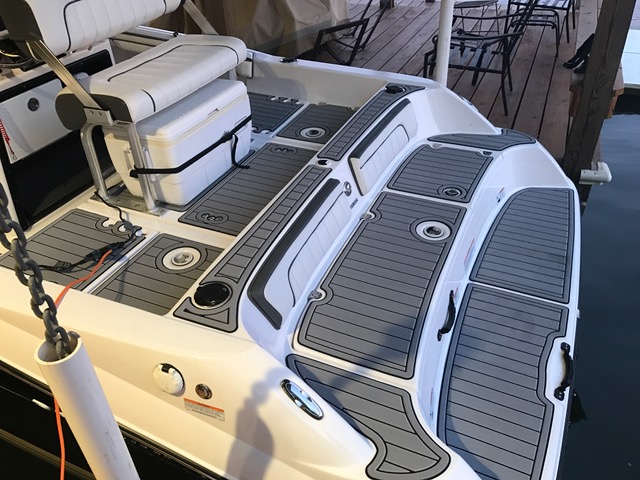

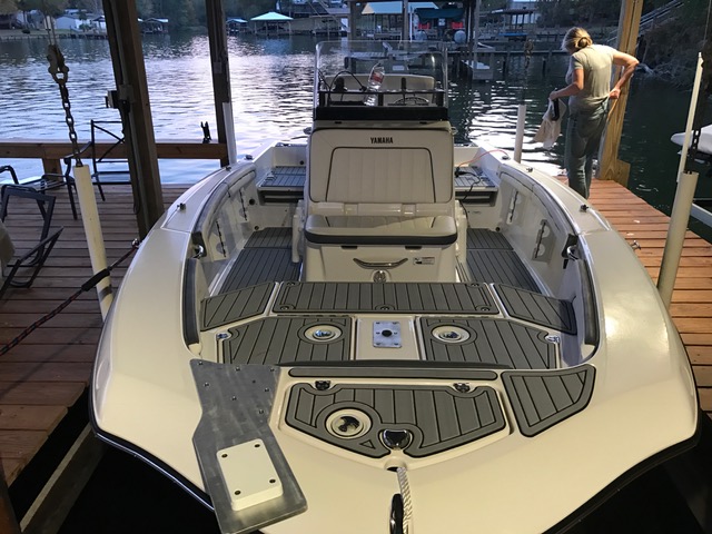

Got my SeaDek installed over the weekend and am really pleased with the result except we did learn that there are dedicated bottom panels for the Deluxe without the cutouts for the tower. Waiting for the replacements. They are also sending a new seat post pad as the one sent was solid. The process is really easy and just requires a good cleaning with solvent (I used acetone) and some careful placement of the panels. Kind of like installing wallpaper but not nearly as many arguments between DW and myself. I am very impressed with the precision of the cutouts on the panels and overall quality of the materials. Highly recommended even though I just missed the great deal on the group buy.
After some more use and testing, I am noodling on replacing the aluminum trolling motor bracket with stainless - looking at weight difference. I think it would look really nice to duplicate the port pad design maybe etched in. Definitely not a need to have and low on the priority list....
