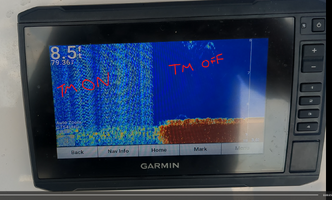

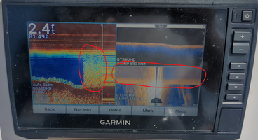

I have noticed it is interfering with clear-vu as well. Standard sonar thru factory Airmar is the only thing that is really clear with troller on. Very disappointing
