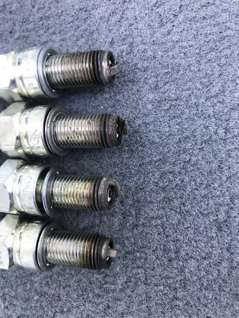

Thanks for all of the help guys. I changed the spark plugs and the problem is fixed. Even though the plugs really didn't look that bad it runs way better now.

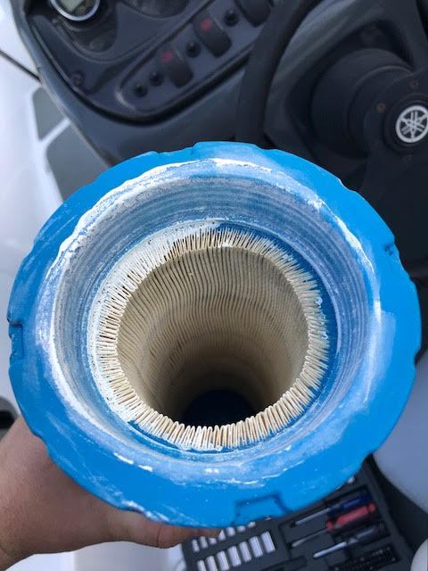

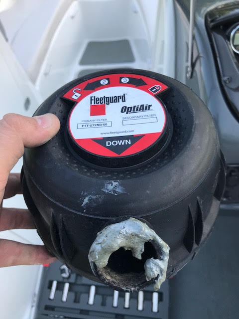

I went through and checked air filters and oil levels. I did find an odd powdery substance on the air filters along with some type of caulk material on the air filter lid.
Any ideas what these may be?
Damn smugglers were using the ski and a package broke open. Or maybe not!
