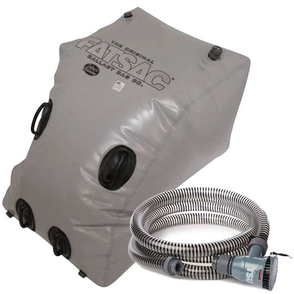

the best option for that would be the transom fatsac.
Aside from that there's probably not enough room in those lockers to put anymore bags that would help much without removing the hard tanks. Other option would be lead bags, which aren't actually lead now. I have about 200lbs of that as well to move around the boat.
I personally was not a fan of the transom fatsac, but others seem to love it. Really for me it was just the setup took a long time. By the time I was done I was hot AF, sweating like a sum bitch, and generally annoyed with how long it took. Now it very well may take a while for me to fill my bags with only 88lbs per min pumps in stock form. However, since I'm likely going to have to go with external switches swapping out the pumps to have them fill faster is only a matter of money. LOL! I'll likely be just fine letting the boat run while the bags fill up and either continue to swim around, or hang out and get something cold to drink while I wait. Or idle out to where we're going to be surfing anyways.
