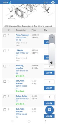

When I start searching for parts for a wear ring on sites like boats.net or other such nothing is listed,
Just the complete housing no removable ring
After deeper research in the parts breakdown I have also found that the shaft does in fact have a rubber shear clutch so it puts me to question what direction I should go - We have put rings in Jet Skis but not any of the Boats
Have a shop and everything but I don’t know how much we would be biting off if we tried changing the wear ring or housing if that’s what is needed
Or as well that rubber shear clutch
