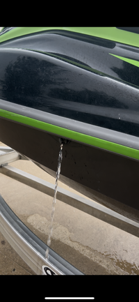

Are you getting a good stream of water out the side of the ski . There is a water "pisser" out the side just under the rub rail. Should be on the left side usually about where your left foot is. But on the outside of the ski?
If it is spraying out strong with rpms then your pump isn't restricted.

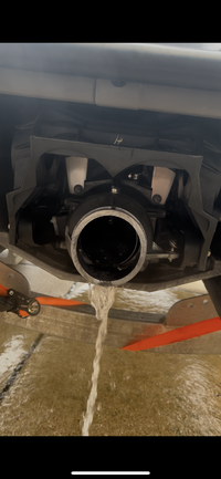

Yes on the front left side it flows well. I attached pictures of it (won’t let me send the vid). More does come out when it’s in water and not just on the hose.
It flows fine I do think it might be the filter causing the issue with a small block. Runs fine for couple hours and then seems to be in some sort of limp mode to 7k. After idle for 5 mins returns back to normal.
