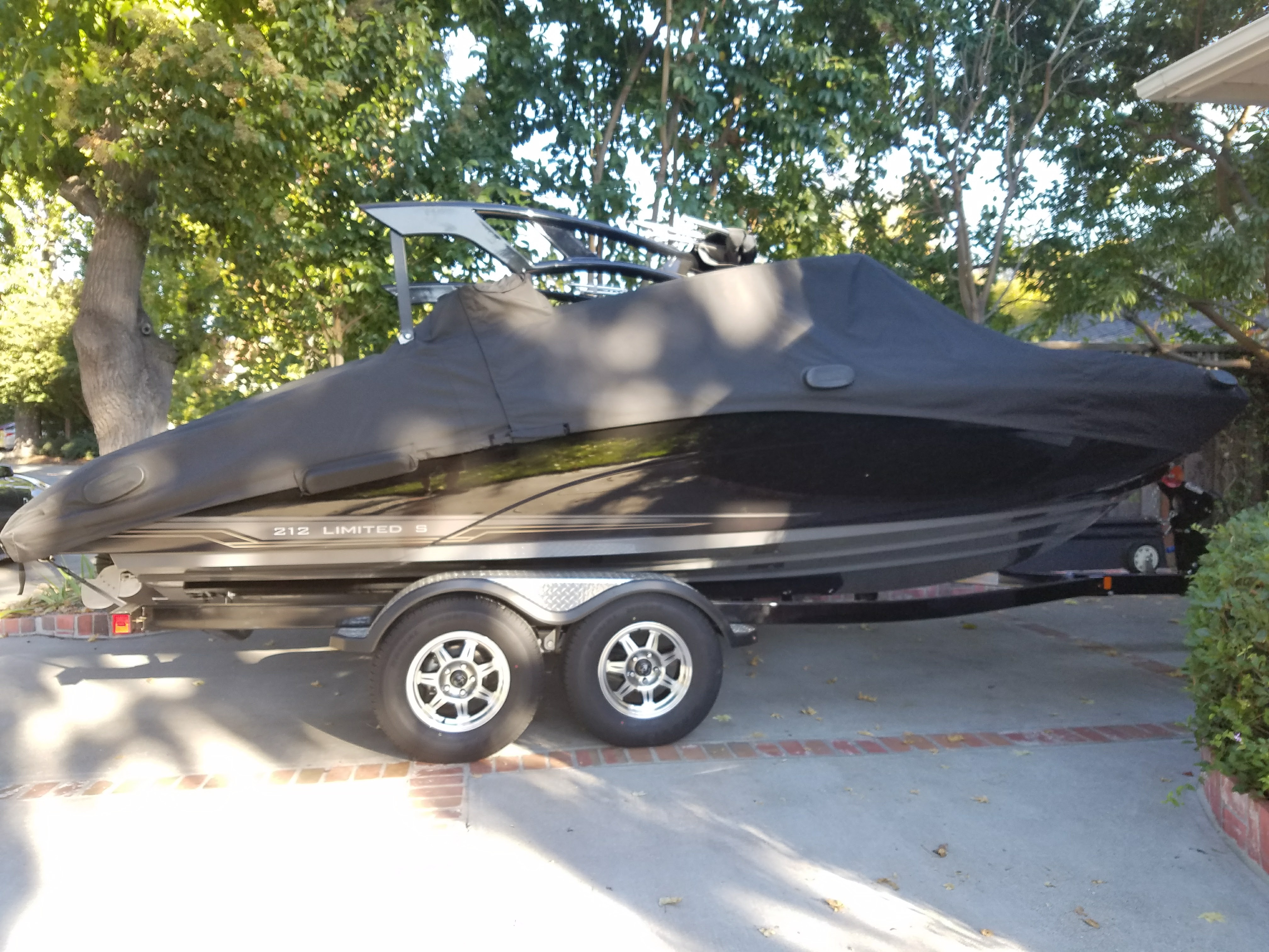

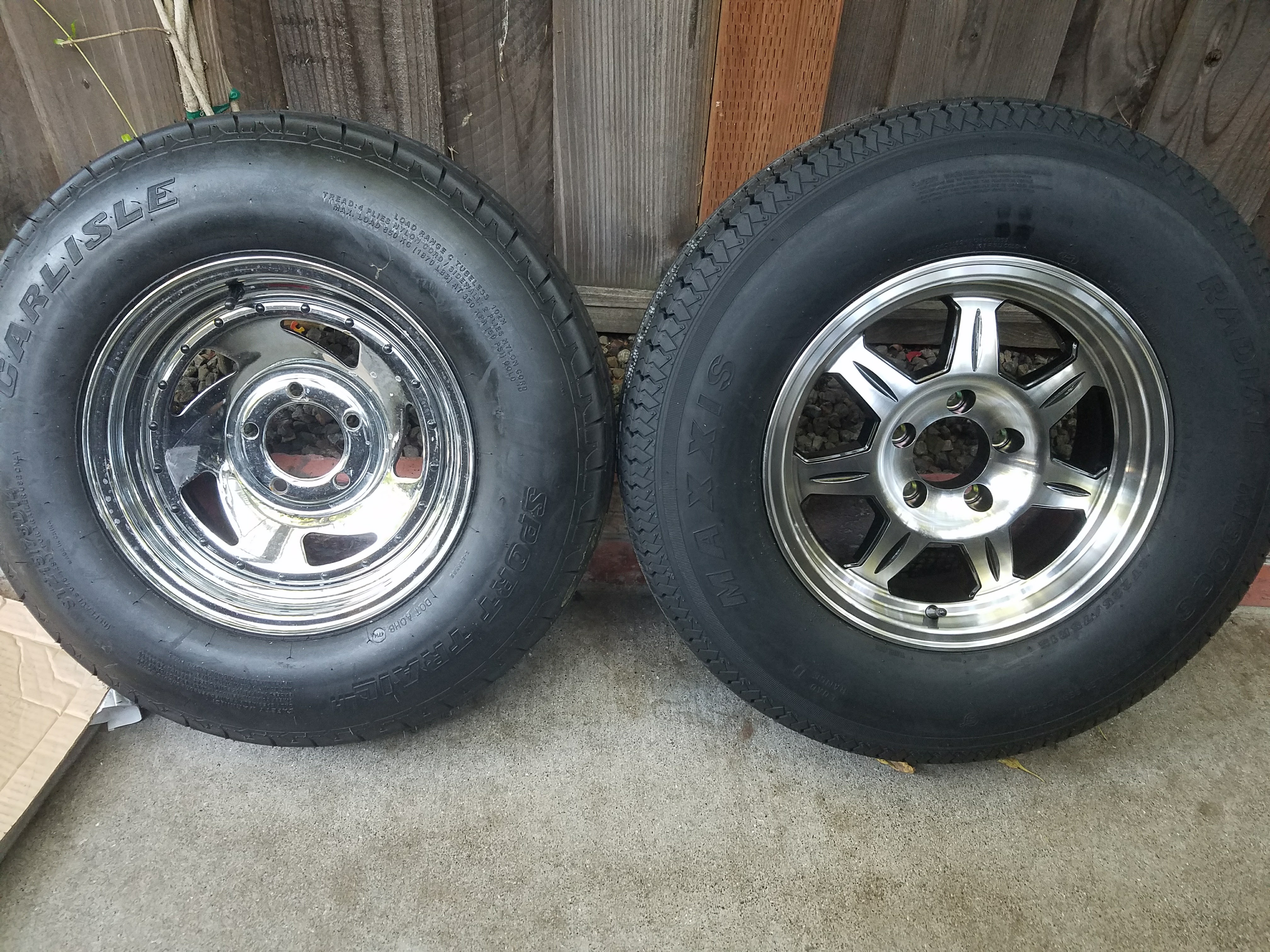

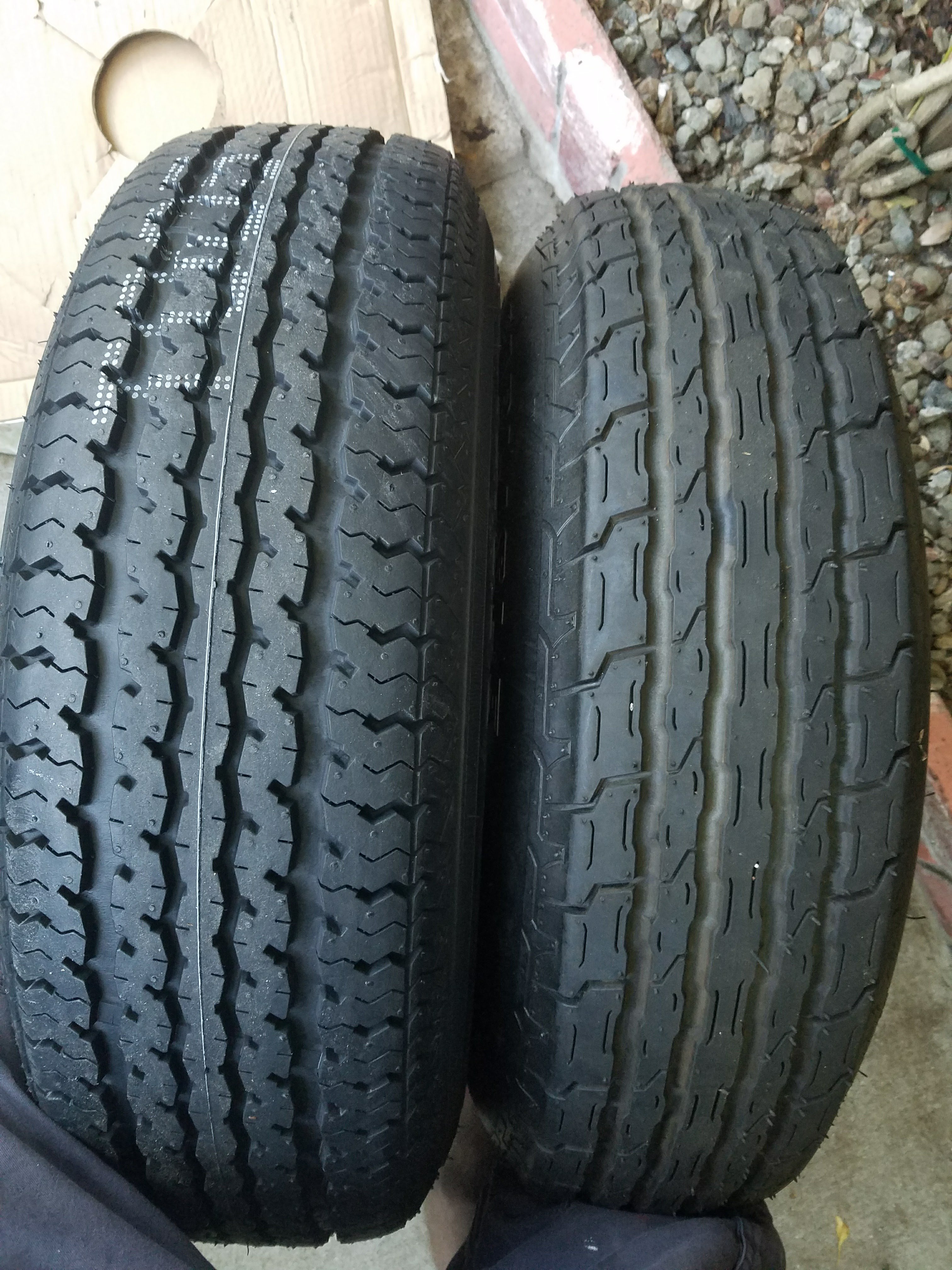

Here's some pics of the wheels and tires I got. I bought them from Onlinetires.com. The guy I dealt with was Leonardo Garcia, a really nice guy that took good care of my order. The original wheels I ordered weren't available, he found some wheels that actually looked better and asked if I wanted to switch the order to them. I did and he had them mounted and balanced before shipping them. I literally unwrapped them when they got to my house and put them on the trailer. Super easy. They cost me a little over $800 including tax and shipping, mounted and balanced with new lugnuts even. The tires I got were Maxxis 8008's, they seem to be THE trailer tire right now. They tow great, fit perfectly and I now don't have to worry about cheap overloaded tires ruining my weekend or trip.
As far as fit, on MY trailer they fit perfectly with no rubbing whatsoever. What I did do though is to cut the extra threads off the two bolts that are directly above the tires though. You can either cut them shorter, or simply flip them over and have the nut and threads on the top side of the fenders instead. The 15's look awesome on these trailers and the particular wheels I ended up with look WAAAAAYYYYYYY better than the cheap stamped steel stock wheels. DO IT! lol.
