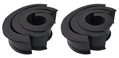

Amazon just arrived with 2 sets of these for me. I found them on another thread. They feel real solid and well built.
I have the powder coated Tower on my boat and I am worried if I secure them down it will damage the blue coating. The screws are not too much longer than what I need. I was thinking some rolled rubber like you put for flashing or on a roof. It is thin and durable, I have some in the garage somewhere, between the tube and stainless steel? Any better suggestions would be more than welcomed.
Also, I was thinking 30 degrees. Is there a standard that individuals use as the norm?

Little piece of weatherstripping or tape insulation first, then the clamp.

Hangoutdoors, how did you make out with the clamps? I'm thinking about getting a set, I'm a little nervous about scratching up the tower though. Where did you source the rubber from? How secure are the rod holders to the tower when using rubber?
Please post some up close pics if able to.

I purchased grayed colored weather stripping from O'Reilly's Auto Parts with the adhesive backing. I first wrapped this around the wake tower about the width of the rod holder mounts on each side. Then to be extra safe I took some black rubber shop shelf liner and cut it to the same width as the weather stripping and placed that over the top of the applied weather stripping foam, securing it into place with two black cable ties.
Then I mounted the rod holders and tightened down the allen screws (snug so the rod holders don't move but only tighten by hand as not to bend the tower metal).
You'll also want to remove the allen screw that allows you to adjust the angle of the holder and put some "Anti-Seize" on it before re-installing. I was able to get this at O'Reilly's as well.
