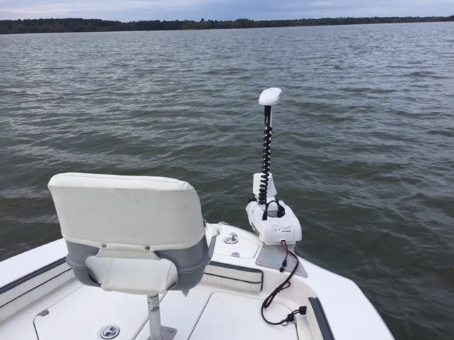

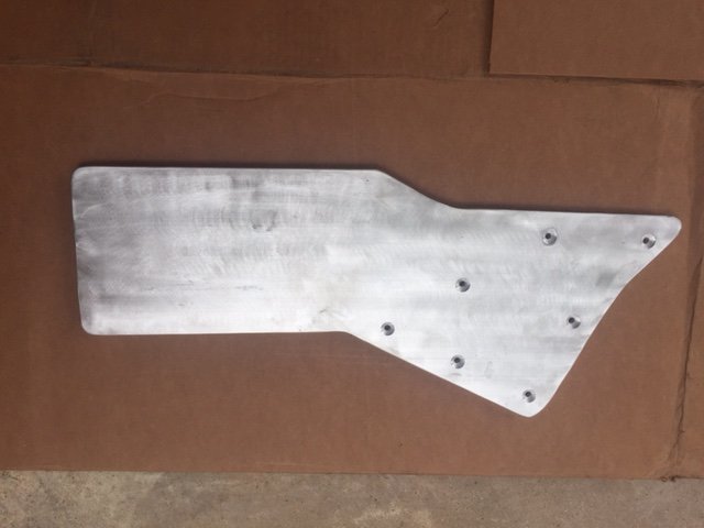

Super late post, but decided to reply just in case anyone new was reading the thread. Made a custom aluminum mount ($250 at local machine shop). Has 7 anchor points, because I pushed it pretty far out so I could get as close to the center line as possible (and still use the anchor locker). It is solid as a rock.

@Brian Filas - Super elegant solution - definitely one of the best I have seen and gets the motor closer to the center line without blocking anchor or front hatch. One of my "design criteria" has been to allow quick removal and use of my standard Yamaha cover. It looks like I could cut and reinforce a slit with this.
Your pictures show how far you have to extend to get past the edge of the boat - this is a challenge that we all have been struggling with. It does look like you could have come a bit more in towards the edge of the boat by a little less angle on the mount but that would move you a little more off the center line. How has your tracking been with this solution?

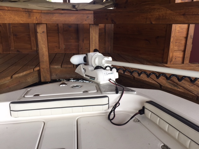

I will snap a few more this weekend for you. A couple of quick comments. @WTScott ..I should have done a starboard mount to offset the weight. She does sit just a little heavy on the port side but my fat ass offsets it as long as i fish from starboard :). You can see in the picture below that the port side tie down bracket touches the water and the Starboard is slight out. I plan on fixing this in the winter by moving my battery charger. Tracking was great (motor head is just slightly off center to keep her running straight). I think this is why folks have issues with the spot lock. If your motor is to far off center it would have a hard time correcting things and I would imagine it would just keep trying to spin you around and course correct. Regarding the standard cover, it still fits. Heated it up to get a little stretch but the mount doesn't really hang over that far (will post some pictures of it on as well). Creating the mounting template took the most time. It took a few pieces of particle board and the help of my two sons to get the dimensions just right (hang over). @CAT Chaser .. Mounting it this way does put a lot of the weight forward so I didnt want to risk using Starboard. The machined aluminum was expensive ($250) but viewed it as an insurance policy that my $1500 motor would not be on the bottom of the bay during some rough chop. The fiberglass up that way is pretty thick so the 7 mounting points have it attached very secure (could probably stand on the end of it). More pictures to come this weekend. Also changed the oil last week and took a few videos of that as well.

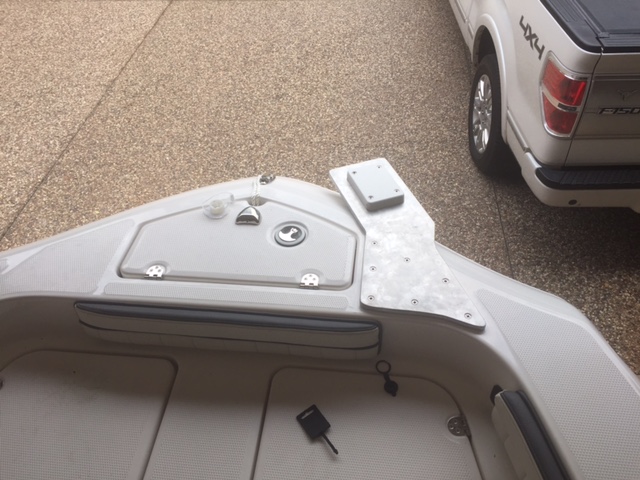

@Billy Marlin @Brian Filas - Got everything installed and on the boat this past week - took the 3 to 4X estimated time but still a lot of fun playing with the boat. The trolling batteries in the changing area nook are still under consideration as I think I did see a loss of a few miles per hour and a little bit more spray on the starboard back seat - could be totally imagined but might have moved the spray line a bit forward. Also, without live well filled and even with Ulterra on starboard side there is still a lean to the port due to 260 pounds of ballast on the port side of the helm.
Brian - The mount worked great although my fab guy was not as good as yours. I am considering a SS model in the future. I love the setup and everything is practically perfect including good tracking but I did cut it about 1/2 inch too close and failed to account for the trolling motor housing overlap over the mount and the anchor hatch just barely catches and will not clear the base (grrrr). In looking back at yours, it looks like you are just clearing as well. I am going to shift the puck over 1/2 inch for now - won't be as pretty but will work. Pictures are attached.
