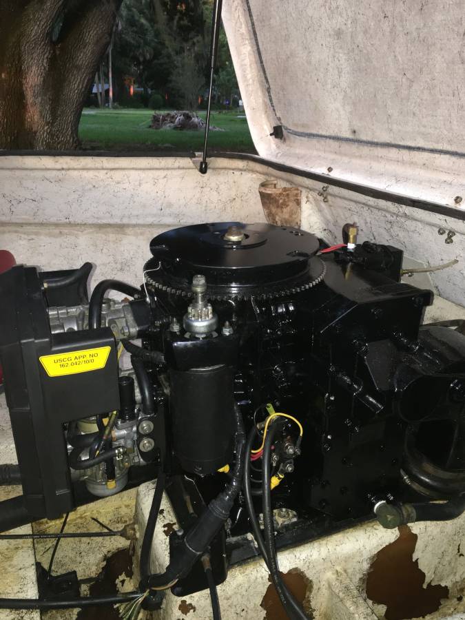

I just bought a 1995 Hobie Jet fisherman with the 90 HP Sport Jet and I am working to get it running and cleaned up.
Here are a few pictures
So far I can get it started and idling rev up a little.
I have checked and adjusted the timing and synchronized the carbs.
The starter needed to have the Bendix greased and the solenoid rewired.
I have pulled the carbs for cleaning and found a few drops of water in the #2 carb and when I spilled the contents of the #3 carb I saw a good bit of water in the gasoline on the bench.
The carbs have the new style floats that are nor adjustable and do not have the clearance for the main jets.

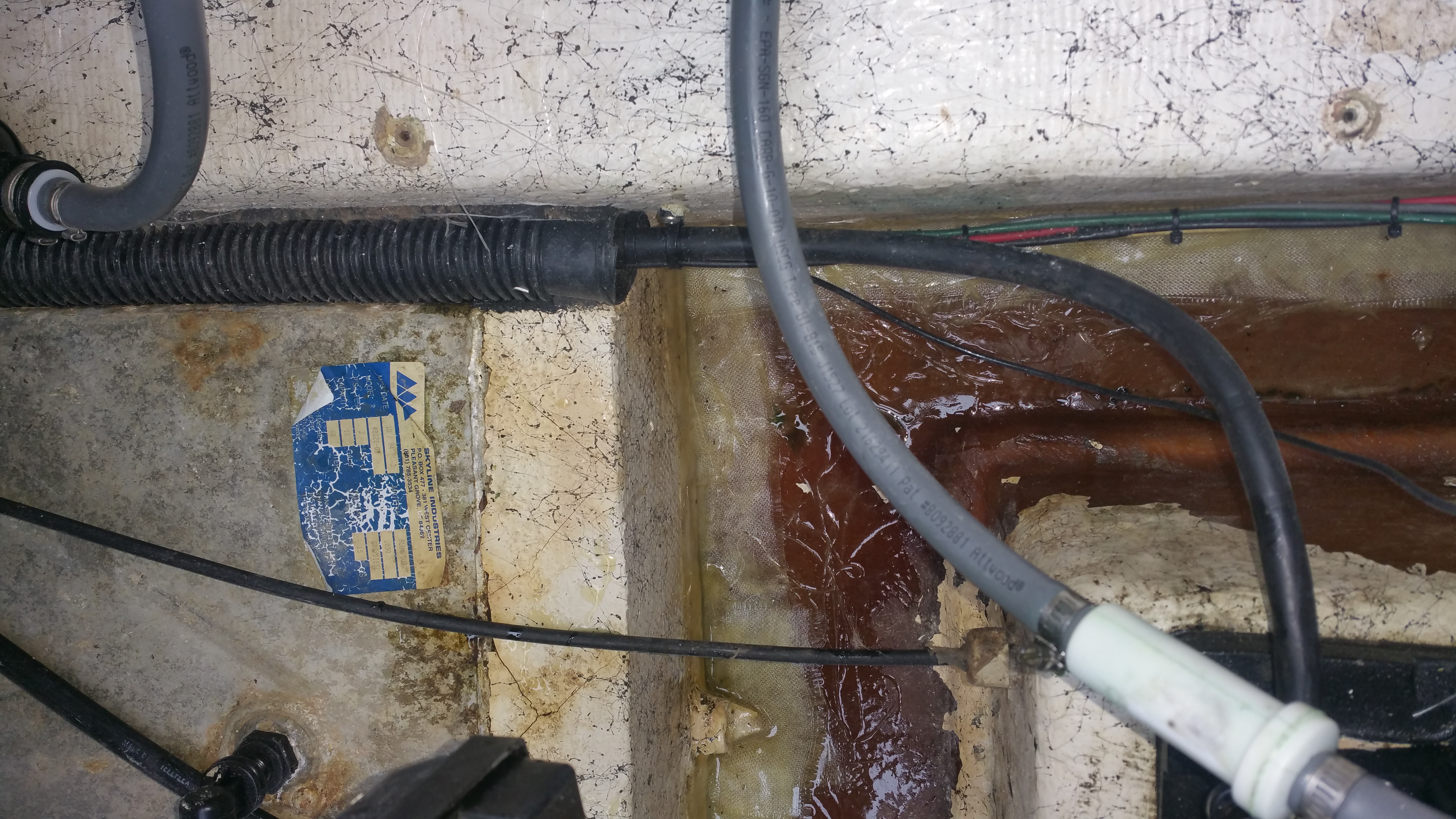

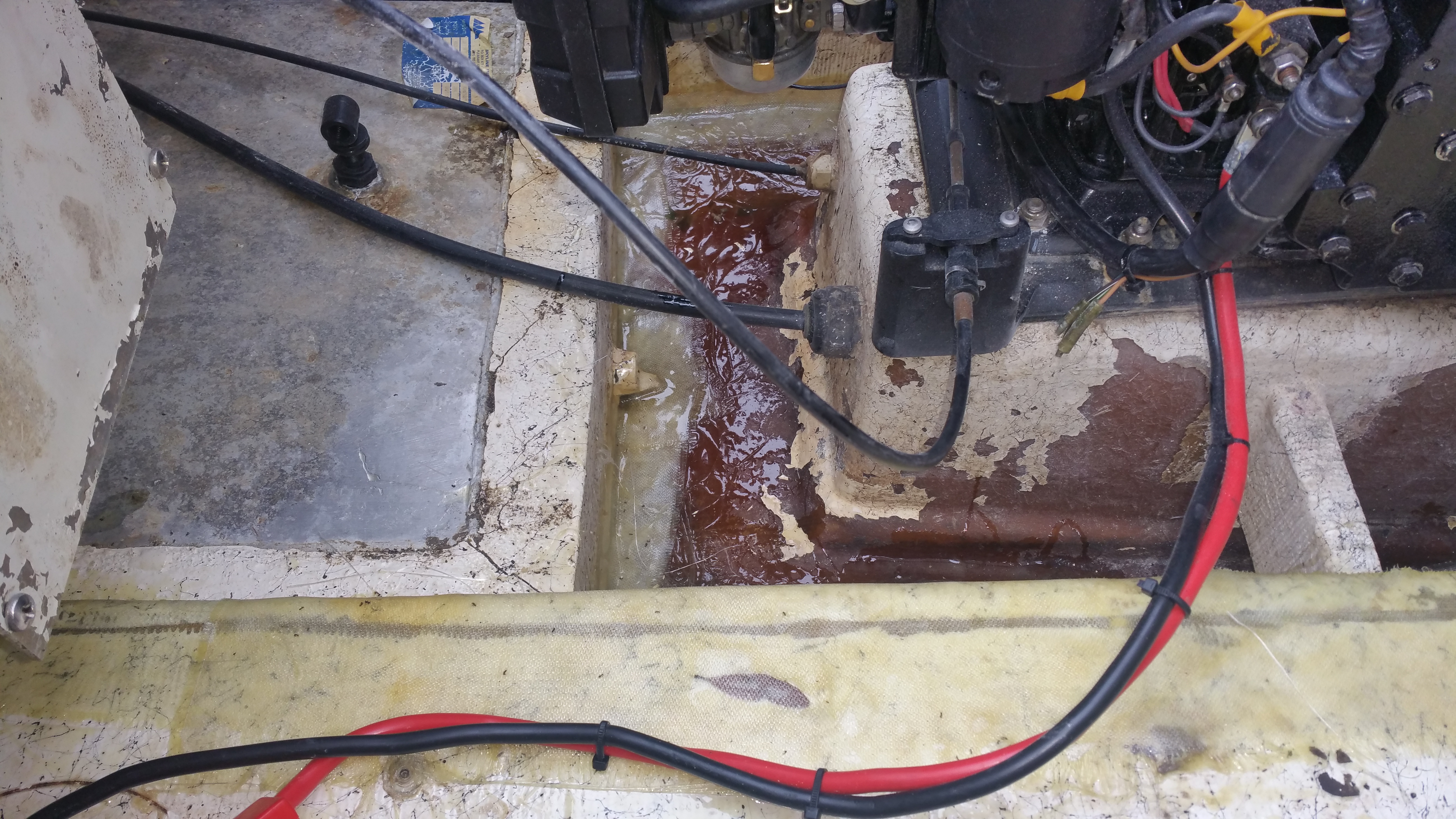

Also I have decided that this boat is heavy riding lower in the water than it should.
In the rear on both sides there are large square chambers most probably for flotation and they seem to have been glassed in with polyester mat. This mat has separated from the epoxy hull (probably because the mold release was not cleaned completely)
These have listed and the bilge water is under it. If my suspicions are correct the foam within is saturated and needs to be removed.
My plan is to take a vibrating saw and cut that loose "flange" off and clean it up and reglass it with epoxy and cloth as it should have been in the first place.
Before that I plan to cut the top off (square) and pull out and replace the foam. While I am in there I will glass the seams again with cloth and epoxy to make sure it is sealed. Then after refilling glass the top back on.

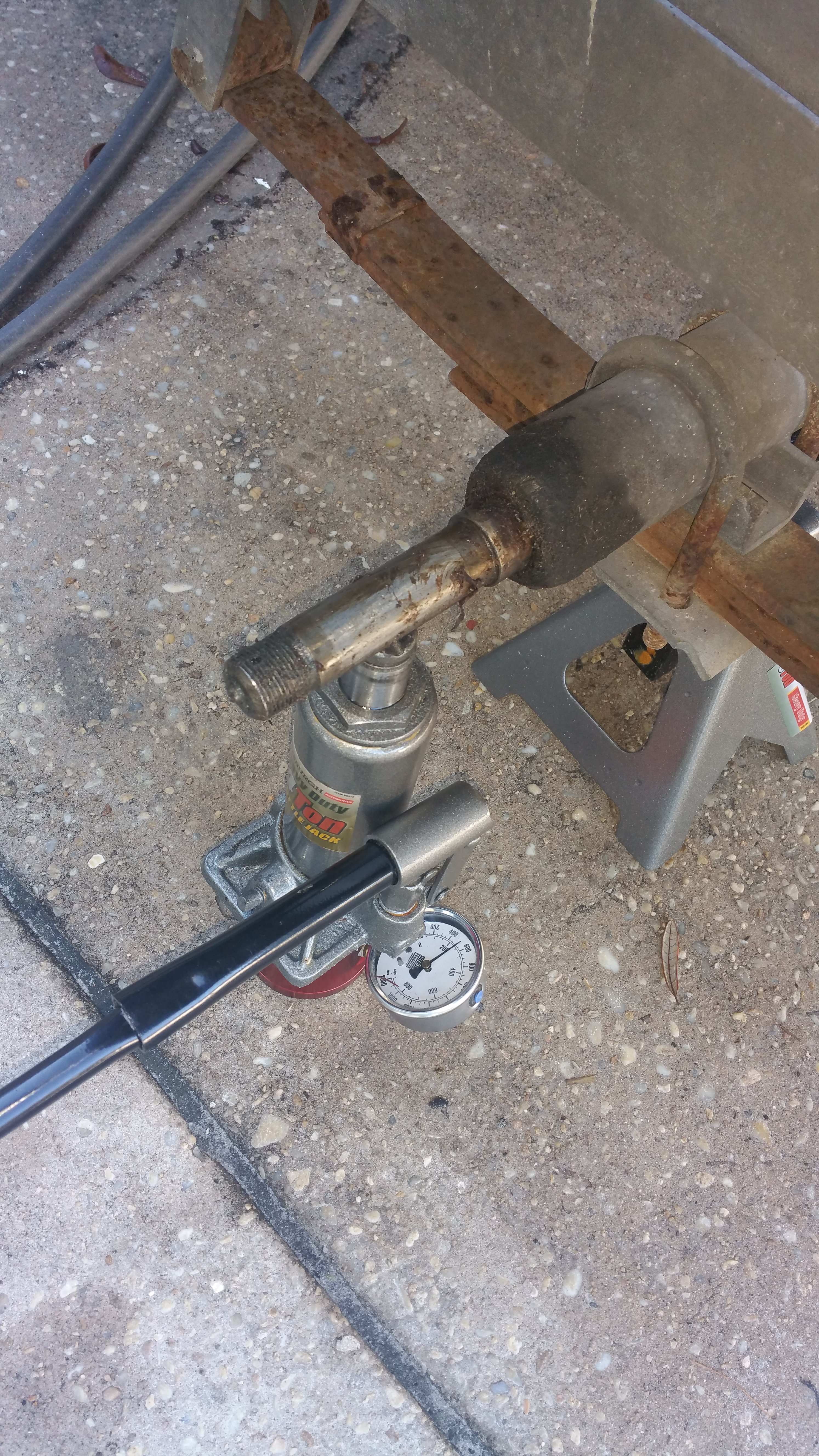

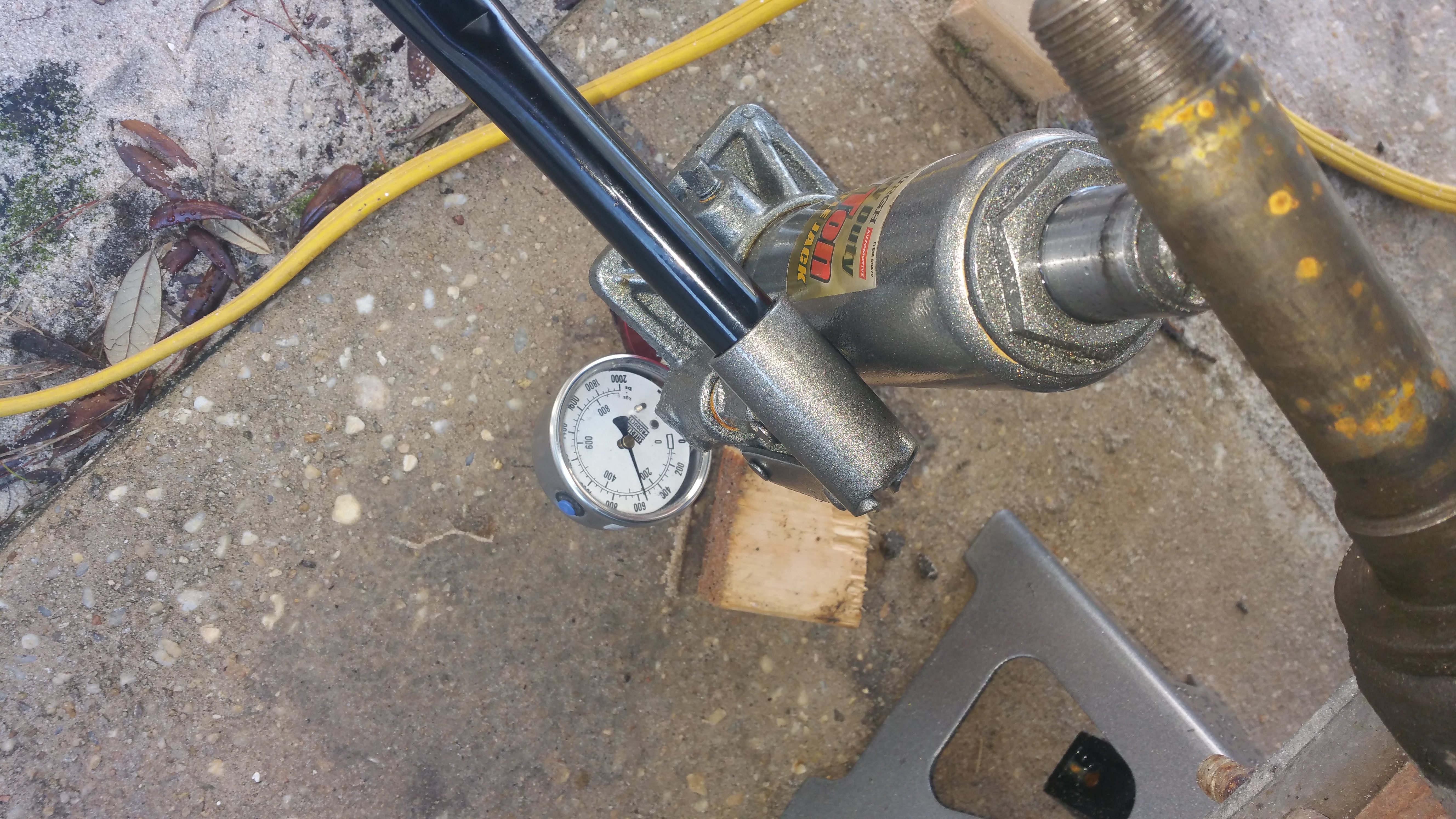

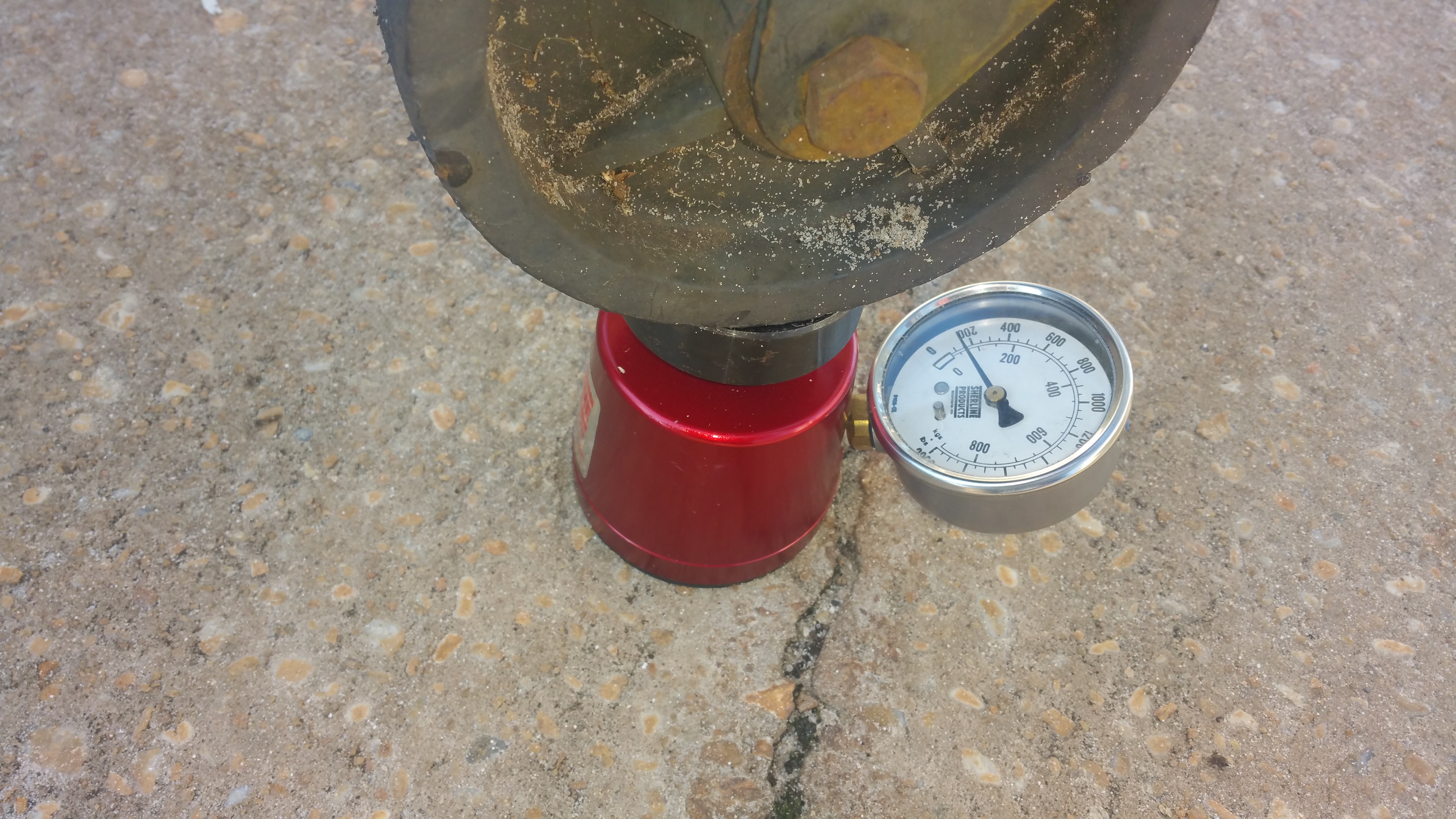

I got out and weighed the boat and trailer and got the following numbers:
Right axle 540
Left Axle 550
tongue -175lbs
So right - 545
Left - 550
Tongue - 175
wheels 70
Hubs 14
Total 1354
If the boat weight 875 then the trailer must weigh 479.
Maybe the boat is not waterlogged or my scale is way off.
I tested the scale pretty close by standing on it and it might have been a few lbs light. If my calculations are light maybe 4%. If this correction is correct then the total weight would be 1409 lbs.
The original estimate was 875 boat plus 600 trailer for 1475 lbs so 1409 is not far off the estimate.
It all depends on the weight of the trailer in real life.

You are right, but the question is the accuracy of my scales and the problem of getting the boat off the trailer to get a tare weight.
As to the lever arms etc you have a point, but the trailer was on jack stands under the axle and the tongue wheel a plane defined by three points.
I just barely lifted the axle off each jack in turn and the tongue at the same height as static so the lever arms are not an issue here.
I might be able to jack the boat off the trailer when I think about the problem some and at least get a proportional weight. if I can get one weight then if I can take the whole thing to the scale I can calculate pretty closely.
However I think that this gives me a little relief on the boat being waterlogged!!
By the way this included a 6 gallon fuel tank full so about 36 lbs there.
If the scales were to read 10% light the weight would be 1622 lbs - 36 for the gas - 1586 lbs.
It all comes down to finding the actual the weight of the trailer.
I found the weight of the trailer listed as 400 lbs by Advantage Trailer Company, so if that is right then the total weight of 1409 - 400 leaves 1009 for a weight of the boat - 36 lbs for the gas = 973 lbs which would mean an added water weight of about 100 lbs.
So I think investigation of the rear flotation boxes might well be in order.
If the scales are right and the total is 1354 then - 400 = 954 -63 = 918 - 875 = only 43 lbs additional weight.
Can't be so lucky!

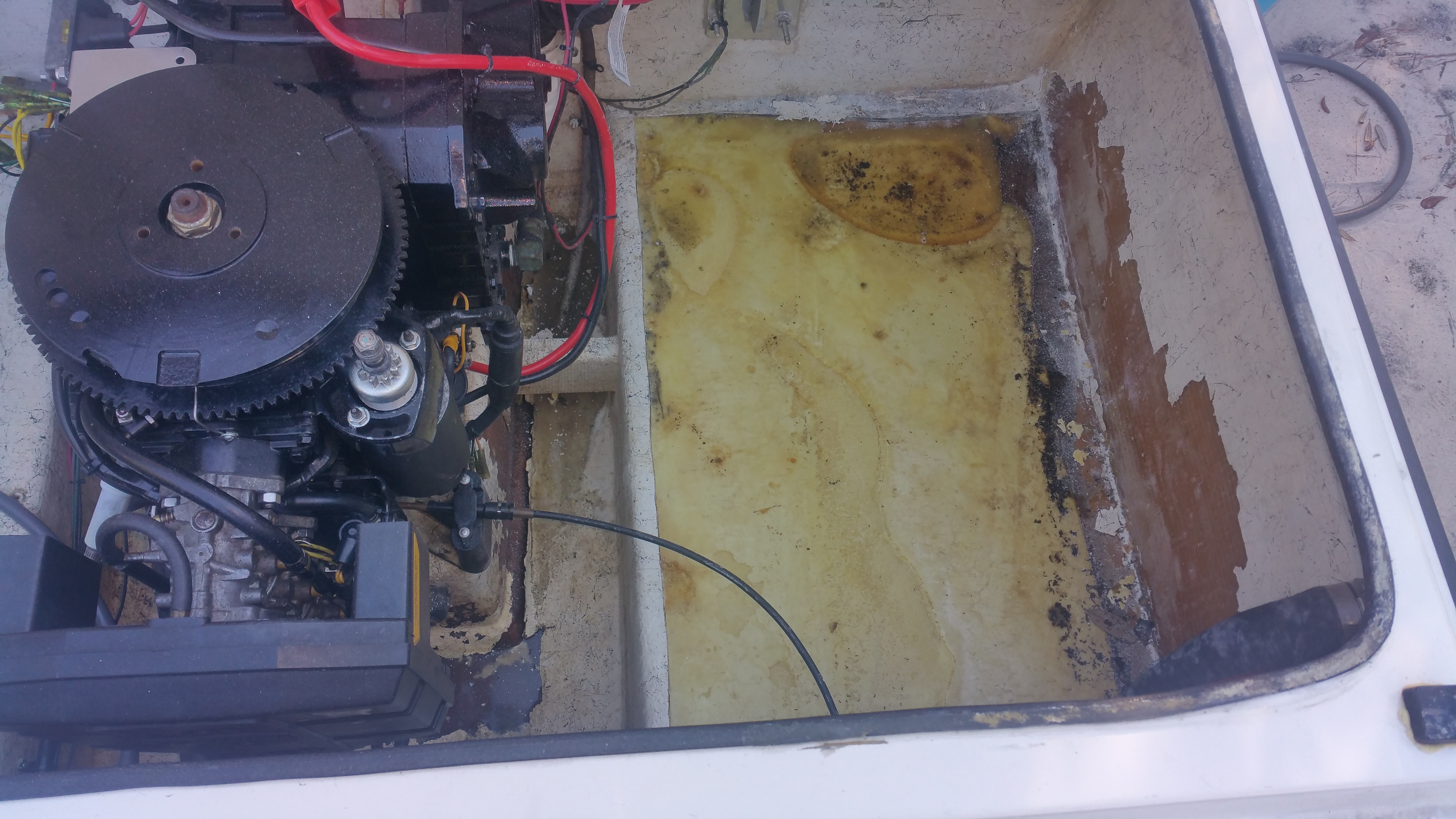

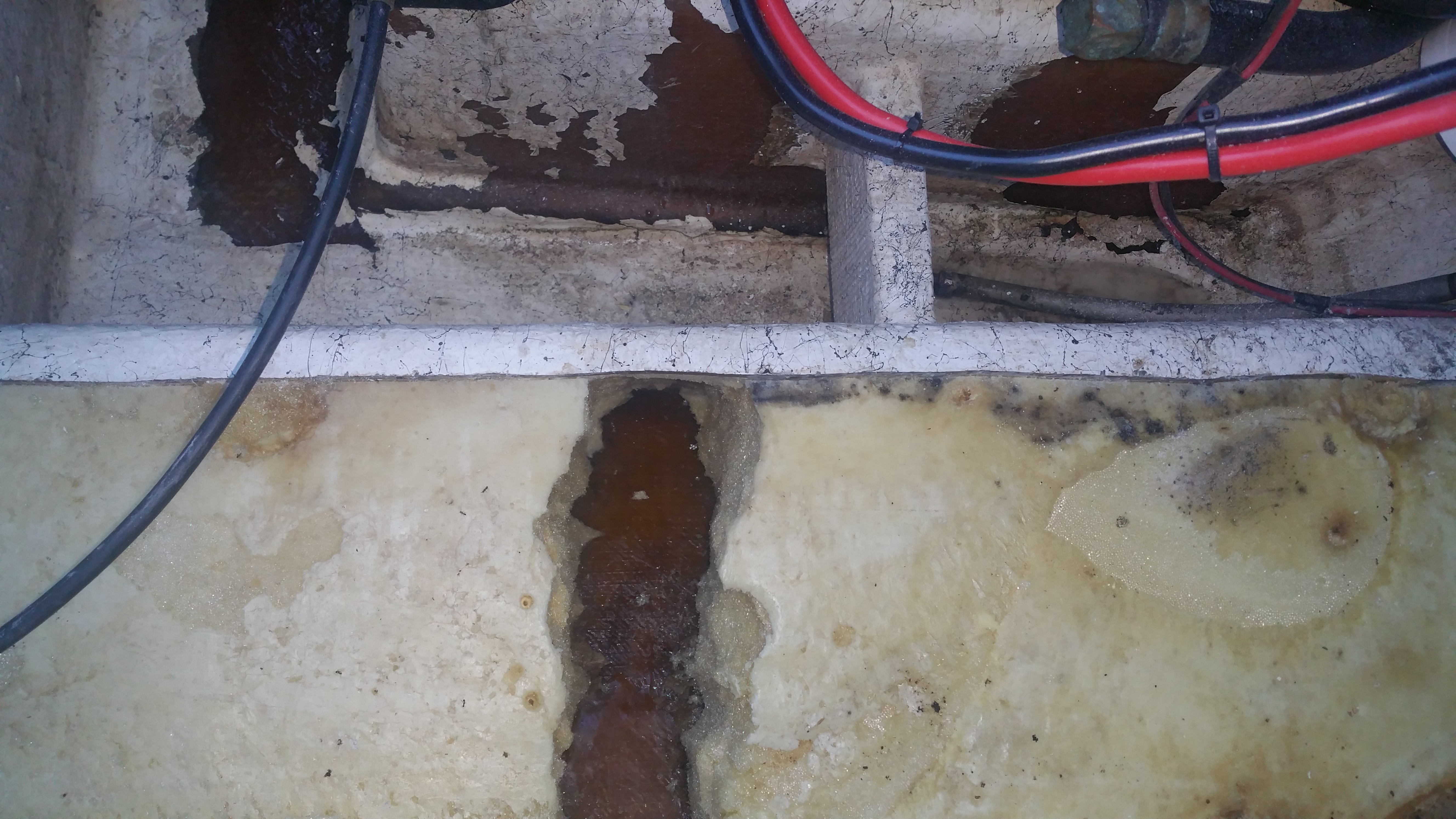

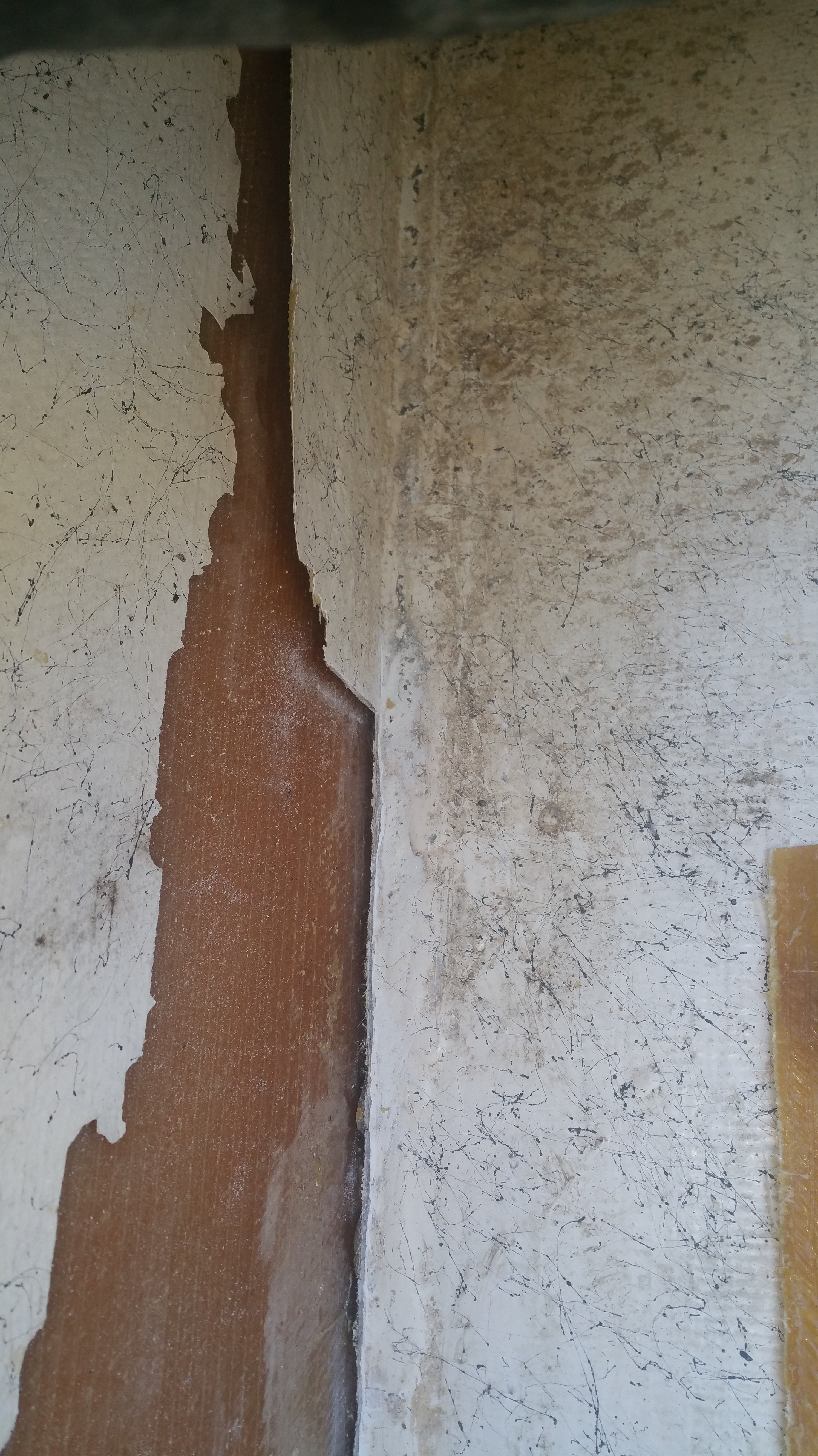

Here is a picture of the tabbing that seals the flotation boxes and holds them in.
The polyester has pulled loose from the hull all the way around and I think I am going to cut the tab as above all the way around and then pull the whole thing out if I can. I have to assume that the foam is a block and the box was installed over it.
The reinstall will be a matter of either cutting access holes in the top or just cut the top off as I said.
When I bought the boat there were about a billion, trillion ants living in this space and the area was wet.
I don't see how the foam could not be soaked

I cut the top off the box and the foam is intact, but it is wet on the top since it would have to be since the edge has been open for a while.
I can press down with my thumb and feel some moisture in some, but not all places.
My ohm meter reads about 4 meg ohms when pressed into the foam where is is is damp.
I think that perhaps a pair of welding rods pushed all the way down to the bottom will let me track the resistance from the top to the bottom of the foam.
Or is there a good way to cut a core sample or just dig it all out and start over.

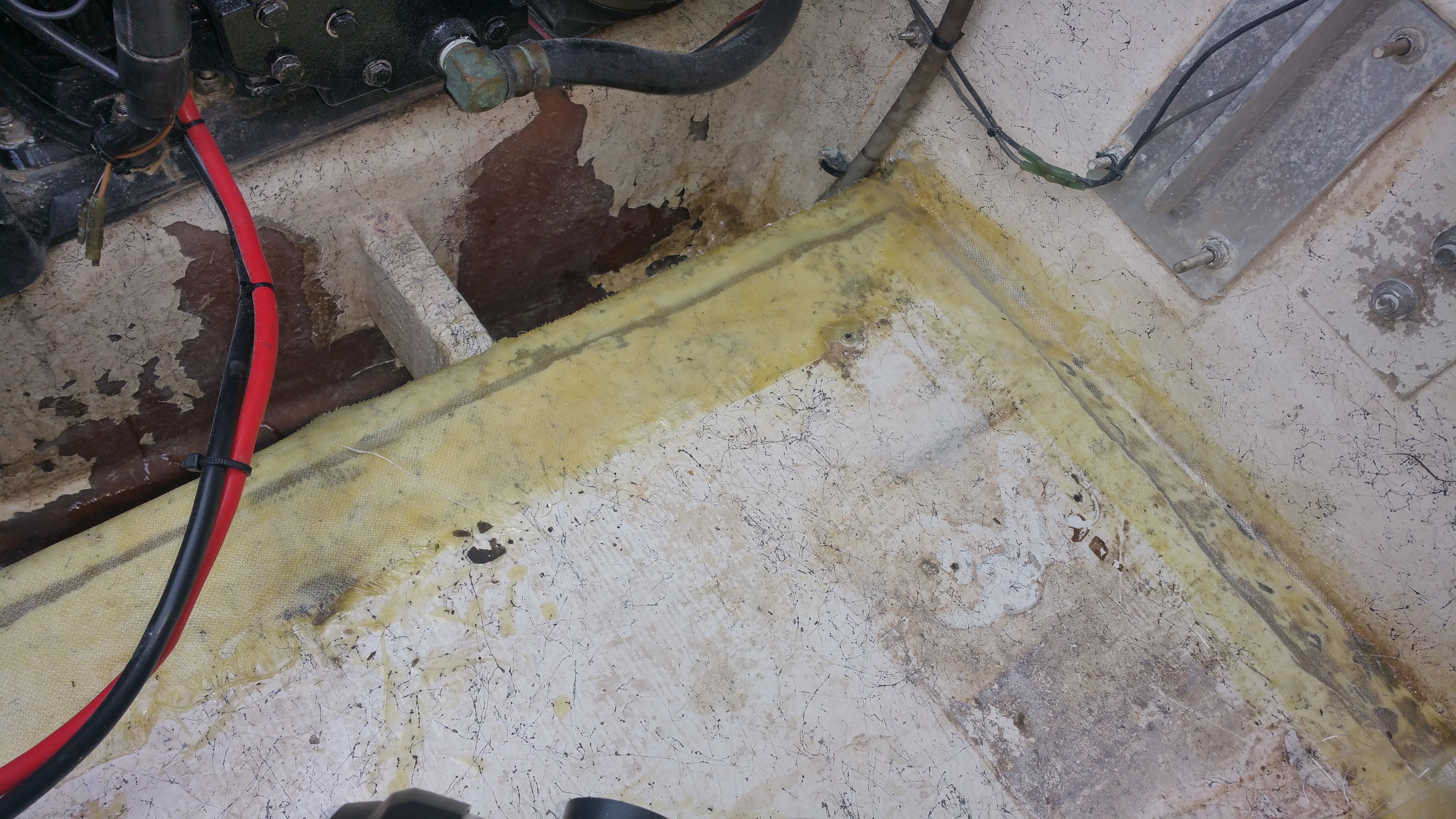

Today it was warm enough to do some fiberglassing and I bonded the flotation boxes to the bottom and sides andthe spot under tha gas tank.
While I was at it I also sealed the bottom of the anchor storage well in the front with fabric and epoxy.
I used epoxy because I had about a gallon of resin (A+B) and the polyester and gel coad did not stick well at all.
I think that exposure to water did that in.
I have fixed two helicoils that were not installed correctly and stuck out from the engine surface and would have kept the exhaust manifold from mating correctly with the block.
I hope that this will fix the problem of getting water in the #3 cylinder.
One thing that might also help is to move the battery under the console (and installing another for the trolling motor too)
and putting the 16 gallon built in gas tank back in service and removing the 6 gallon Attwood.
I think that the fore aft trim needs to have the weight shifted forward to get the draft less and more clearance for the waterline and exhaust elbow.
I will try to post some more pictures later.
By the way, does anyone have experience with moving the battery forward and it's effect on the boat?

Here are the pictures of the patching I did to repair the peeled off Polyester and gelcoat.
The peeling let water get into the flotation boxes and under the floor.
I cut the loose fiberglass "flange" off and sanded, cleaned ans tabbed it with fiberglass fabric and epoxy resin.
The bilge and the anchor storage hatch were loose and I could see water running back and forth.
I propped the front of the boat up for days and also used the wet or dry shop vac to pull the water that drained to the rear out and also used it to suck what was trapped under the foam out.
I found that when I cut off the flanges the water ran out better and the foam on the box on the right dried out where it was damp on the bottom.
I "Assumed" that the same thing happened under the floor when no more water could be drawn out from under.
Here are some pictures of the bilge.
