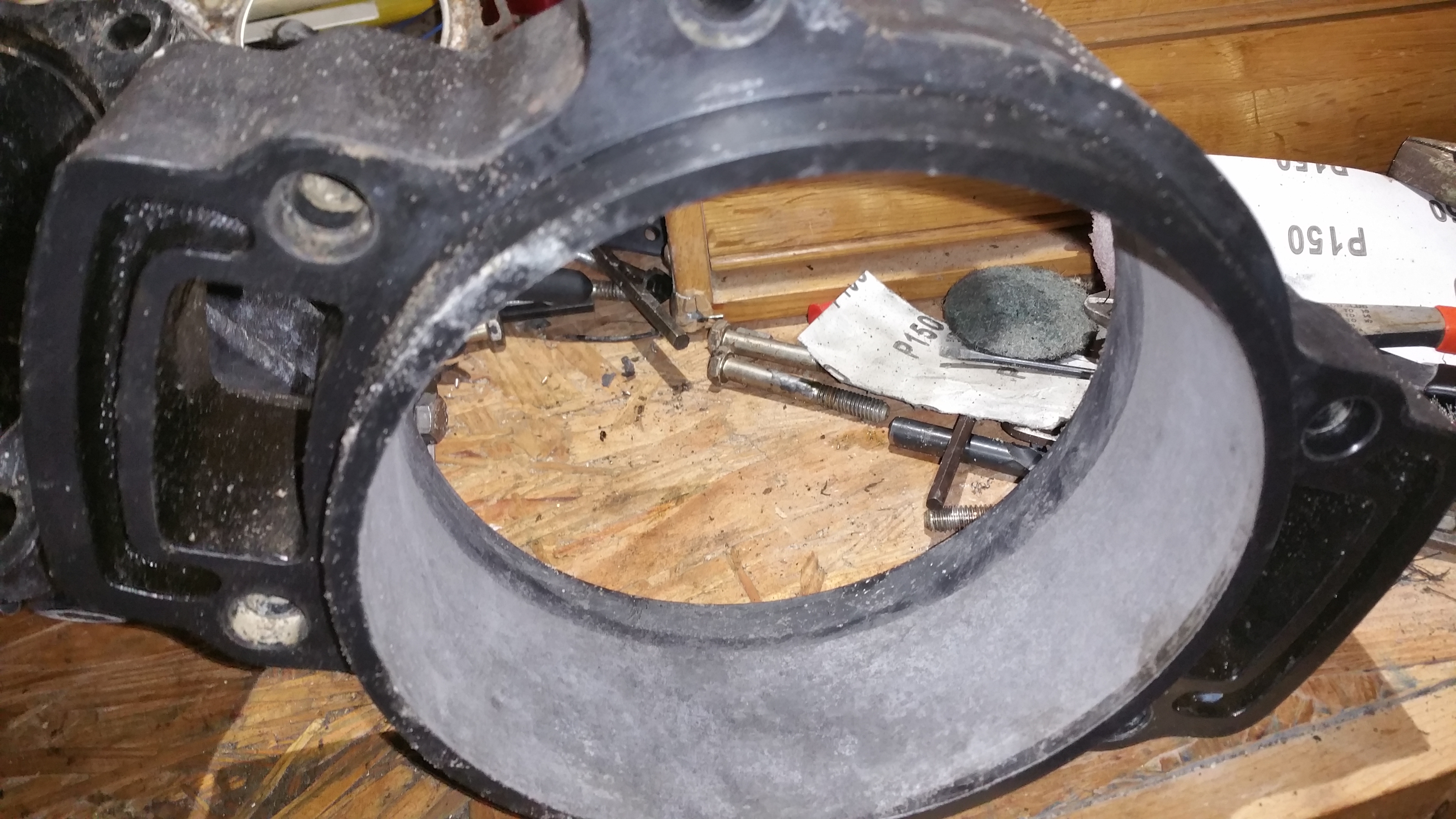

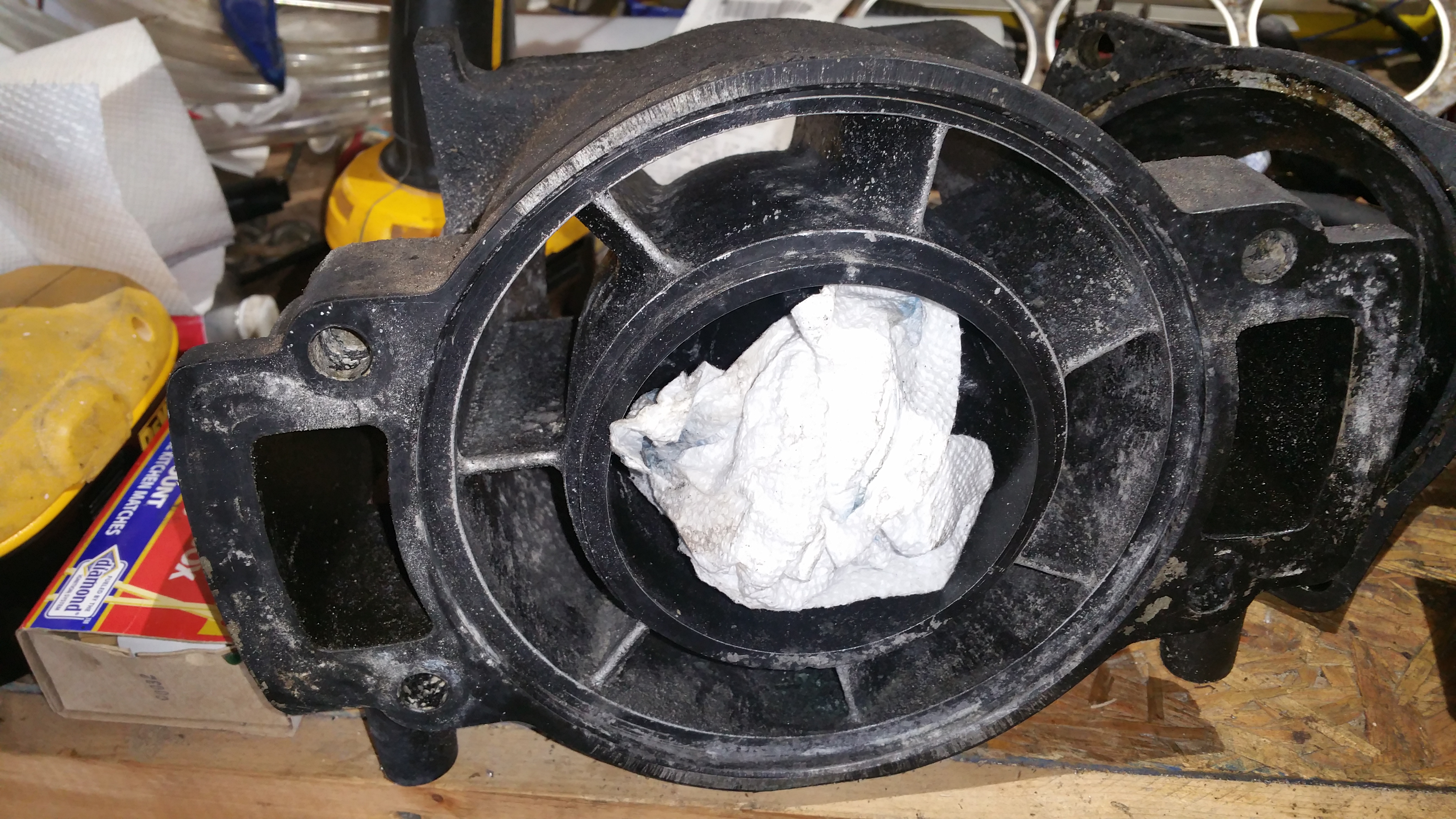

While working I decided to pull the pump and inspect. In doing this I wrung off one of the pivot bolts on the bucket and now I have to wait on the replacement and get the remaining bolt out of the housing too.

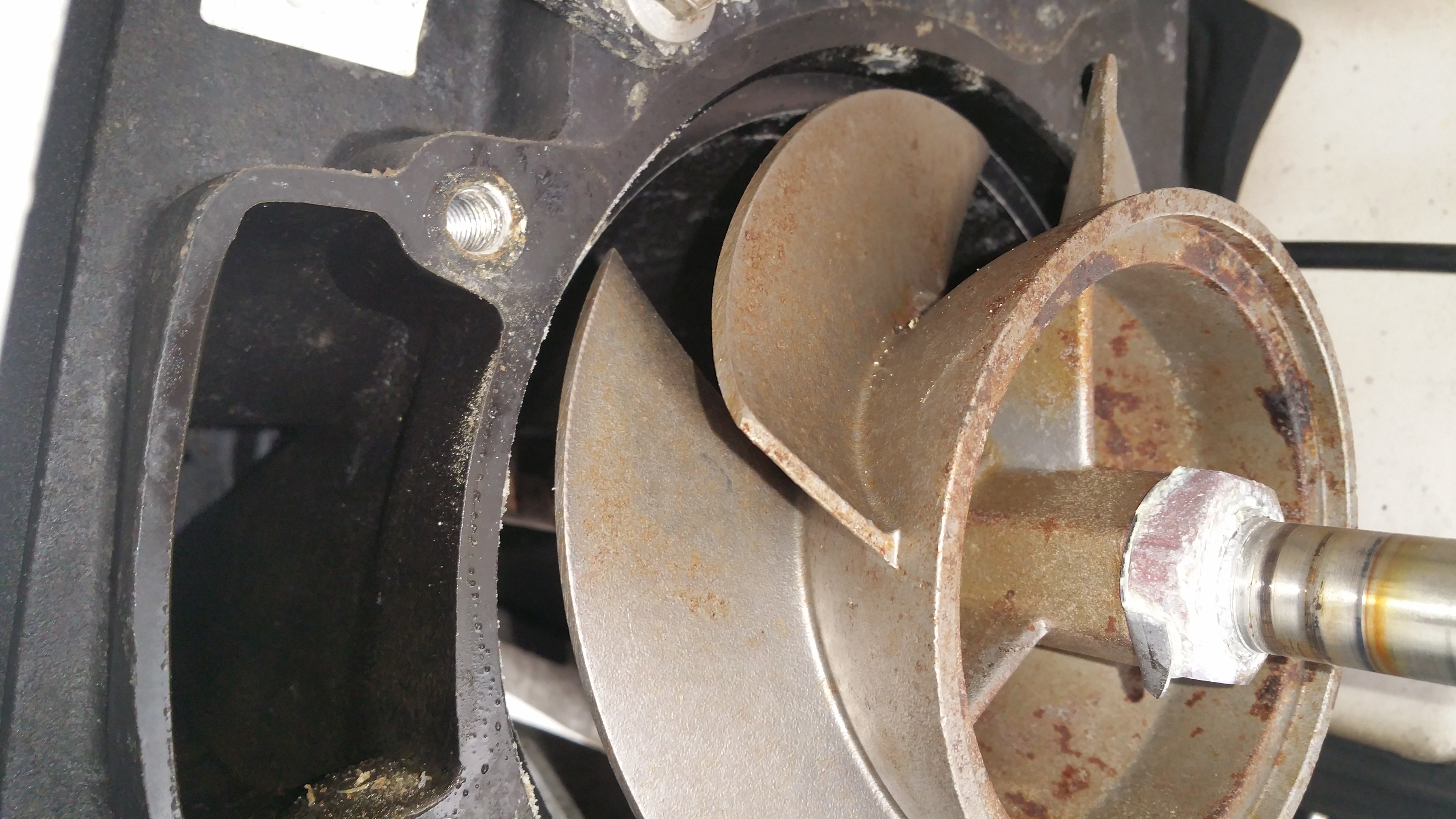

I went ahead and pulled the rest of the pump and found the impeller and wear ring in like new condition with no pitting, scratches or anything. The only thing was some small amount of surface corrosion.

Should I paint the ID of the wear ring when I have finished cleaning it up?
A fairly heavy coat of black epoxy might protect the bare aluminum and build up the surface slightly.
Any thoughts? Anything else I should do while I have everything apart?
Is there any advantage in smoothing out the steering nozzle, it seems to be a little rough inside?
I think I will wait until I get the nozzle reinstalled to install the brand new Cobra Jet Steering rudders so I can make more certain I get them straight.
