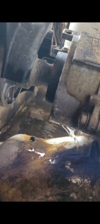

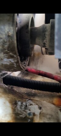

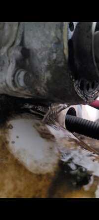

Leak at the port engine jet unit. Anyone dealt with this? See pics. TIA

Steady trickle of water coming in. Any thoughts? Have video as well but can't figure out how to post it. Screenshot_20250716_150439_Gallery.jpgScreenshot_20250716_150609_Gallery.jpg

Your intermediate bearing is bad. Definitely don’t need a video to tell me that! I’m sure it would scare you with how much water is gushing in when you’re cruising. Pretty easy to replace if you have some tools and know someone with a 20 ton press. Below is a link when I did it:
My intermediate bearing replacement
Hot dog. Thanks for the information!
