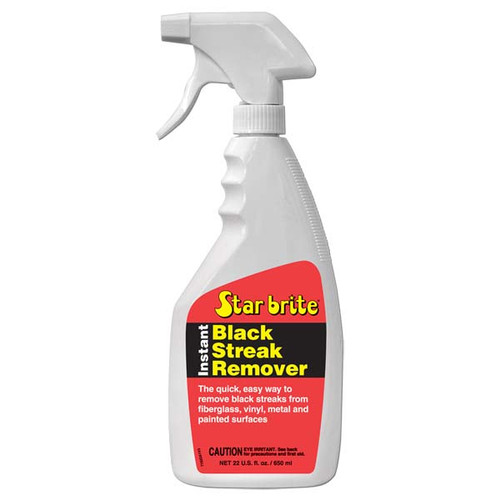

And for those black streaks.
These work well also. FSR is what we used to clean up the sailboat. You may need to paint the springs.

Just chiming in. Swatski is right. Oxalic acid is the trick. Toilet bowl cleaner, Starbrite Hull Cleaner, Barkeepers....all active ingredient Oxalic acid. The bulk bag has lasted me 12 seasons as I have to clean lake scum and stains ever so often. Mix 1-2 cups of the bulk oxalic acid with warm water in pump sprayer, put some dishwasher soap for surfactant, spray on, let sit 15 minutes and rinse off. Stains gone. As with anything gloves and eye protection needed. BTW....Oxalic acid also main ingredient for deck wash.
