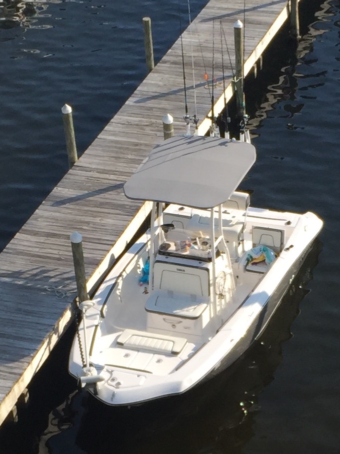

I got the 7 rod / spreader light combo from Stryker T-Tops. I had it powder coated locally to match the stock T-Top. If you do decide to order it, take note that the clamps they use is for a 2" rail. They were kind enough to send out another type of clamp, however it was still too large. I ended up cutting a custom insert for the 2nd set of clamps they sent using PVC lumber. It actually turned out great, and if you want I can send you the template. I also purchased a white nav/anchor light from Academy and added it to the rocket launcher as well. I ended up drilling holes in the t-top to wire it more"permanently", but added quick disconnects to allow for top removal if necessary. I took it out the other day in 2-3' seas in the open and moderate chop in the bay with 7 rods on it and it had 0 issues. Overall, the quality and value of the Stryker Rocket Launcher makes it worth the extra work vs. spending the extra money on the JBP version, plus you get 3 extra rod holders. I will try to get pictures, the boat is in storage right now. If you do go with Stryker, let them know you talked with me, and maybe we can get them to come out with a professional product to mount their launchers to the Yamaha top.
Attached is a poor quality shot with the rocket launcher and the trolling motor / mount.
