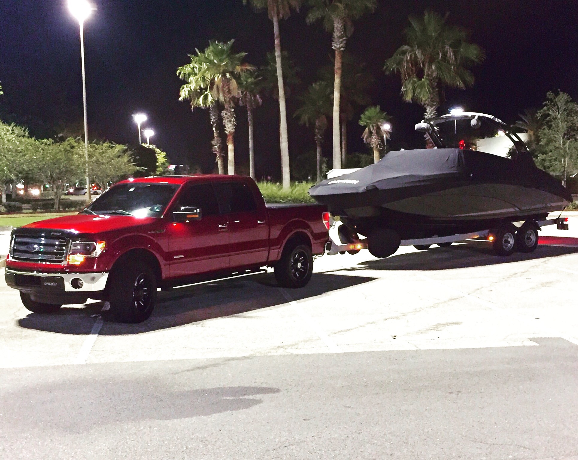

@Pete I have just about the same truck and boat as in weight as you. Your boat fully loaded should barely be over 5000 lbs
The factory trailers that come with are boats are not made to attach a WDH because of the sliding break release tounge they have. I towed a 8,500 trailer trailer I use to own with my same truck - then I used a wdh with sway control. If our boats were more boxy like a camper trailer where wind could catch then yes I would suggest a wdh with sway control. I tow a few hours to the beach and hardly know it's back there.
I think You will get a better value installing in airbags in your truck as I did instead..... airbags will keep your truck from squatting and take out some of the stress from the back of the truck frame. Ford will recommend wdh because of the soft suspension they put in these trucks and keep the truck from squatting so much. When the truck squats you have less front end control amd less braking power because the front end is lifted.
Trust me, you not going to brake your hitch or frame on your truck with these boats.

Thanks Benny for the post! I have decided to quit worrying about it. I am researching air bags now to help it level out and I did get a good hitch that allows me to level out the boat trailer. I am moving to Alabama this summer so I'll have a great opportunity to see how it tows on a 7 hour drive.
