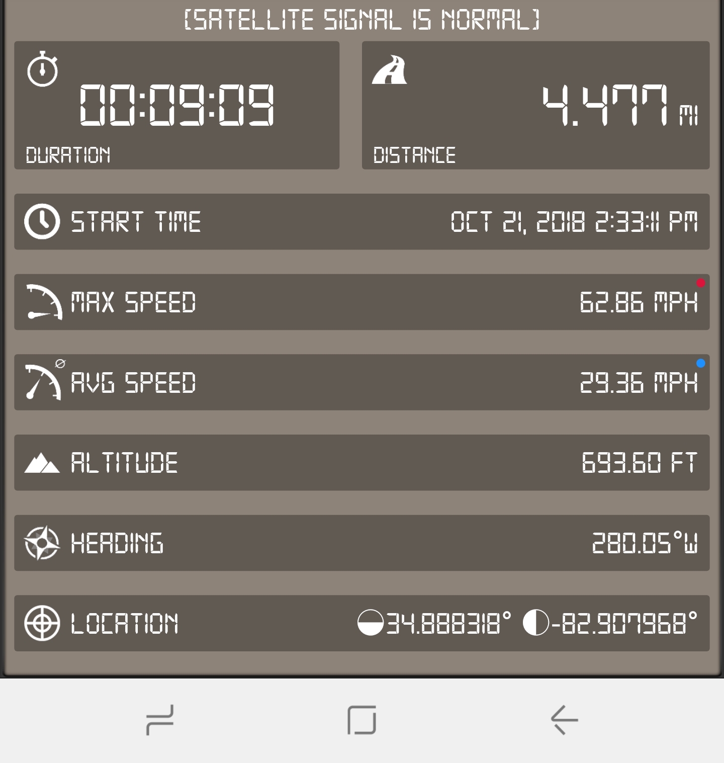

62.86 mph @ 8550 rpm. Half fuel, 1 adult and 1 child. Air temp 57, water temp 80. It feels like it's at the safe limit of the hull. I've never experienced chine walk, but right before I backed off it started a side to side bounce/lean. I would be really surprised if this hull could go any faster and maintain stability.

On this run, GPS was showing 61.9 mph. I was about to back off, but figured bumping the trim up a little more wouldn't hurt. As soon as I bumped the trim, it started the side to side bounce. After we slowed down the GPS showed the 62.86 max. It must have lifted the nose and picked up speed then lost stability with more of the hull out of the water. I don't know what happened, but I'm not going to push the trim too high again at those speeds.
