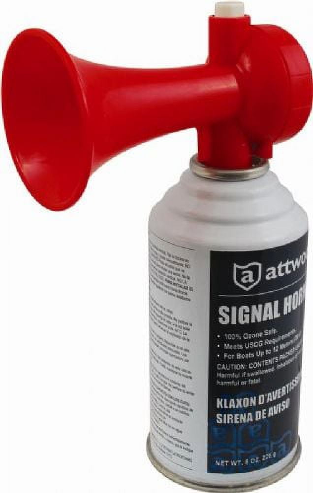

I dont use the horn much, the sound is weak. I keep one of these or similar at the helm. Lasted years as an approved sounding device.
