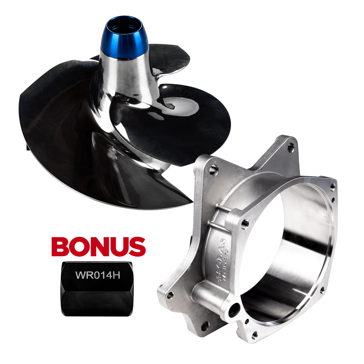

After conducting thorough research, I have concluded that my power reduction issues are likely due to a damaged impeller or pump liner. This year, I have experienced a loss of 10 MPH in top speed, with the boat now topping out at 38-39 MPH with only one person on board. Despite multiple visits to the dealership, they have been unable to diagnose the issue and were reluctant to remove the impeller for inspection without a replacement available. There appears to be a significant shortage of these parts from the factory, so I have been considering the product linked below.
I reached out to Worx Racing but was informed that they do not have a cross-reference chart for boats. While I am confident that the impeller is correct, I am uncertain about the pump liner. Any assistance would be greatly appreciated.
