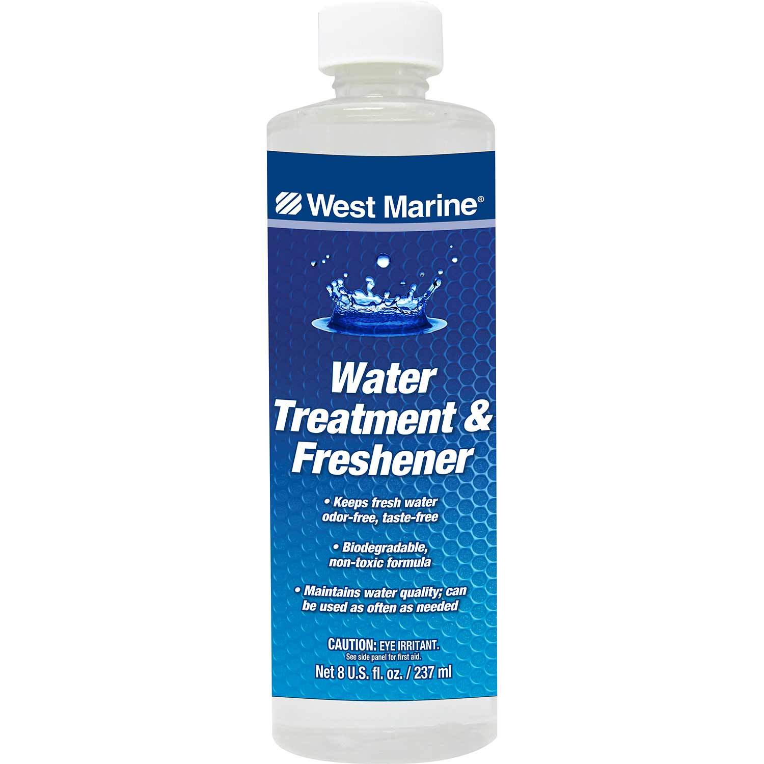

Sidebar question on the shower: Is anyone treating the shower water to control any bacterial growth?
Yes I got some stuff from west marine
I think exactly that.
I bought these on amazon but it was a pain getting them in the tank.
just pour it in the end your garden hose before you attach it and fill up
