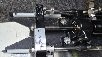

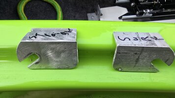

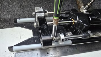

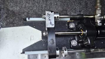

Ok as promised this is my quick chang from surf to cruiseing / top speed / long distance boat rides. It consists 2 angle aluminum spacers and 4 aluminum rod clamps. As you take the starboard spacers out you slide the steering cable back and reposition the inner rod clamp. The outer is just a stop. This will push the starboard nozzle inward.
On the port side you loosen the rod clamp and add the spacer. This pulls the port side inward...
Issue if you need to be able to surf both sides every time out. You have to ditch the keel rudder.
In my situation I'm the only surfer so I put the rudder linkage on the port side. I leave the port side straight while surfing starboard.

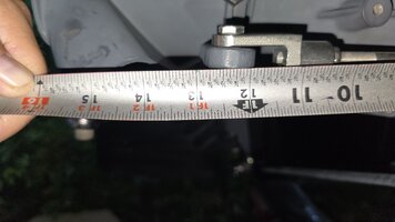

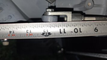

The last 2 pictures show the difference that little move at the power steering ram does.
There is a bit more to it. Like finding the center of the rams movement. Adj the cable upfront and at the stern to have enough threads in the clevis on the steering nozzle (starboard). I had to use thinner jam nut on the steering cabl up by the ram.
