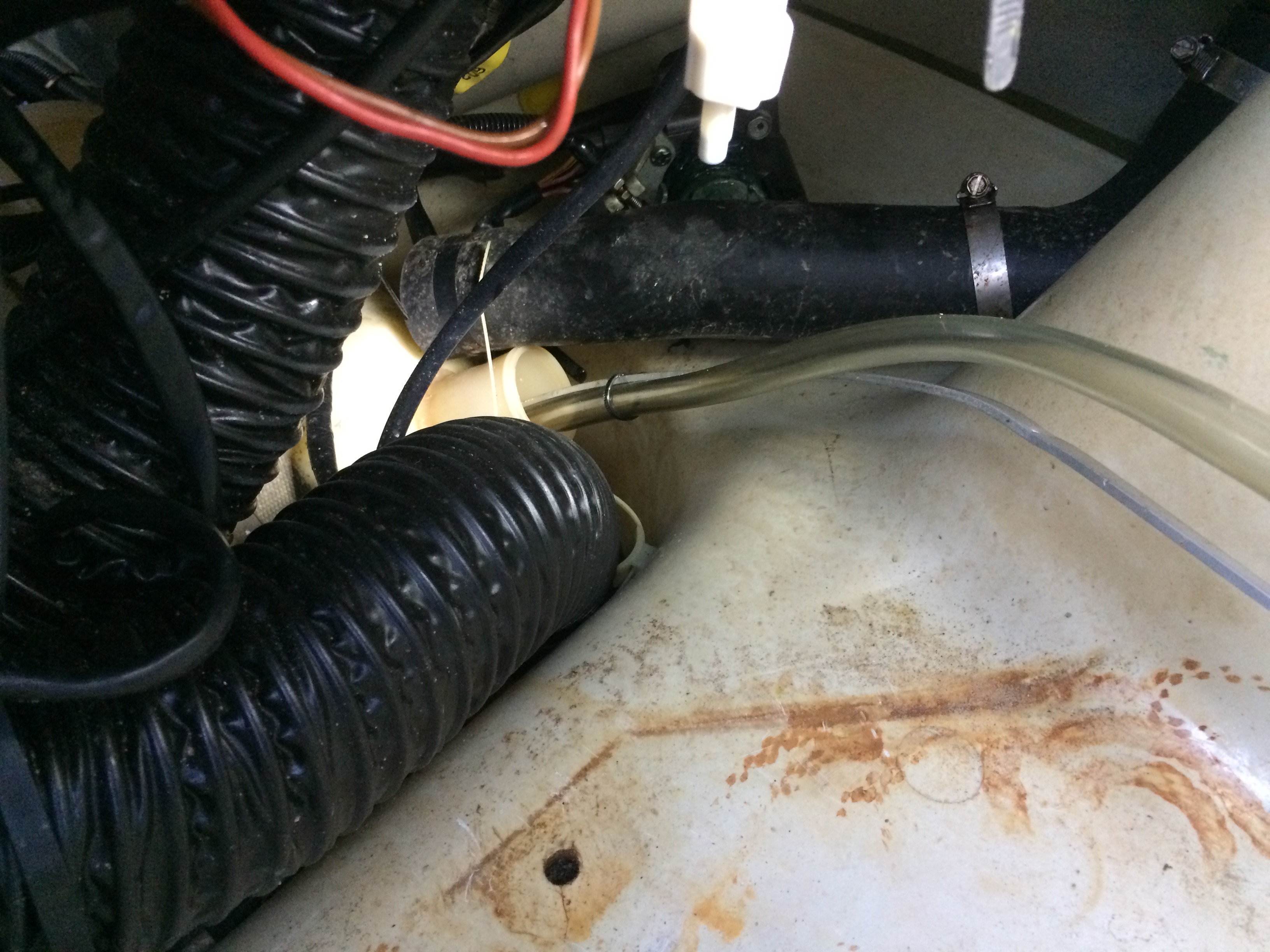

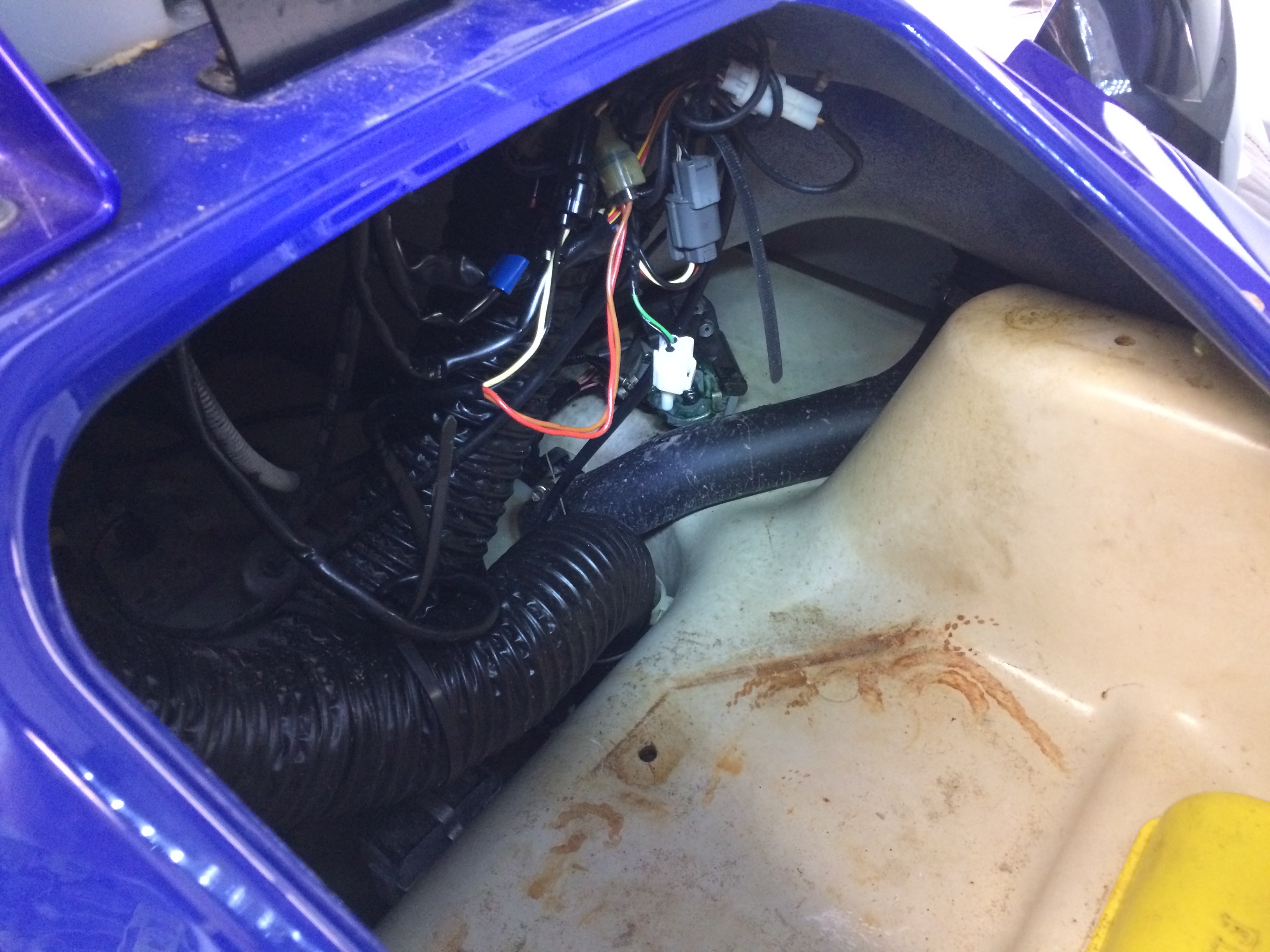

So here's my plan of attack. The previous owner said that the engine wouldn't crank. He really didn't get into detail about what that meant, so I left it at that. But he did say that the last time it ran, it ran just fine. So it could be a number of things. My plan of attack is to simply try and figure out if the engine needs to come out of the ski, or if the non-cranking issue is as simple as a bad starter or relay, stuck pump, hydrolocked engine or less likely just a dead battery.
Here's how I decided to tackle this:

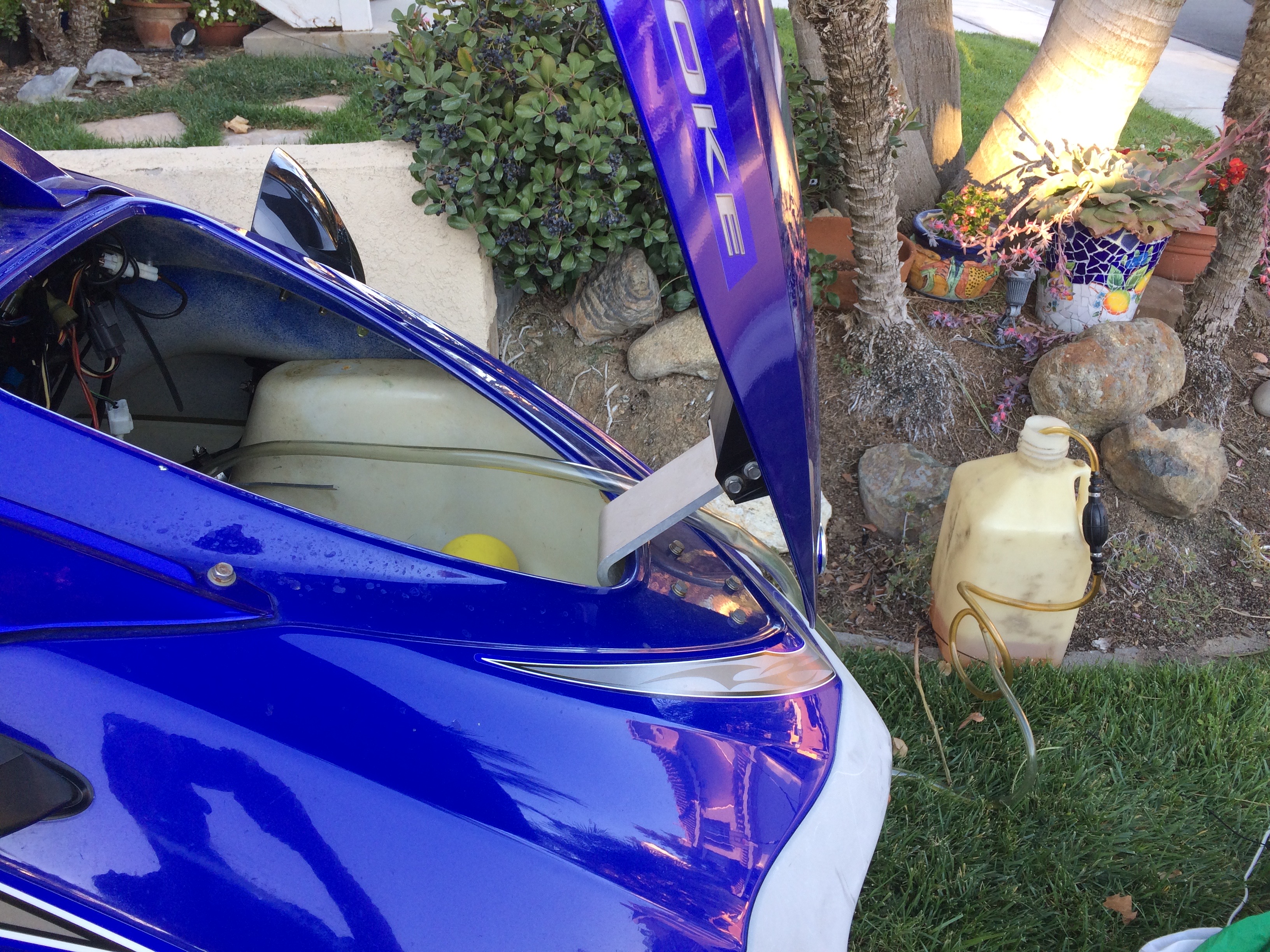

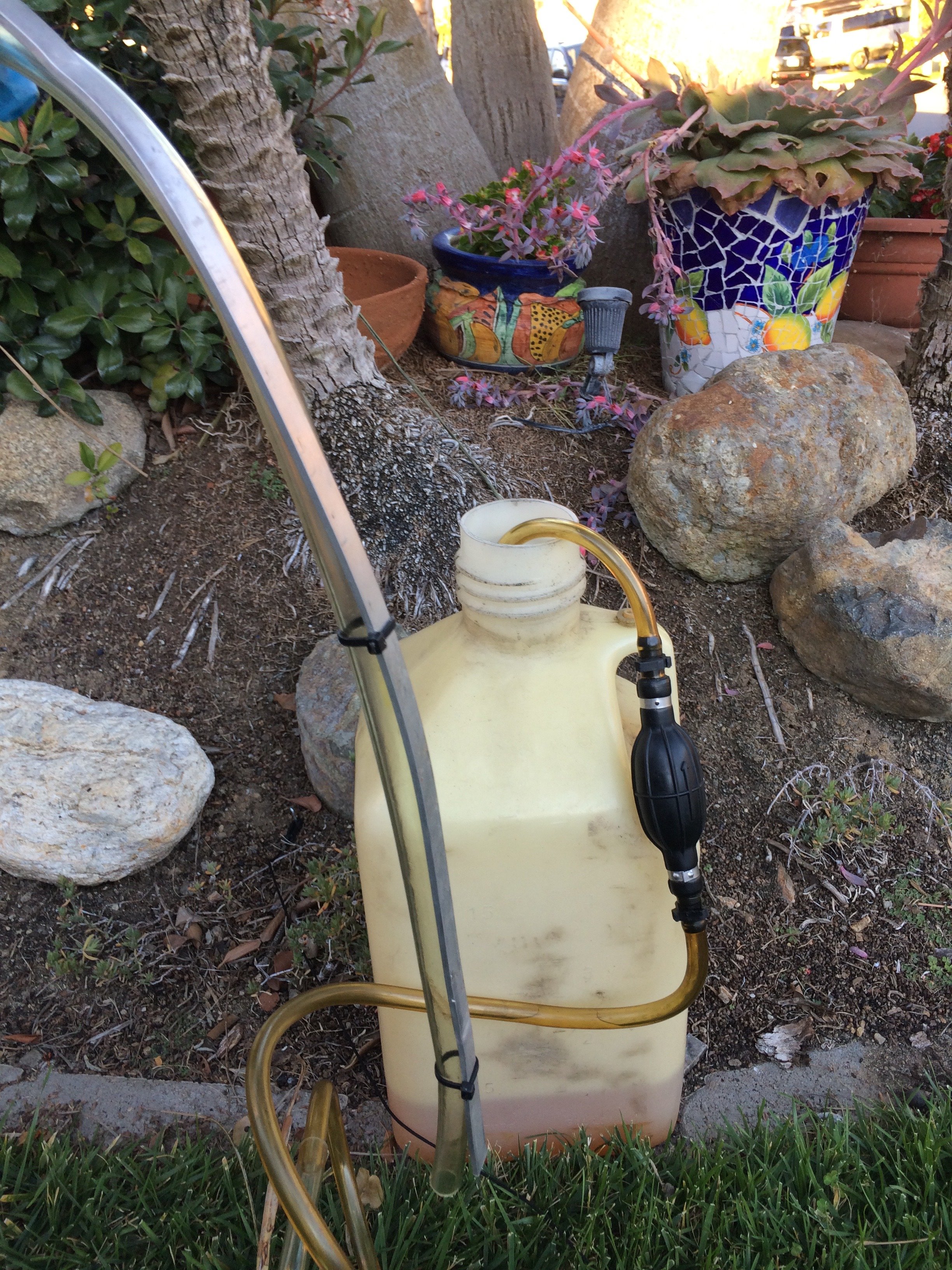

1. Drain the fuel tank and refil with a couple gallons of fresh fuel.

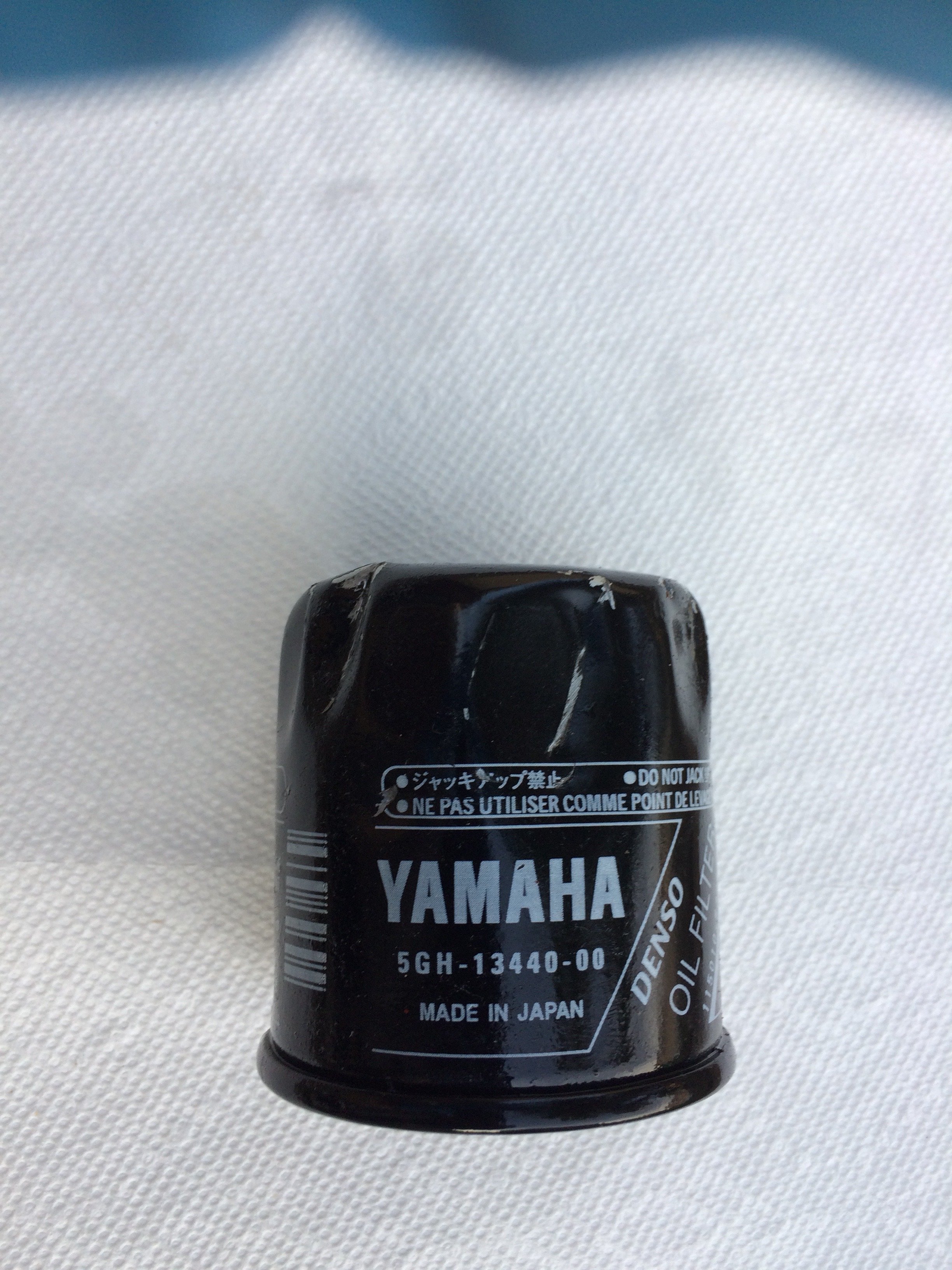

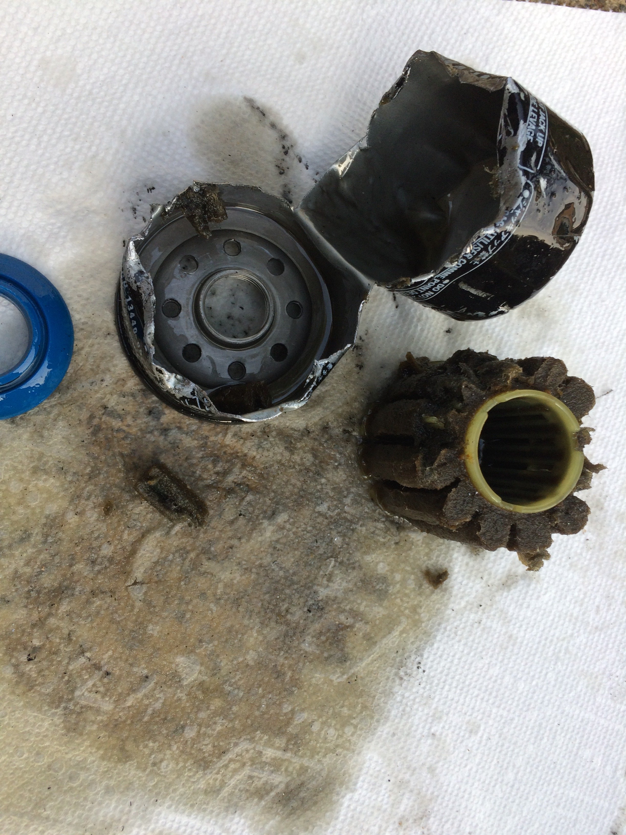

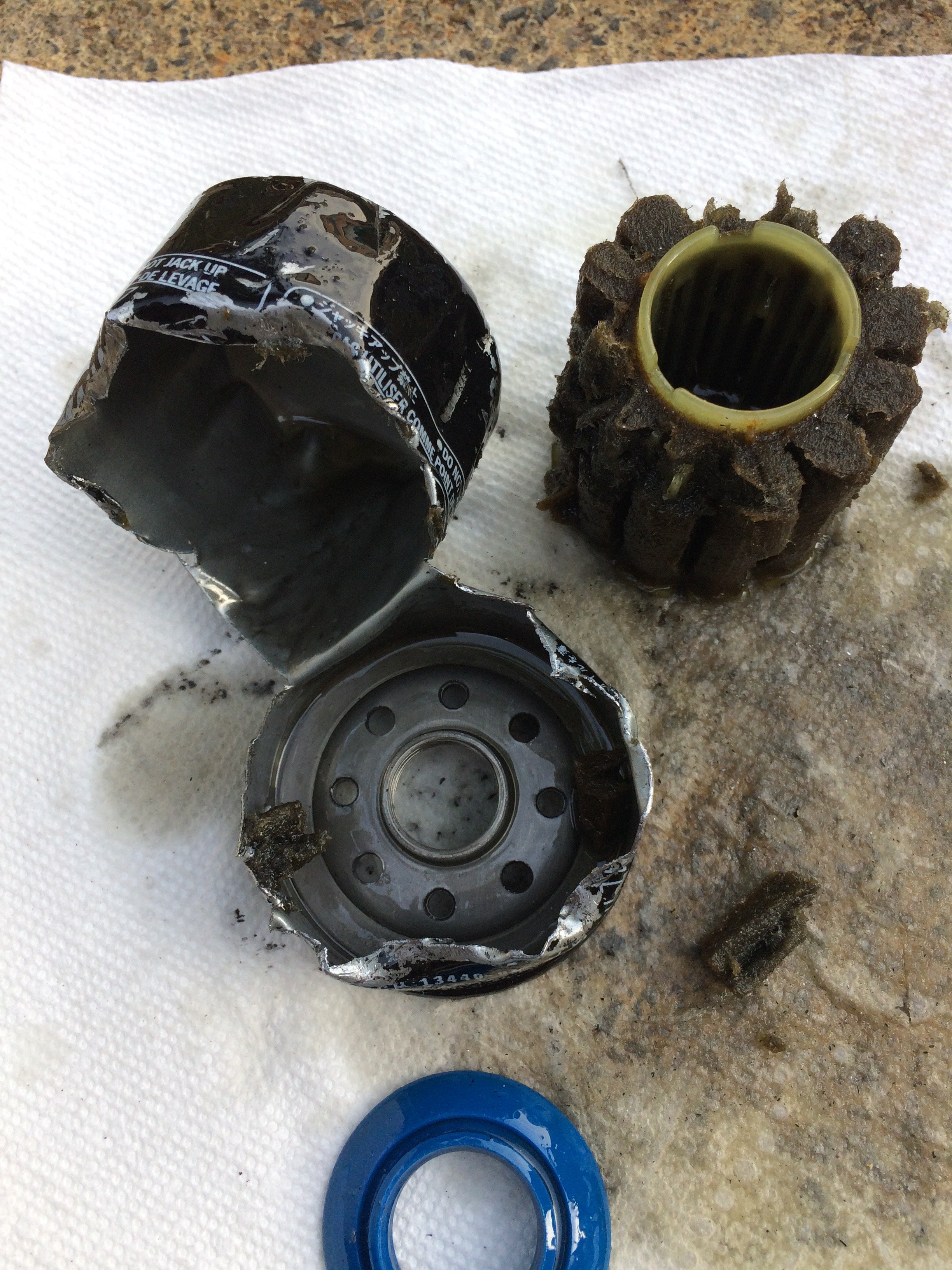

2. Do an oil and filter change. Looking both at the oil and in the filter for signs of internal engine issues.

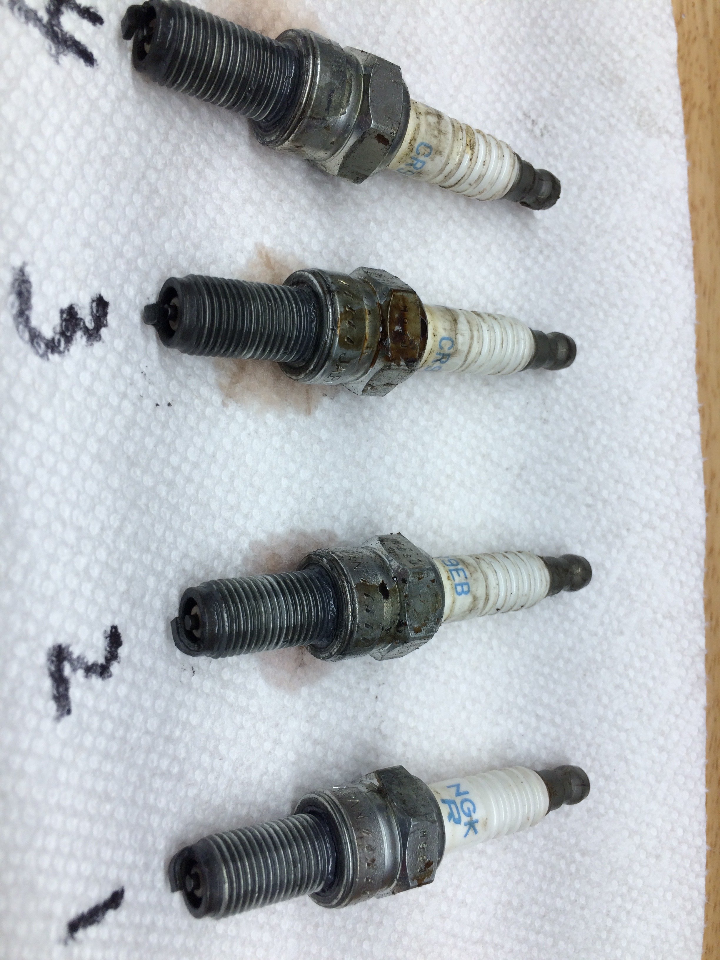

3. Remove and check spark plugs.
4. Cleanout and inspect air box and filter (if there is a filter in there.
5. Replace battery (this ones dead as a door nail.
6. Hookup YDS to read any previous error codes or alarms
7. Attempt to turn over/crank the engine
My next course of action will all depend on what I find along the way to step #7
