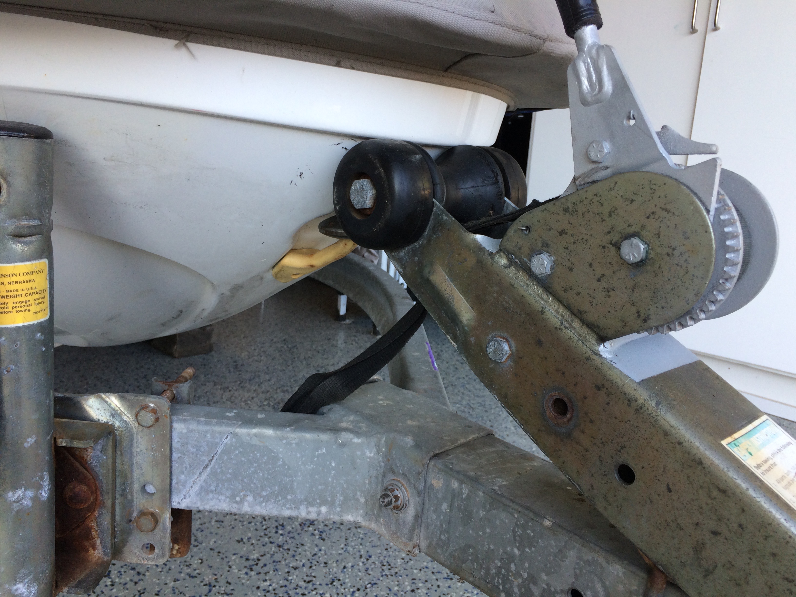

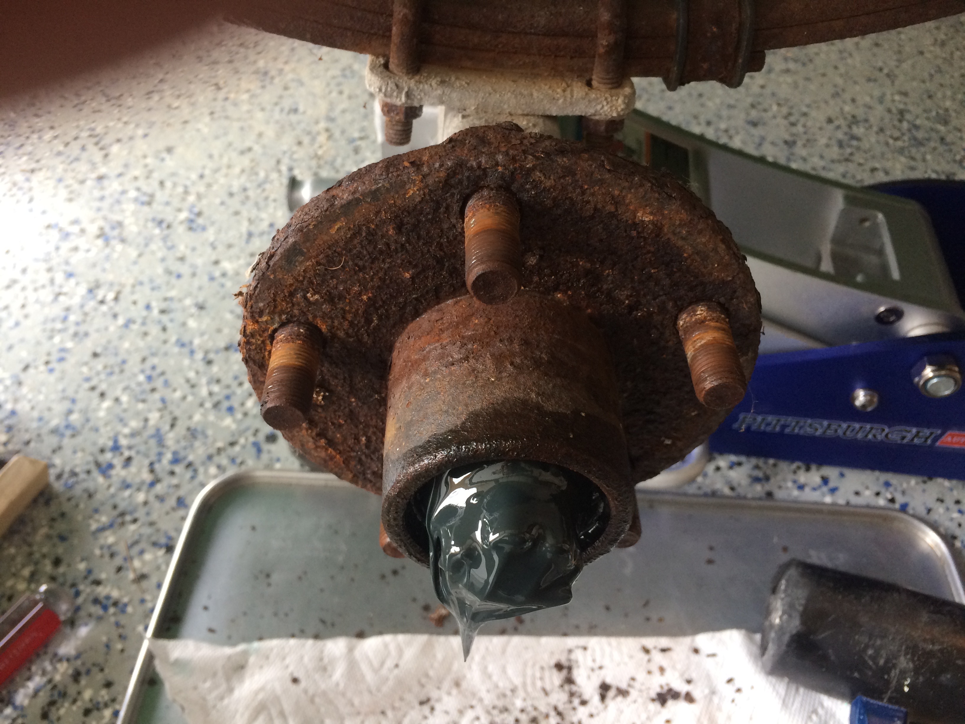

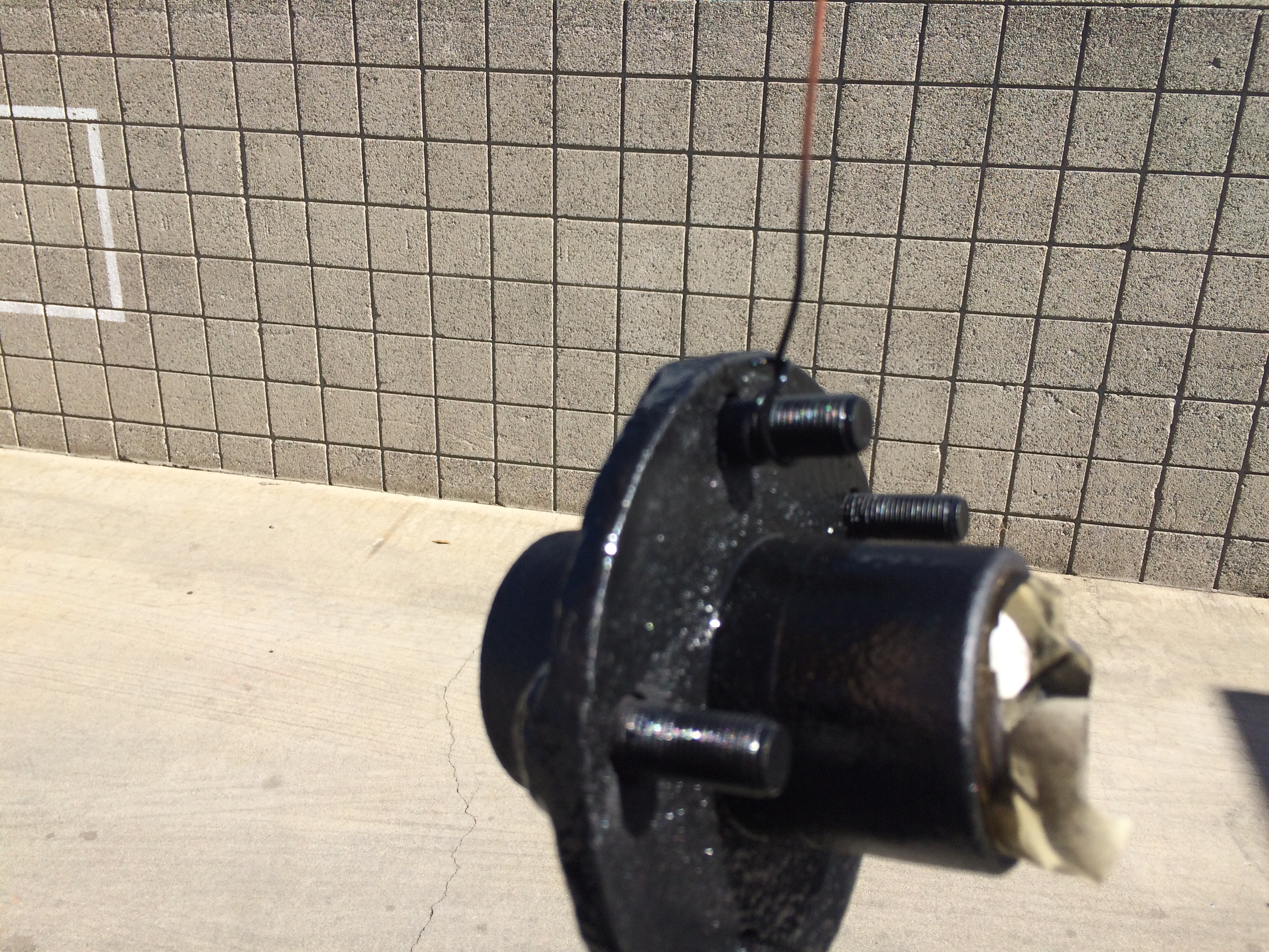

The next step with the trailer is to inspect the bearings. I plan on looking at the springs, cleaning things up and replacing the inner seals while I’m at it.

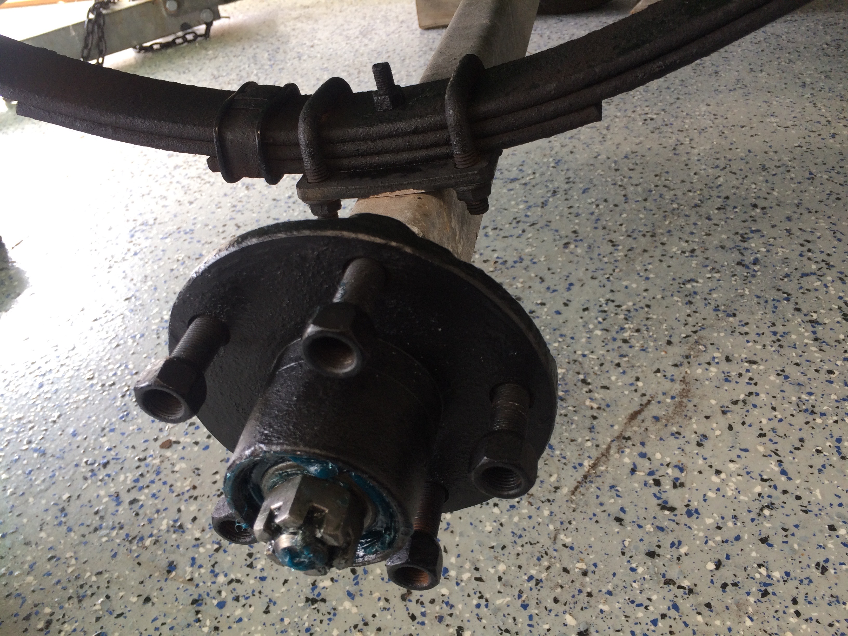

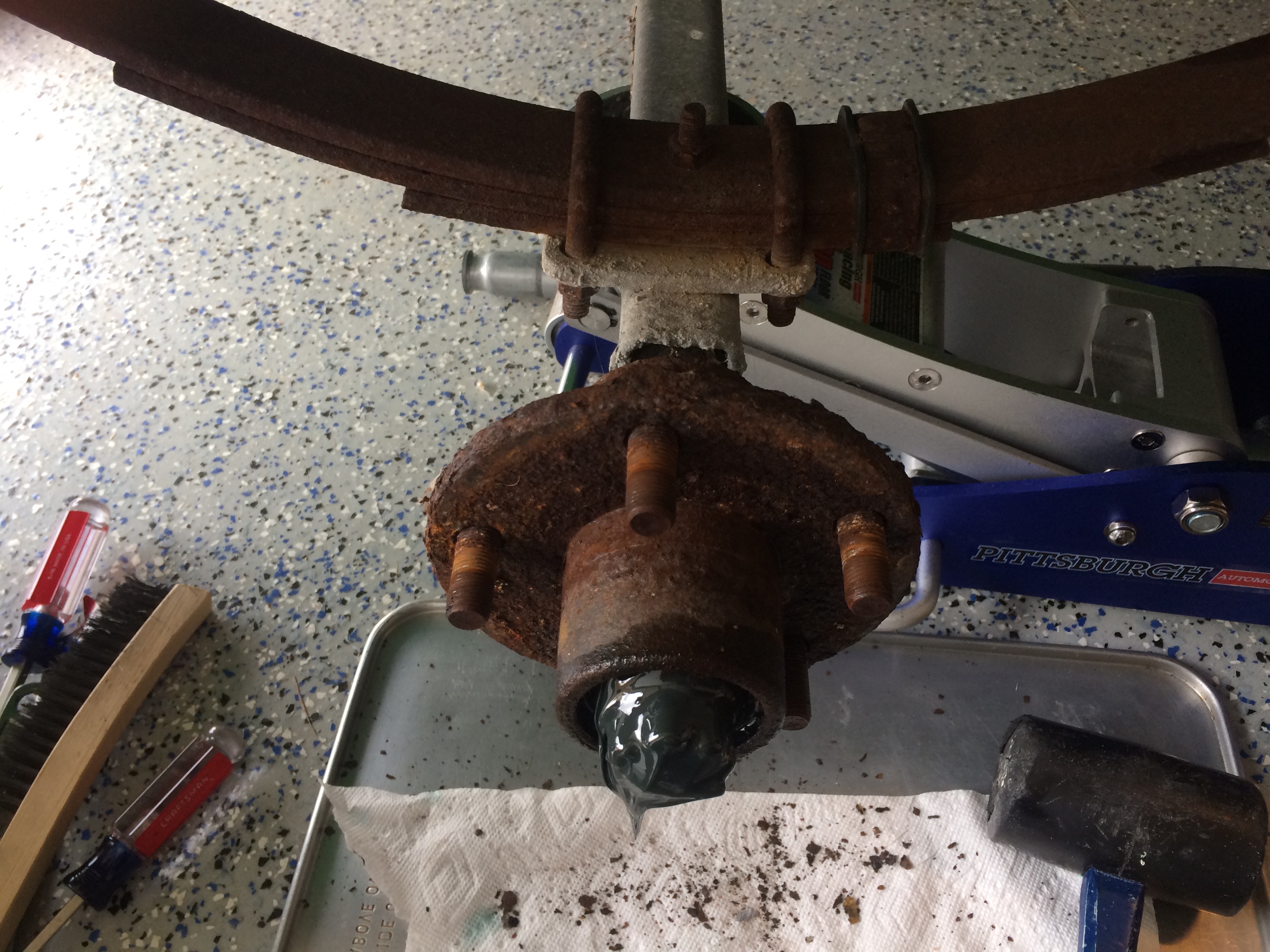

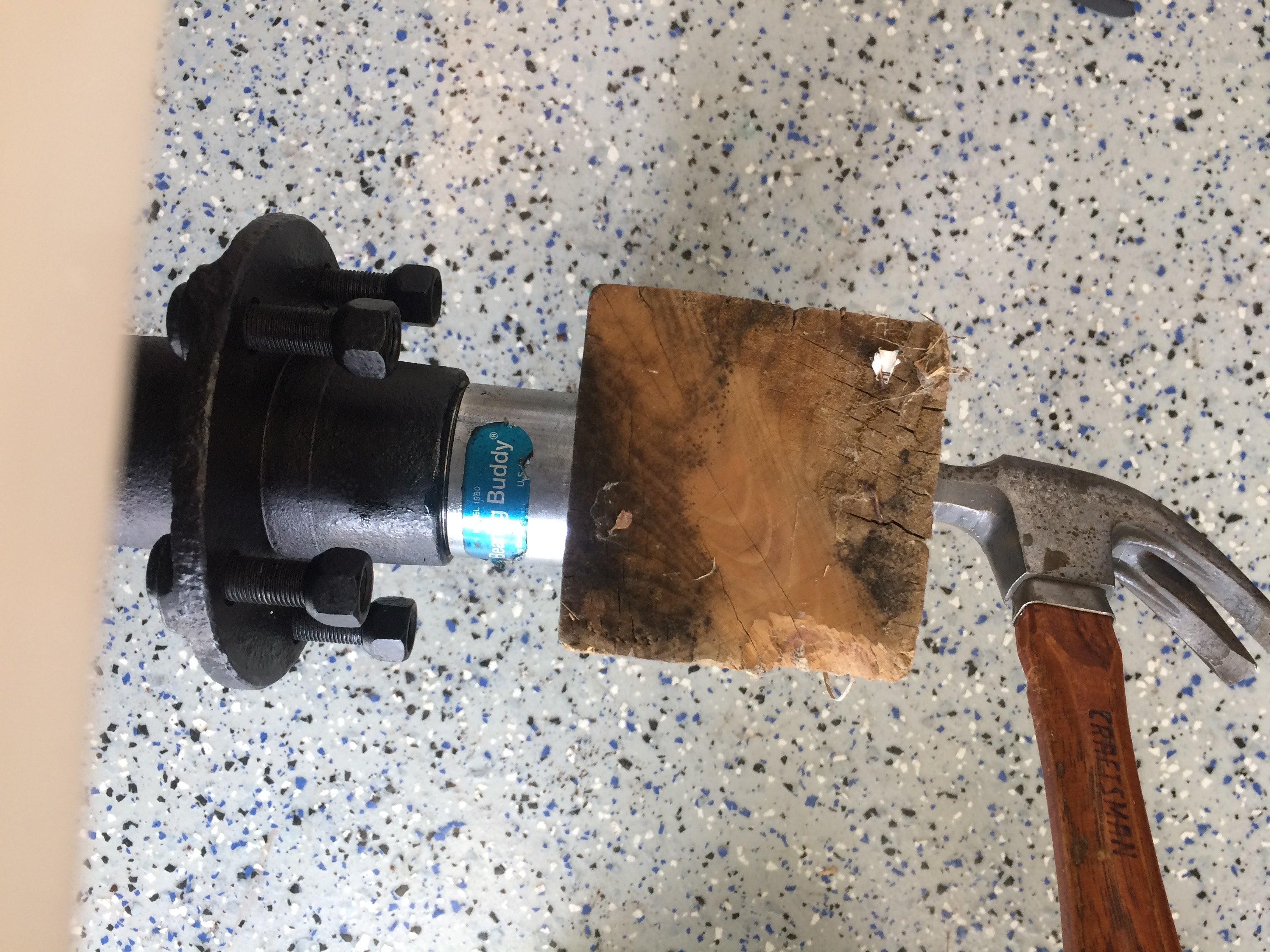

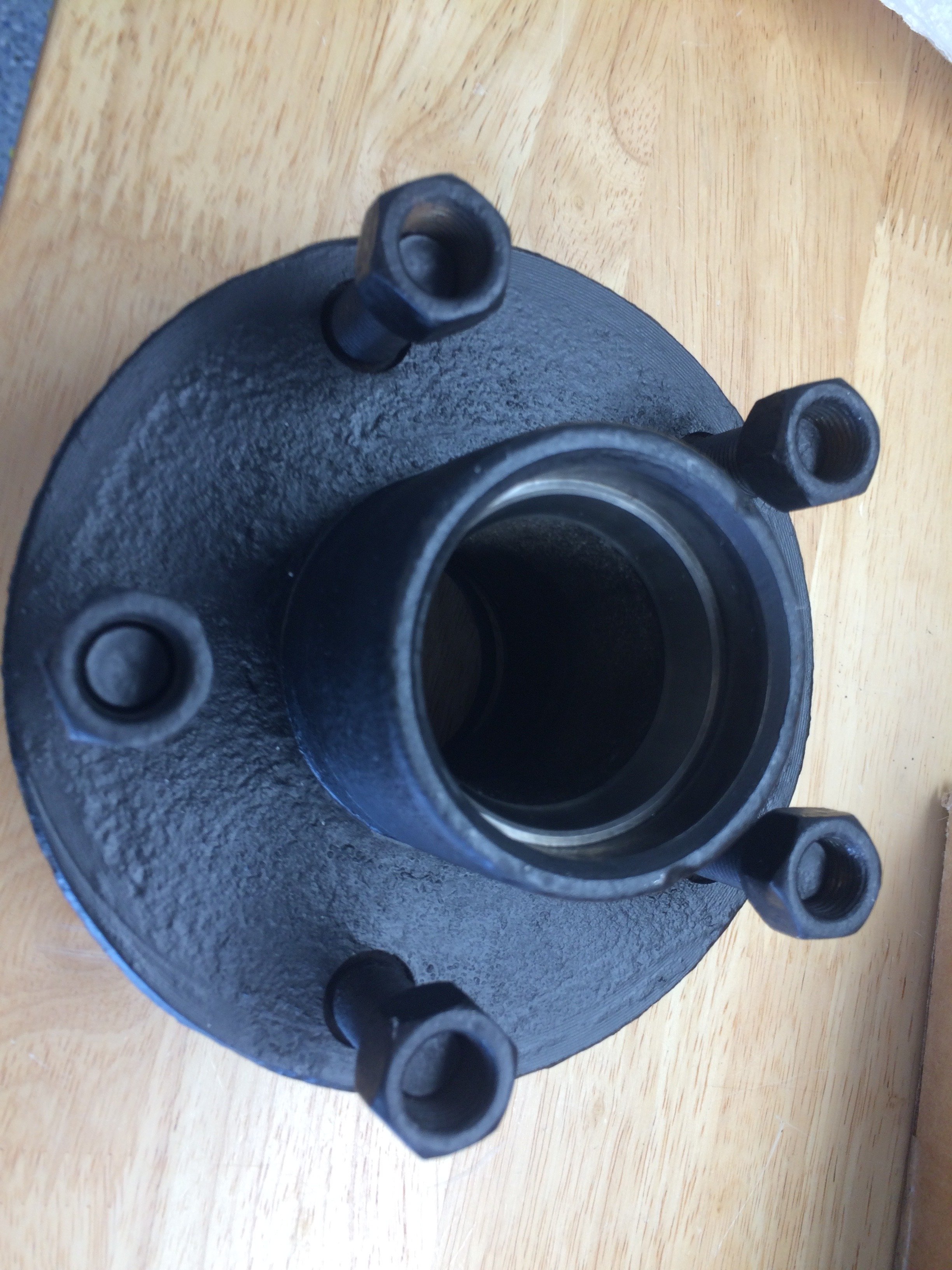

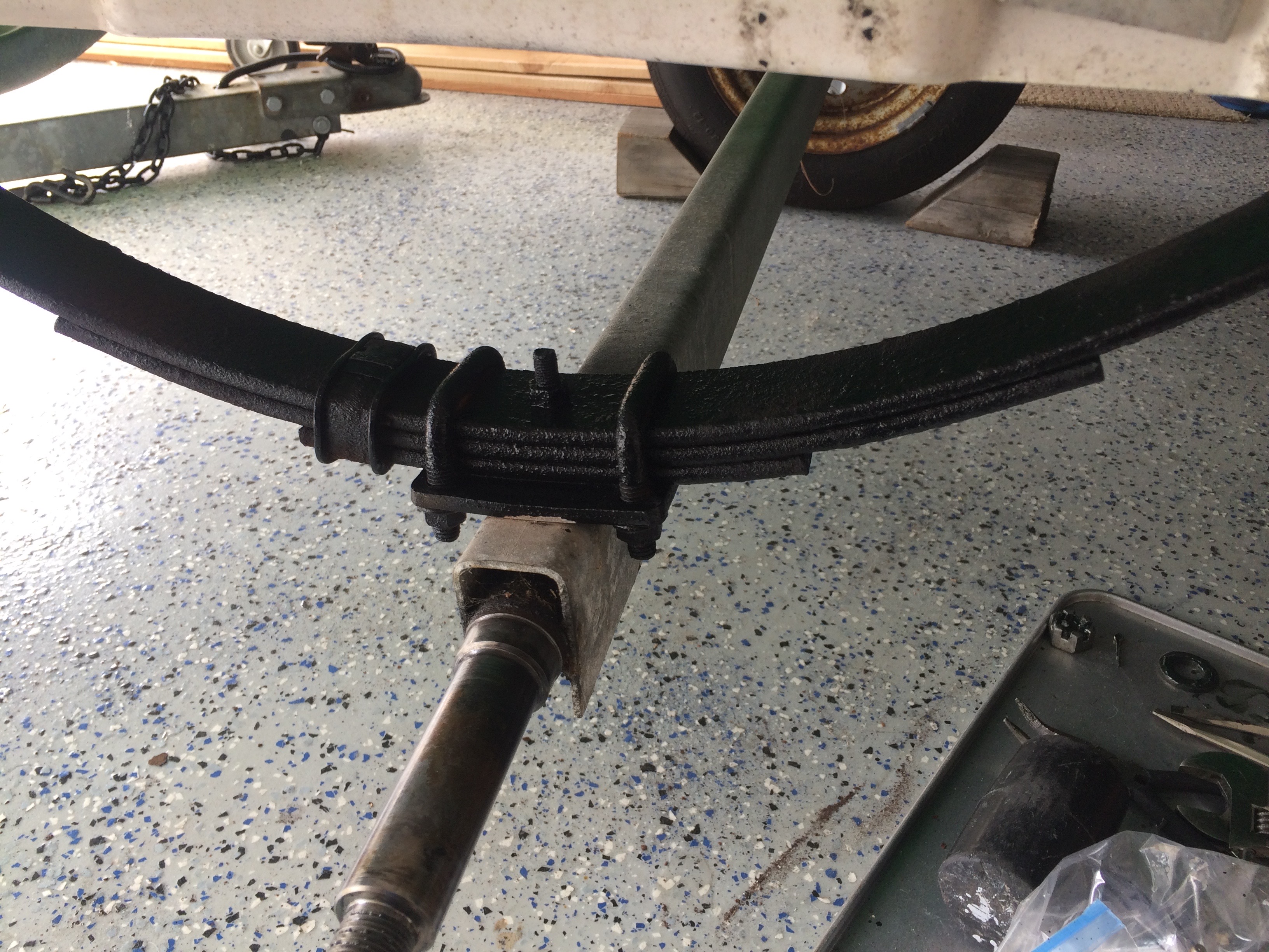

After pulling of the wheels it was more clear what I was up against. I’ve never owned a trailer that been in salt water before and I think things were better than expected. Sure there was a lot of surface rust and some was even flaking off. But structurally, everything seemed strong.

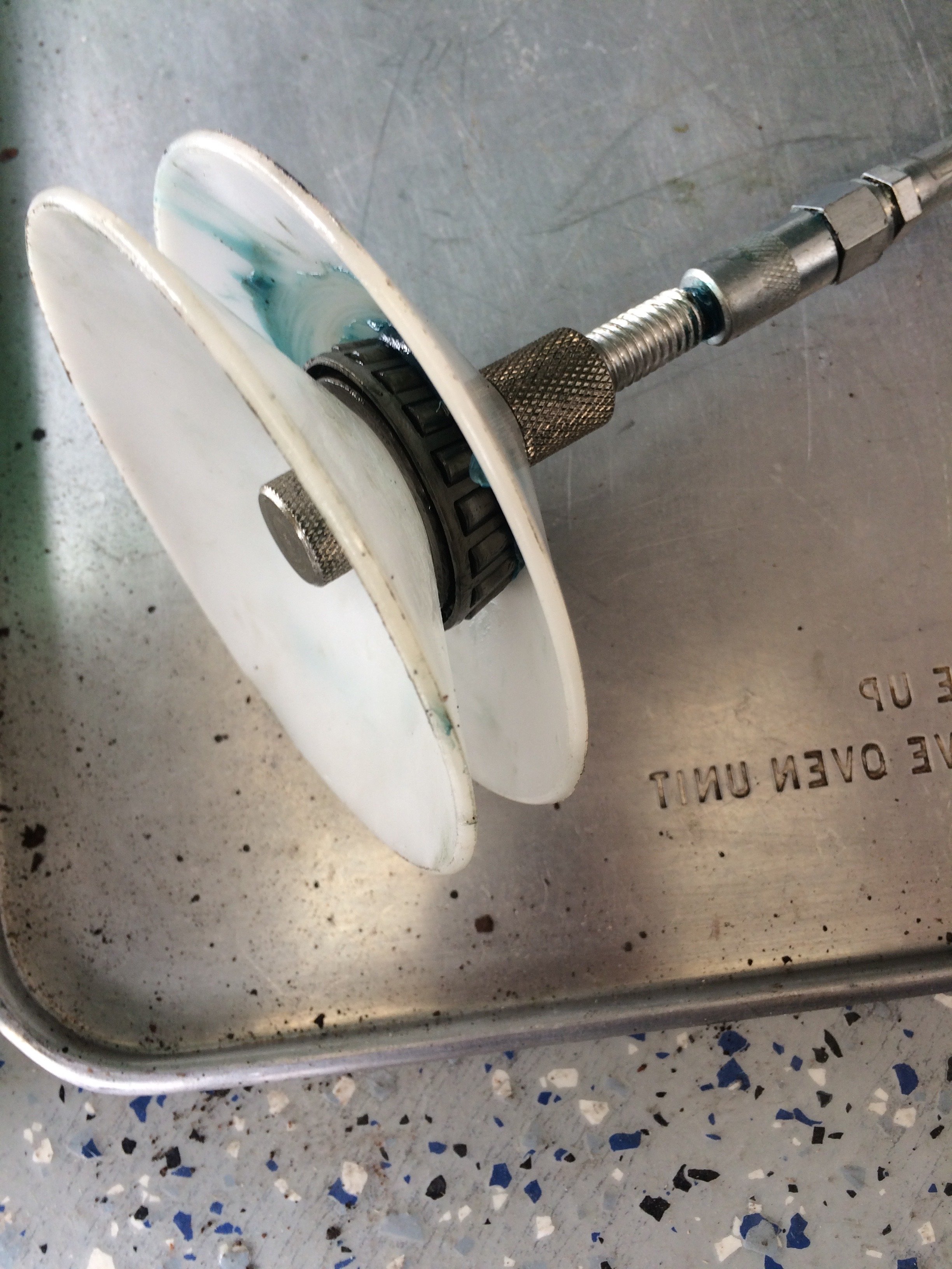

After removing the bearing buddies I could see a lot of grease. It was a bit more liquified that I’d want but there was no water intrusion at all. I was happy to find that somebody had packed it full at one point.

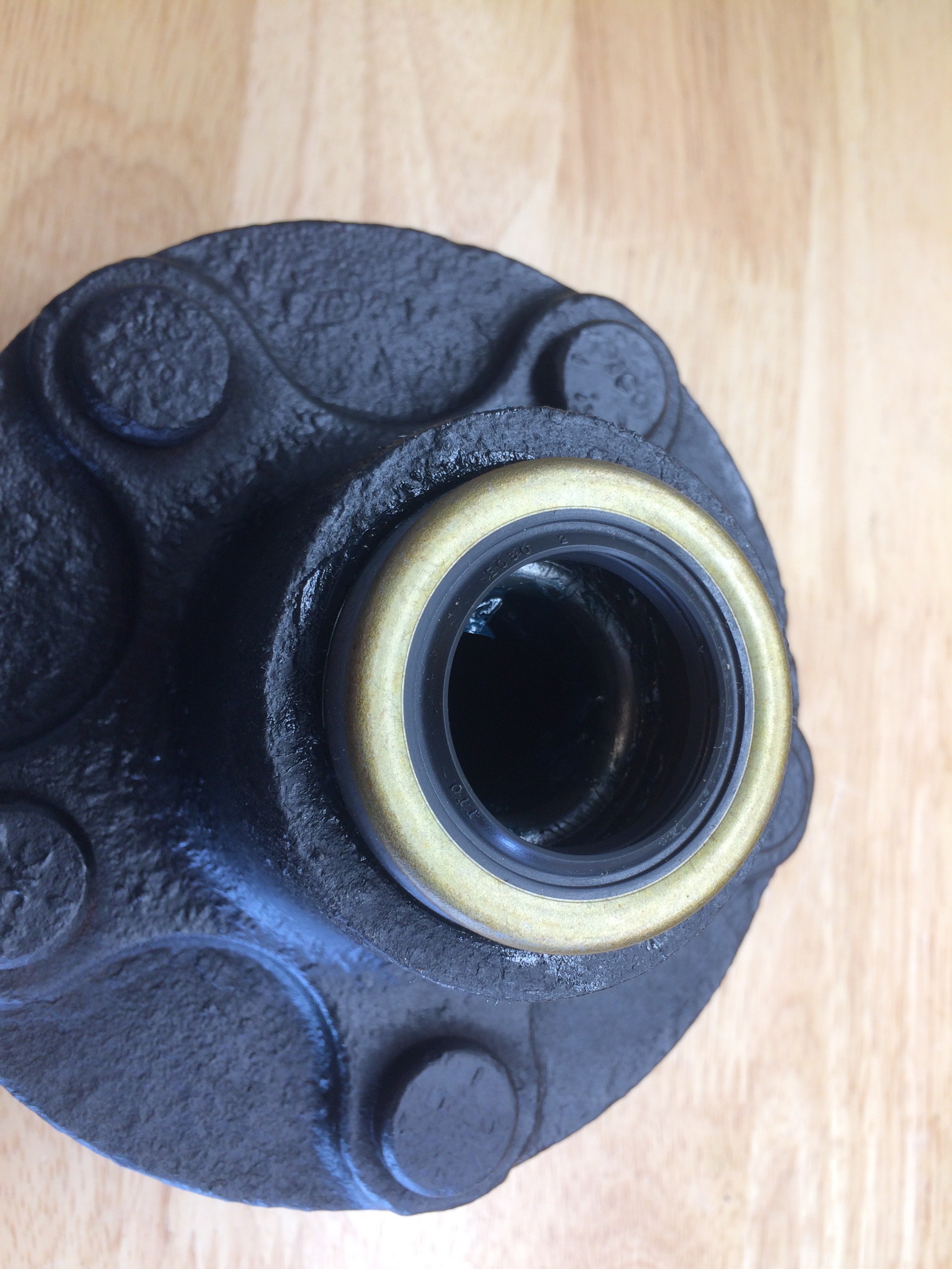

The hubs, bearings and races all looked good. So I simply removed the inner seals, repacked the bearings, cleaned everything up with a wire wheel, repainted, reinstalled bearings and new seals and put things back together.

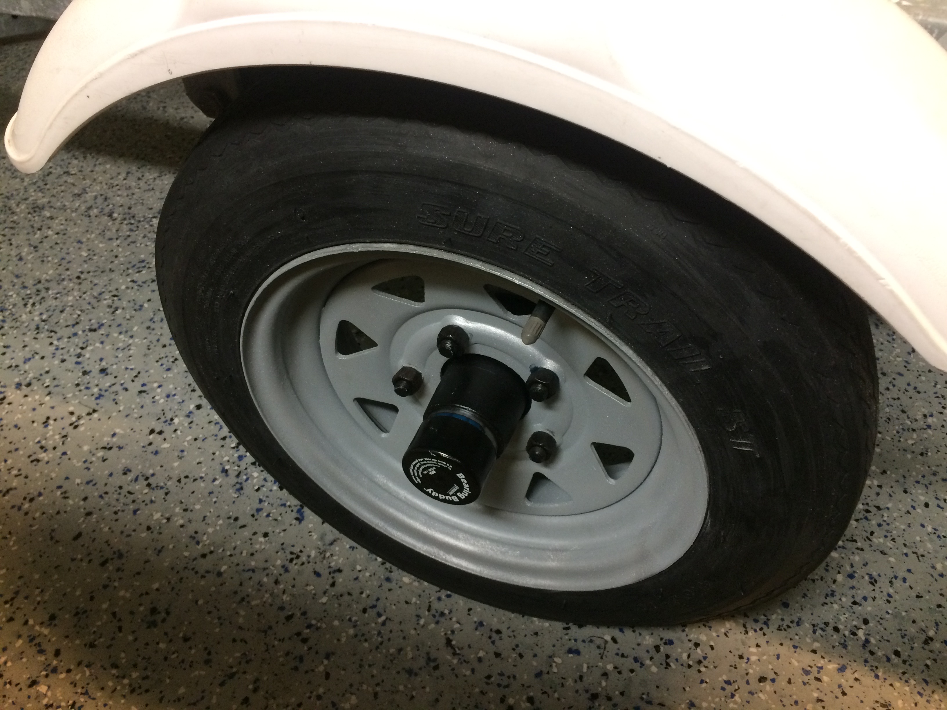

The bearing buddies however were packed on the outside with grease that had been heavily contaminated with sand. I tore those down too and cleaned them up prior to reinstalling them. Then I added bearing buddy bras/dust covers to keep the dirt and debris out.
I also cleaned up the rims and repainted them with a galvanized paint. I do plan on replacing the rims and tires down the road if I’m going to keep this for any length of time. I don’t want to be towing this trailer through the desert with these old tires.
I did get a chance to adjust the bow stop too. Now it lines up perfectly with the WaveRunner.

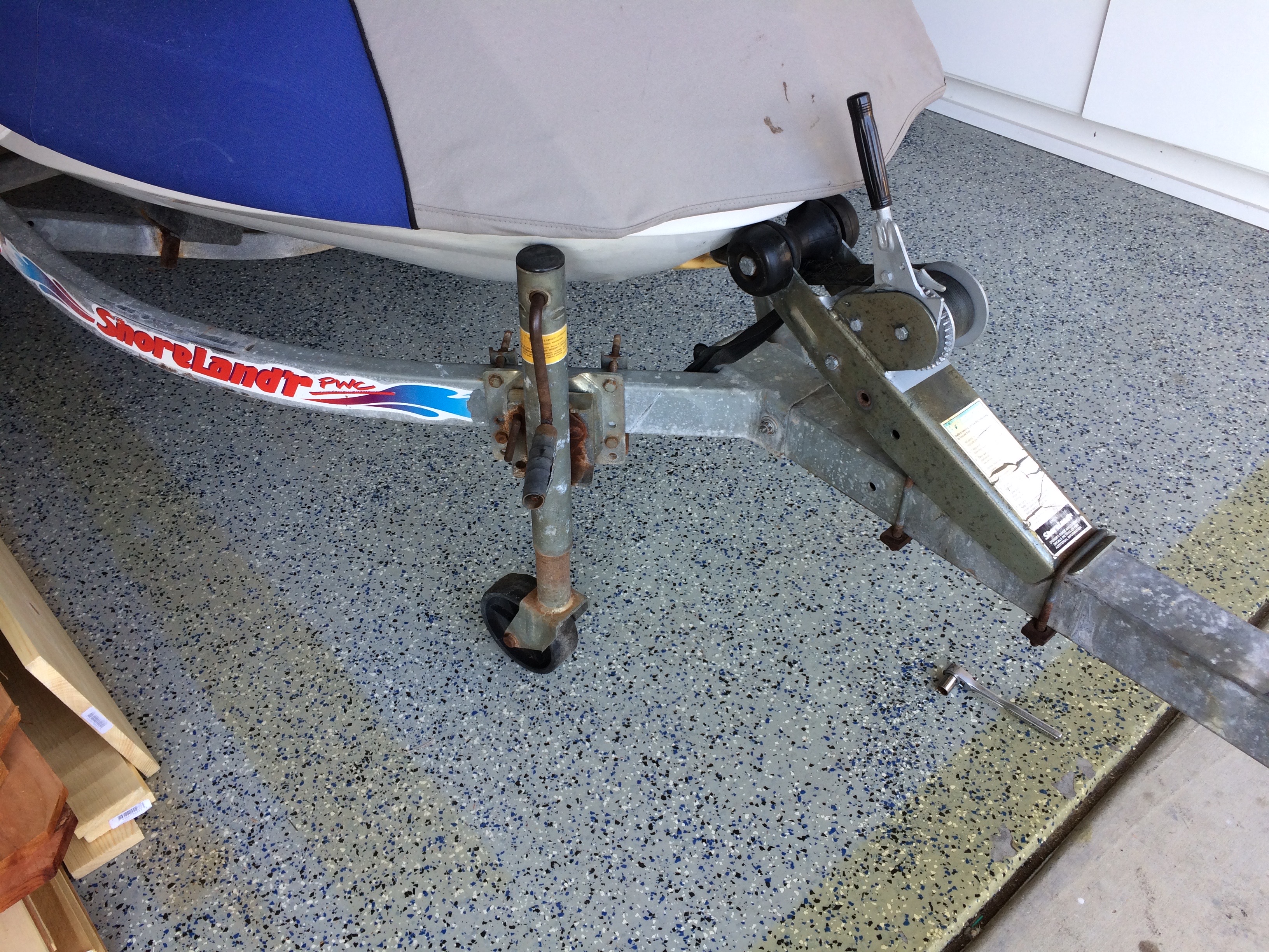

So, the only things left to do with the trailer are replacing the swivel jack and figuring out tie down strap. But I should be able to scrounge up something that’ll work in the meantime to secure the ski.
At this point, I could probably make my way to the water and run this thing.
