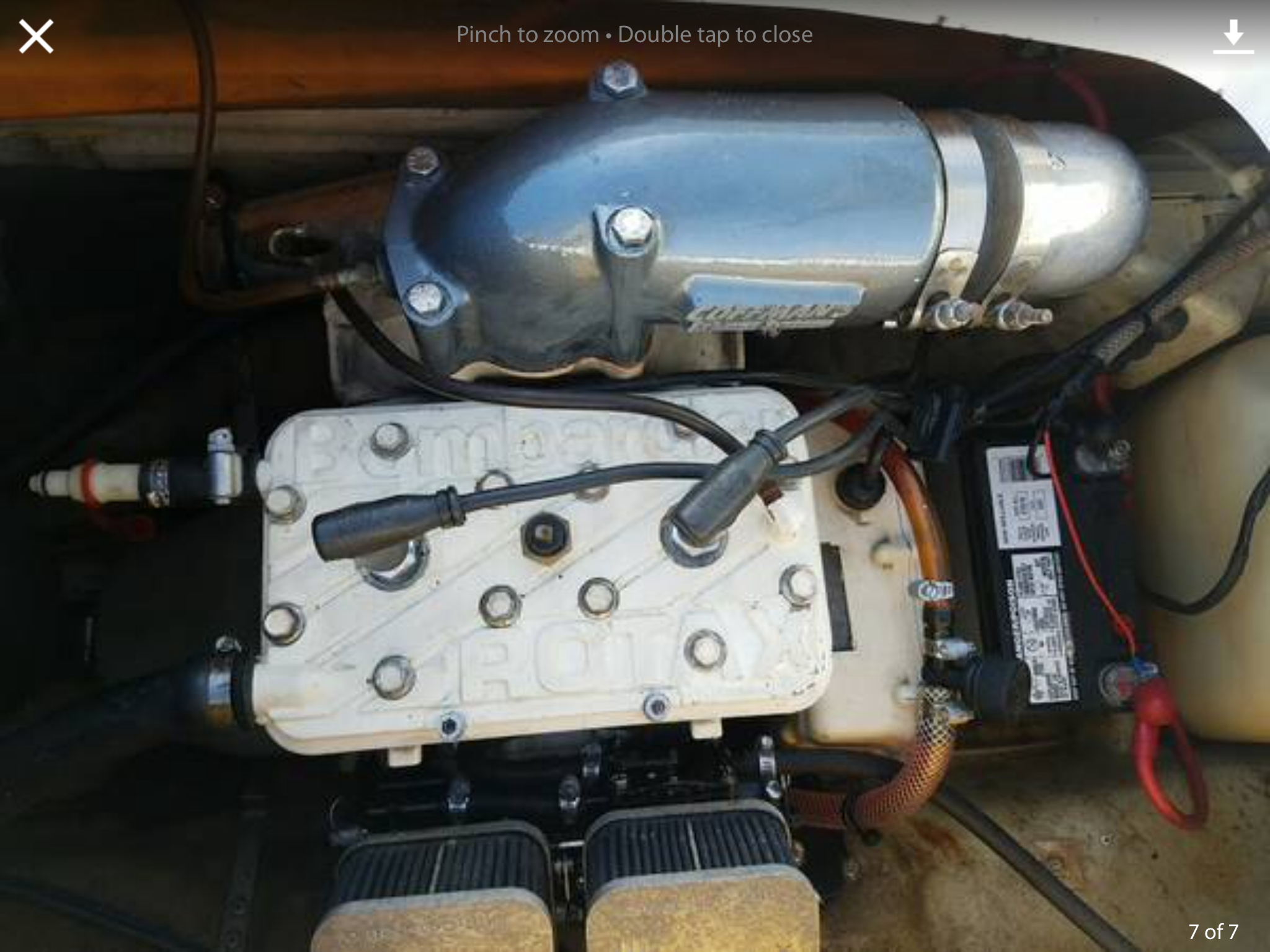

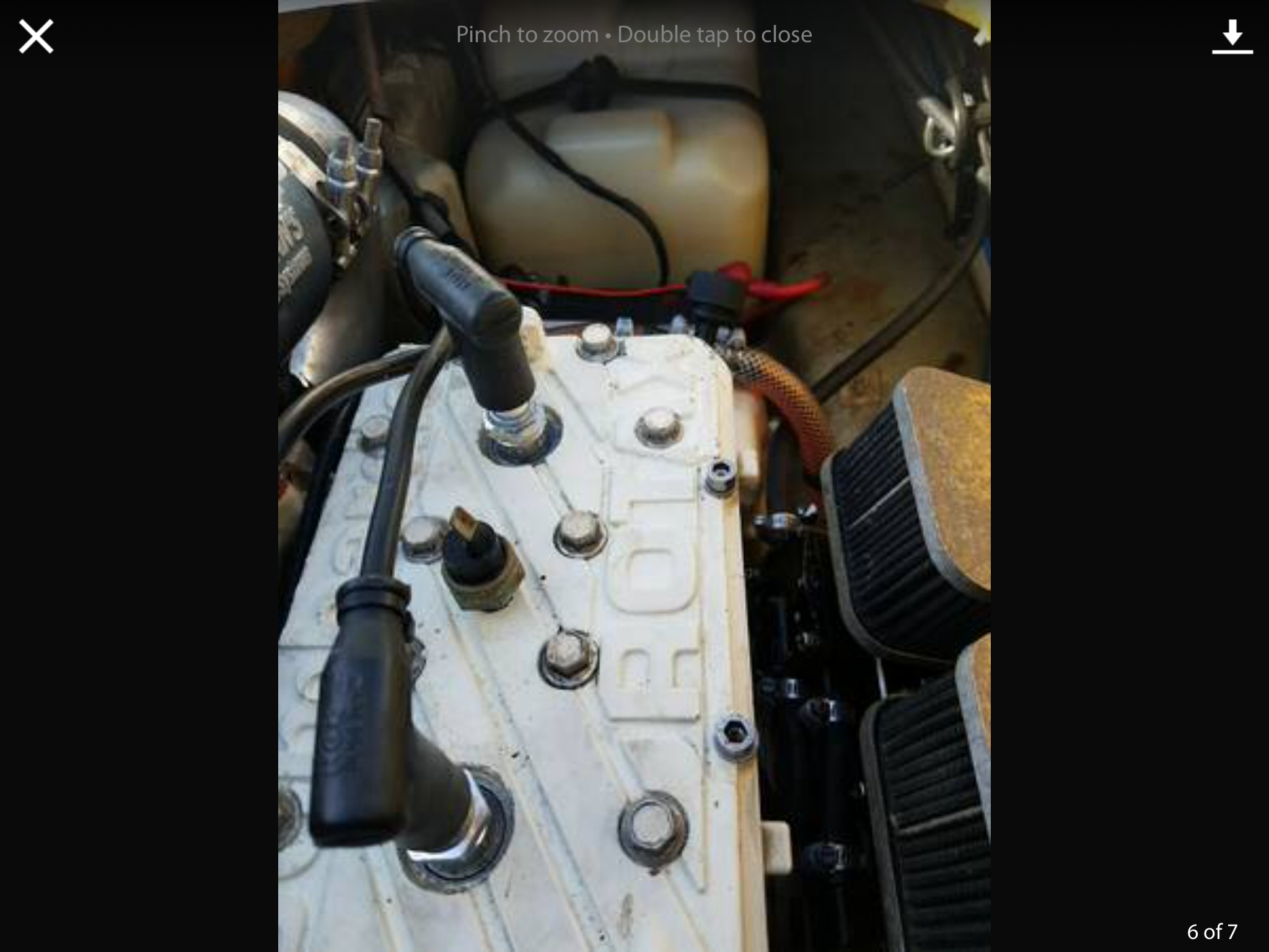

I did forget to mention that I tested at WOT. I've read before to do that. But I never understood why, I always thought it was something to do with the air flow, not the fuel flow. I realized after all the "testing" that it would've been nice to add the oil and see if numbers jumped up. But at the time I was so excited to get a chance to work on the ski that I needed to just push forward and get it buttoned back up before I needed to get back inside.Hold throttle at wot and it won't dispense fuel. Gives more accurate compression numbers too. The smoke could be water vapor in the exhaust and that valve was open. Remember that 1 and 4 run in sync and 2 and 3 run in sync. Add a few mL of oil and see if the numbers go up (for ring seal testing). Make sure to crank until the gauge doesn't move, release pressure, and repeat at least one more time. I do 3 readings and they should be within a few psi. Normally they are within 1 psi.
So I'm sure there'll be another chance down the road to check compression again. But thanks @Jgorm for the how to tips.
