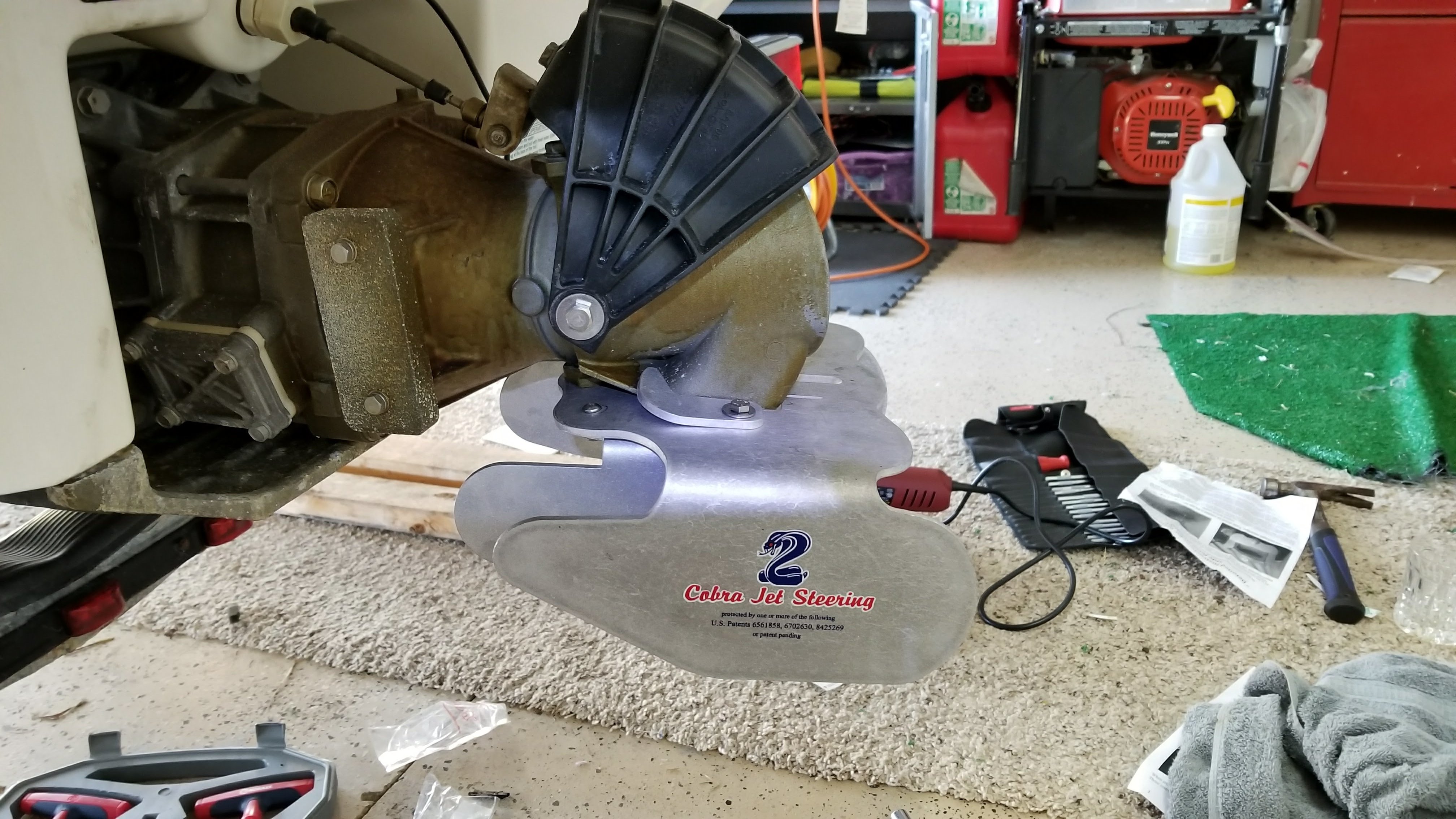

what year boat is this reverse gate off? broke an ear off one of mine and need to replace I would put this one if it fits my 05

That’s the newer gen gate. I can’t recall what year but different from your smooth aluminum ‘05 in construction. I suspect it will still work (no real geometry changes, just a different form) but it would look different.

It's not from a 2007-2009 xx230 series boat either, because my gate does not look like that.

Yours is an aluminum older style gate, however if you try to order one you will get the newer style plastic gate as shown because they do no carry the older one and if you do not change the standoffs in the newer gate where it pivots on the bolts the older ones were shorter so the gate will drag or hang up, the new gate standoff part number is 90387-08m30-00 and you will need 2 of those per gate obviously.
