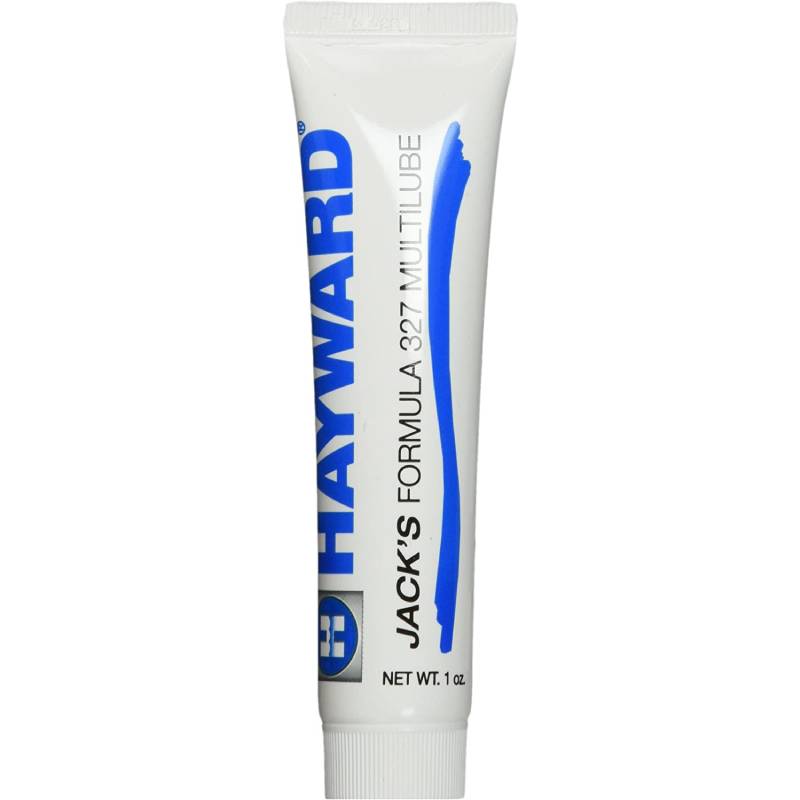

I use a pool lube also. Do you use this penatrating lube as a regular lubricant also? I don’t have any issues with the type I’m using but it would be easier to just carry one type on the boat in case of a stuck plug on the water.
The Lubegard Zer0 works absolutely fantastic for shrinking the o ring and releasing the clean out plug without damage to the o ring, the plug, or the tube (and also has some unusual cleaning properties) but is barely adequate but useable as a o ring protectant as it is very thin and it’s protectant properties only seem to last for about 30 days in fresh water.
I can only assume that a thicker traditional pool gasket lube or the recommended silicone spray or marine grease would serve as a longer lasting o ring protectant, but yes I use the Lubegard in this protectant capacity only to minimize the amount of junk in my on the boat toolbox.
I used the biggest adjustable wrench I had (a bigger than average wrench I have a lot of tools), opened it wide and put a metal socket extendernder through the hole at the top of the handle for leverage and twisted them open. Did the cleanup job that was needed then lubed up with pool/spa O-ring lube sealant and reset.
