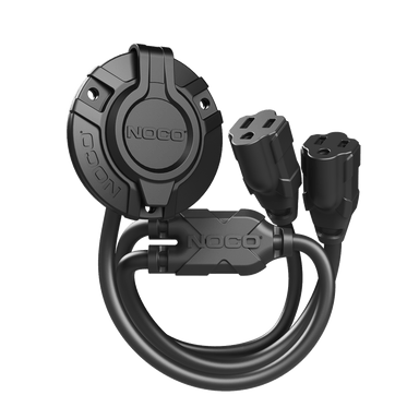

I’d say the number addition is an onboard battery charger that will be plugged in while the boat is not in use to keep the batteries fully charged. The alternators on our boats are not that powerful so the battery charger is a must. A 10x2 NOCO would work out fine, and 10A is necessary for proper charging of lead acid batteries so you can get the most out of them on the water.
NOCO also makes a convenient AC port.
