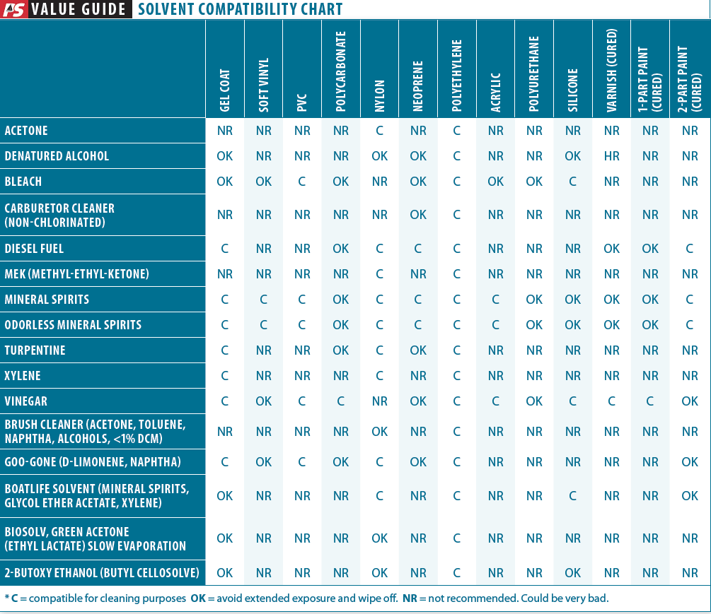

Great article about solvents and gelcoat, although I don't agree with the NR rating for acetone. If I recall correctly, that's what SeaDek recommended (recommends?) for cleanup prior to installation. I also used it for cleanup prior to patching gelcoat several times without issue. Anyhoo, I'm attaching the chart, in case things go tits up for that link.
