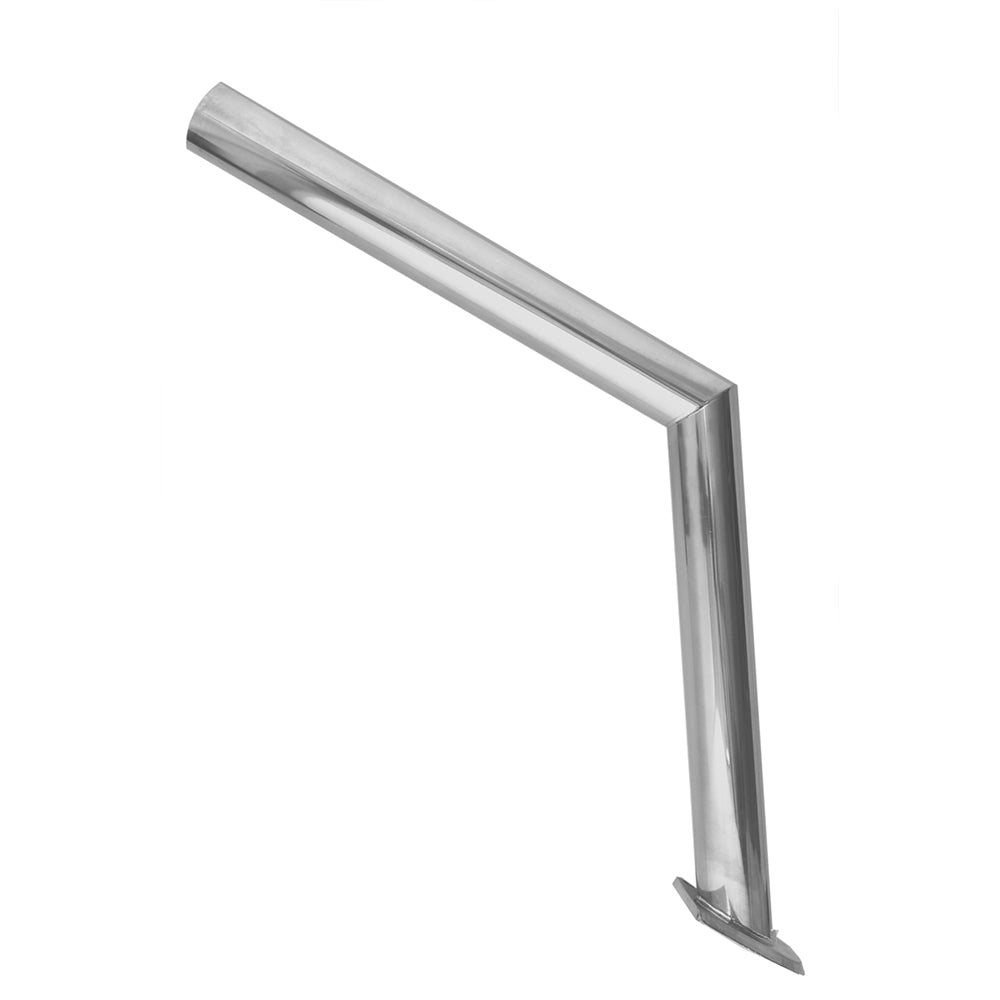

2015 24 foot - Grill mounted on Table base
shane hric
277
230
137
Hobart Indiana
I just ordered the Magma Trailmate grill off Amazon and also I ordered the magma universal plate, but I cant find a place to buy a replacement table leg for my AR240. I really don't want to spend $256 for another table from Yamaha. Anybody have a line on just the curved table leg like MrMoose used?
Thanks

Hey I was wondering how do you have the Cabo grill installed and with what mount?
MrMoose
1,579
2,278
267
Calgary, AB, Canada
Hi @Pantelis ,
I mounted a "MAGMA Power Grip LeveLock Double Locking Rod Holder Mount" to the bottom of the grill. The Magma's expanding handle fits into the Yamaha table leg. The only mod that I did was to silicone a sleeve (standard 2" abs pipe) into the inside of the table leg so that the Magma's expanding handle would fit more snugly. The Power Grip stays attached to the grill when storing. I bought the Power Grip from West Marine: MAGMA Pow'rGrip™/LeveLock™ Double Locking All-Angle Adjustable Rod Holder Mount | West Marine
It is easy to set up and I like the fact that it is easy to level. I decided to buy an extra table leg from Yamaha so that I can have my table set up inside the boat while I grill on the back deck.
Let me know if you have any questions.

I did research and spent a lot of money to put together a table and grill for my AR192. I like to cook and entertain people so it's worth it. I had to order 2 stanchions and the garelick mounts. I also bought a Magma Connoisseur 9"x18" grill, cutting board, and carrying case. Here is what I found when trying to mount the grill:
OEM stanchion is 2" ID so the 2" PVC has a larger diameter then the OEM stanchion. 1-1/2" PVC fits better, but it needs electrical tape for a stable fit. I ordered the mount listed below and I didn't like the set up because both the PVC and mount would require tape to fill the gaps.
I decided to do it right and order the Magma 10-180 Pedestal Adapter and the Garelick 75648 Table Mount this fits into the OEM stanchion. I can report back next week when it's all together.

Curious if you were able to try this out yet and wondered how it worked out?
Yeah I've been using this set up a lot. I put a 8x8 1/8" thick aluminum sheet behind the bracket. No stress cracks on the swim platform of my 192. It didn't need spacers either
