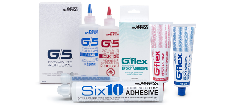

Forgot about West Systems products I've been using for repairs...I did use G/flex 655 to fix a bulkhead in the bilge of the sailboat.
Used Six10 and have been 110% happy I also used the regular Gallon cans with the ratio pumps and the appropriate 4xx fillers as well.. for glass and laminates...
