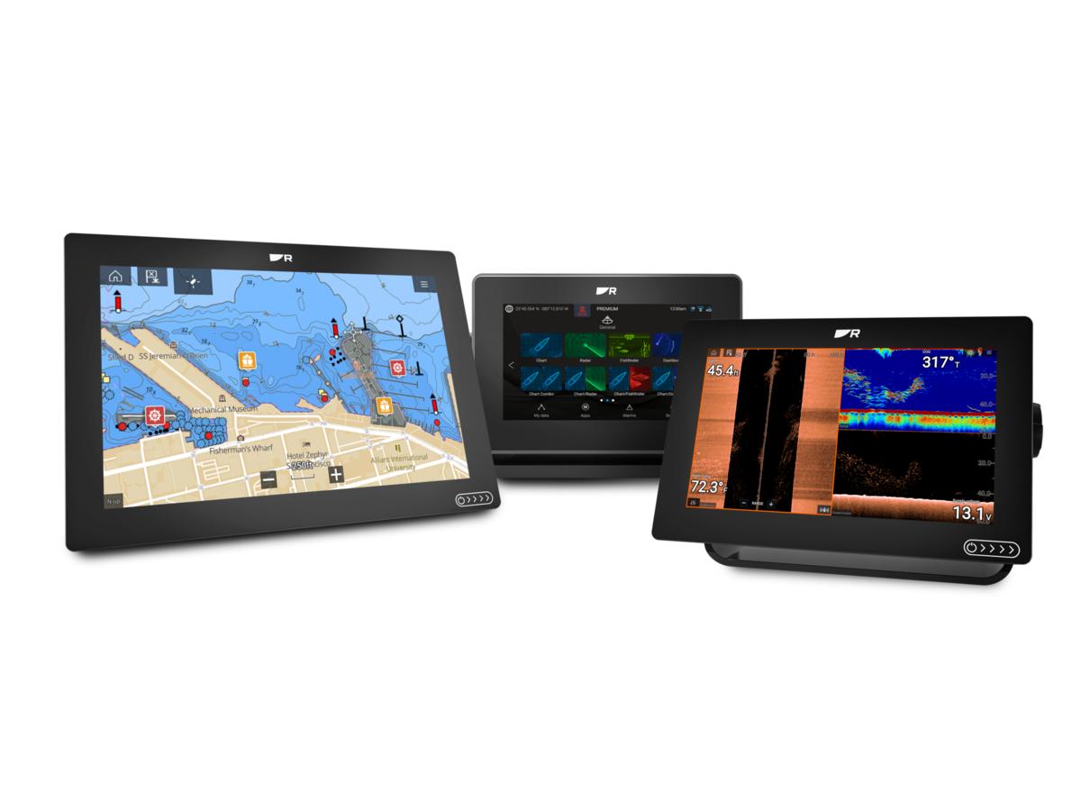

Wow! Thank you for your incredible replies @MilesPrower and @FSH 210 Sport .
Great to understand the product histories on some of these. My top contender is still the Raymarine Axiom Plus with Navionics. (I have some friends who highly recommend Navionics, as well, based on local experience - so glad to see you recommend it, too.). I hate to be greedy with your time, but any thoughts about this unit? https://www.raymarine.com/en-us/our-products/chartplotters/axiom/axiom-plus-rv
I don't have any experience with Raymarine electronics, but the Axiom+ series looks supercool! I love how Raymarine is offering an Augmented-Reality feature that works with cameras. I have night-vision cams on both of my boats, and the AR-overlay looks like it would be really useful for navigation in channels and harbors.
