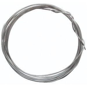

You could put a long cotter pin through the bolt hole too....or SS mechanics wire
Shackle bolts have a small hole in them for a reason. If it's the screw in kind, use stainless steel wire to wrap it so it can't loosen. If it's the bolt and nut kind, a stainless cotter pin will work.

Yeah, SS wire would be better. I didn’t have it and used zip ties. I think the blue loctite is all I need and added the zip ties for extra help
