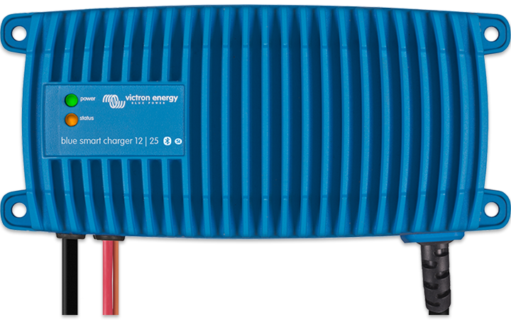

I have used two types of chargers, Minnkota precision chargers which are a lot like the NOCO chargers and the Victron IP 67 chargers. The Victron chargers are more money but are well worth the extra cost, and they are Bluetooth capable through the app, these chargers have pre installed charging profiles for all of the battery chemistries as well as user defined charging profiles, they have charge rates from 3A up to 25A.
