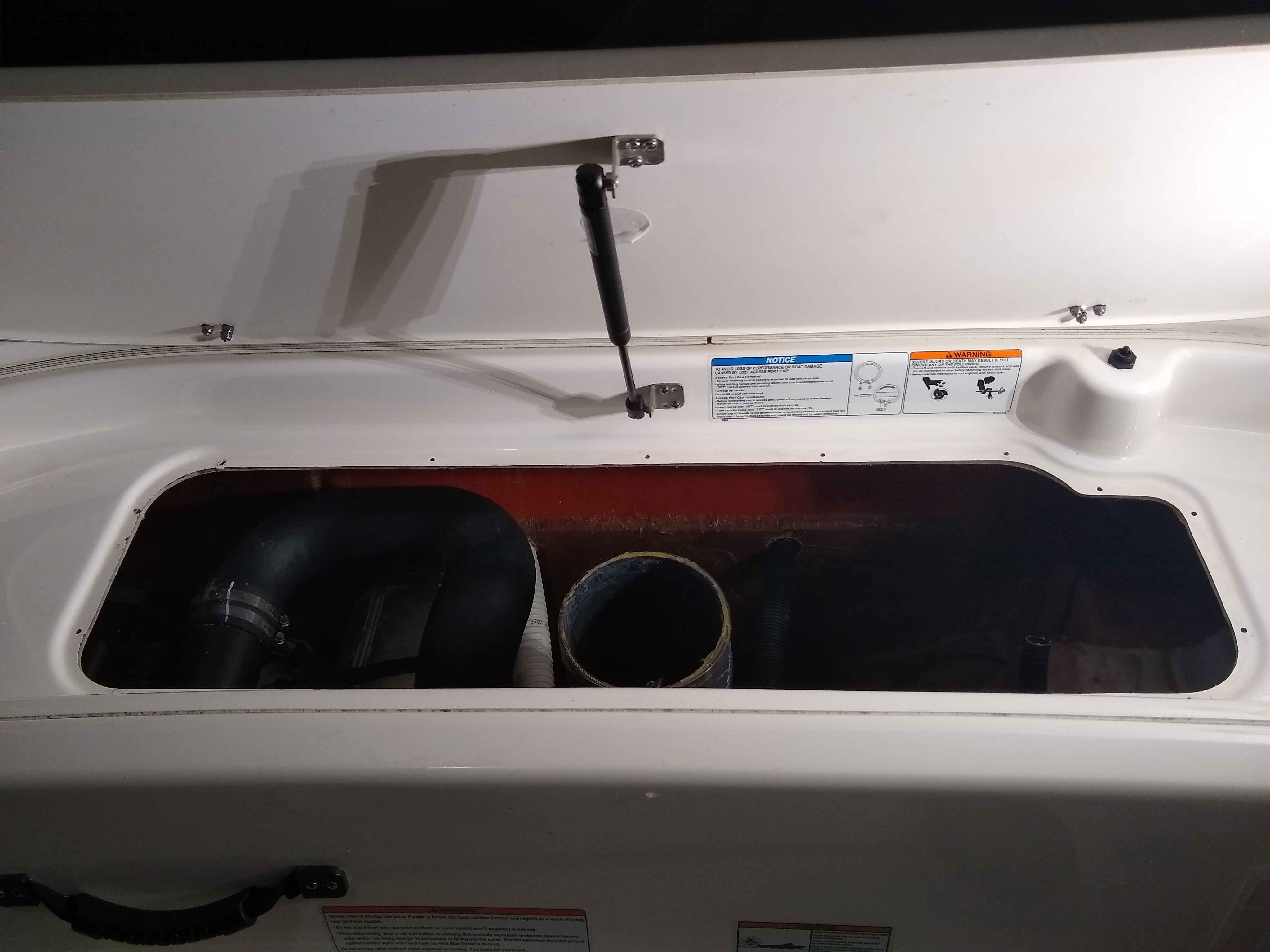

What do you mean by the hatch lid? The handle on the cap has 4 screws.

I think he means the cleanout tray cover.

Sorry for being so ignorant, had the boat 1 week. Cleanout tray cover? Photo?
The clean out hatch is this area. Unscrewing them and it should give you better access. The hatch was sealed so you will need to persuade it to come off. After reinstalling it you will likely need to seal it again. The screws in this area do have a tendency to strip the hole.
