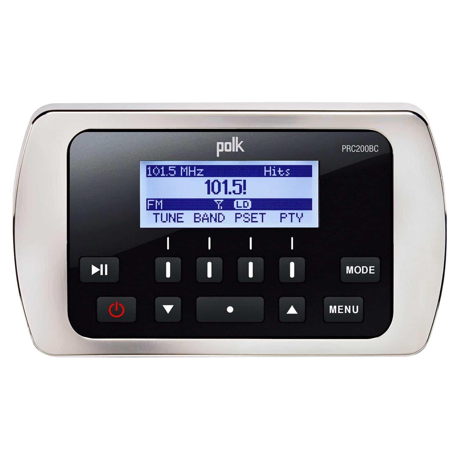

Did anyone ever confirm if the PRC200BC will work as a replacement remote for the PA4A commander?

I added in 2 extra remotes the MARC200 that are similar PRC200BC . I was able to do some basic controls but but I think the PA4A commander has controls for blue tooth embedded in the chip set. Putting that part in an area that gets submerged was some poor engineering
About the only thing I use my transom remote for is volume control and to skip songs. If those can do those 2 functions, that's good enough for me! Was the MARC200 plug n play after removing the commander?
I think it does a few other things but that's mainly what I use it for. My commander failed while it was under warranty so they sent an entire new system I took the remote and hooked it up in the garage and had the ability to use the volume to skip forward and back. you just need a y connector or you can plug it into the commander connection . I relocated my commander and covered it with a table bracket and have the second remote in the bow.
