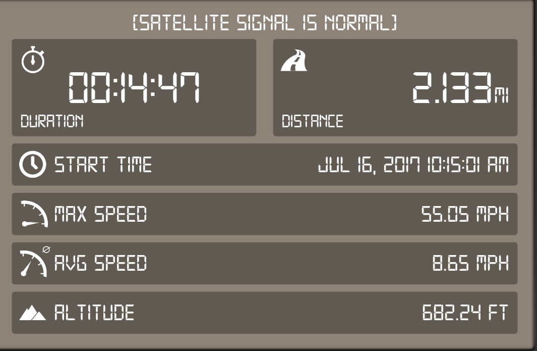

We got really beat up today in the rough water. The lake we go to is pretty narrow and the big boats cruise through at 20mph leaving huge wakes. I'm looking forward to Tuesday when the water will be smooth. I'm going to try a few GPS apps out that capture max speeds so I don't have to hold my phone and video at high speed. Always gets me a dirty look from the wife.
Here's a screenshot from today. 4 kids, 2 adults and gear. 2 kids in the bow which we know kills speed in these 19's. Trying to figure out how to size the pic.

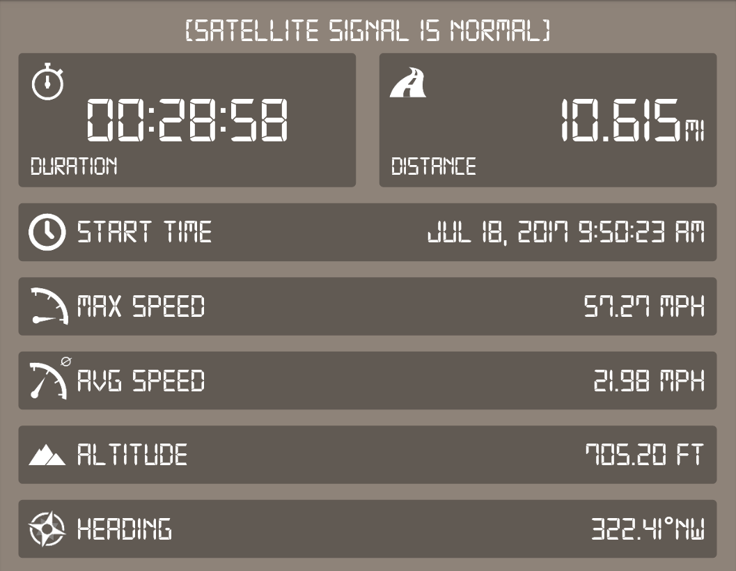

Finally some smooth water today. 3 kids and full fuel ran 57.27 mph. After my wife got in it would run 56.5 mph. I need a major step up with the impeller, it's hard to keep it off of the rev limiter. We did about a 4 mile run at 55 mph. AFR was 11.8-12.0 and the engine didn't seem any hotter than normal.
full
What's your feedback on the acceleration of the boat? Is it a rocket to 50mph or similar to stock but doesn't stop pulling?

I did a video 2 years ago when I first did the intercooler install. I went back and timed my 0-50 from that. Now it's 10 seconds faster to 50mph. It's hard to get a feel for it because it's hitting the rev limiter. I take off and start easing off of the throttle to keep it off the limiter, by then I'm over 50 mph.
I'll do some videos after I figure out what to do with the impeller.
