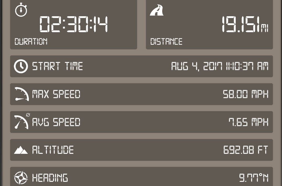

I would have been pissed if you where beside me wot when I had my old seadoo it did 58 on GPS too

Well the 3.5mm bend was too much. Ran 57 mph @ 8150 rpm. With everyone in the boat it was at 54-55 mph @ 7950-8050.
Hole shots are pretty lazy. Starts at 7200 rpm and slowly works up to speed. No cavitation though. Still a lot faster than stock.
