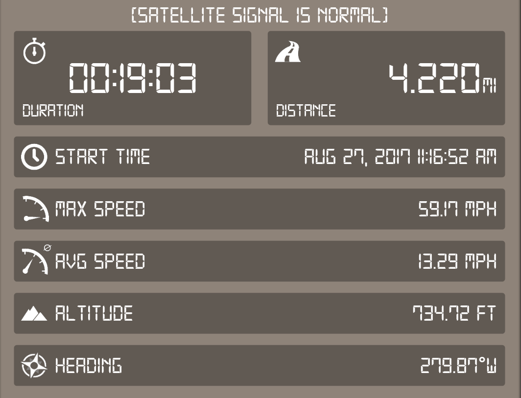

New top speed this morning. It was cloudy and 73 degrees with low humidity. 59.17 mph @ 8350 rpms.
This was with a full tank of fuel and 3 kids with me.

Damn that's good, basically a full 10mph over stock.
Amazing job @SamCF . Curious, about how much $ per Mph would you say you had to spend so far?

It's not just top speed, the whole power band is improved. It jumps up on plane effortlessly. I went around a slow boat today, the kids were in the bow, and I hit 56 mph in a few seconds. Huge difference in driveability. RPM at cruising speed is reduced, which makes a more smooth and quiet ride.
My go fast parts total is $2200. I purchased the ET Low Boost wheel, powershot and Lucky 13 cone used. This is not including the 160mm conversion, as it is not installed yet. There are also some tools that I had to buy to do the work that I'm not including in the cost. That is VERY cheap speed in the boat world.
